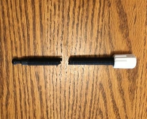

So I think this is likely a long shot, but I thought I'd give it a try anyway. I bought a headlight from an ebay seller and because of poor packaging the vertical center adjustment screw was snapped off. Gluing it back together just on the broken surface ends will not be strong enough, and of course no glue can get on the threads. I am considering a possible fix of drilling down the center of each piece maybe 3/8", and inserting a cut off piece of a stainless steel screw with epoxy to bridge the break and give it some strength.
Before going through that effort I'm checking here if anyone has a broken headlight that would be willing to part with this screw. The screw fits into a split nylon bracket inside the headlight. There is no need to take apart the headlight to remove it. There is enough give in the attaching bracket inside that when unscrewing the screw the little balled end will just pop out of the bracket while unscrewing it from the case.

I'll bet that piece has a metric thread! Can you measure its diameter (in millimeters, preferably)? Do you have a metric nut that threads onto the piece? It should be easy to make a replacement on a lathe, starting with a machine screw.

It's an M8 x 1.25 and is almost 4" long. Using a lathe to make one from a machine screw is certainly an option. I have a HF mini metal lathe and know how to use it, but my preference is to stick with the factory part if I can.

It may be difficult finding an M8 screw 4 inches long; I agree, finding the OEM part will be less labor intensive.

Give me a couple days. I have what you need, and will gladly mail it to you, but first give me the time to receive a "new" headlight assembly in the mail. If we are both lucky I will have your part mailed to you around the end of this month.

A very generous forum member privately shared with me that he is sending me a replacement adjusting bolt/screw. I very much appreciate his help. Many thanks!
