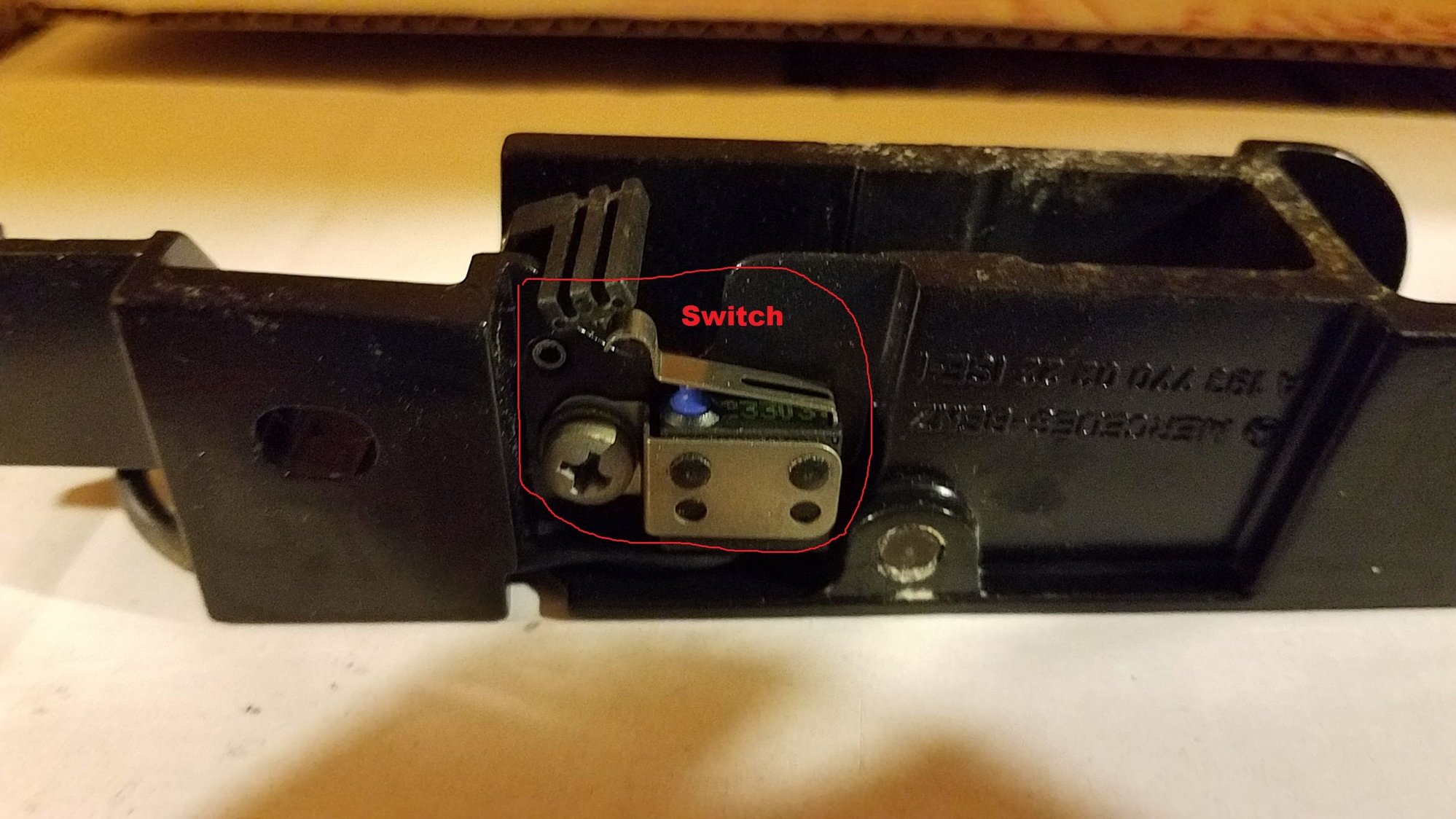

Is this what you are looking for? If so, PM me here with your phone # and when a good time to call.

That is the part number you posted

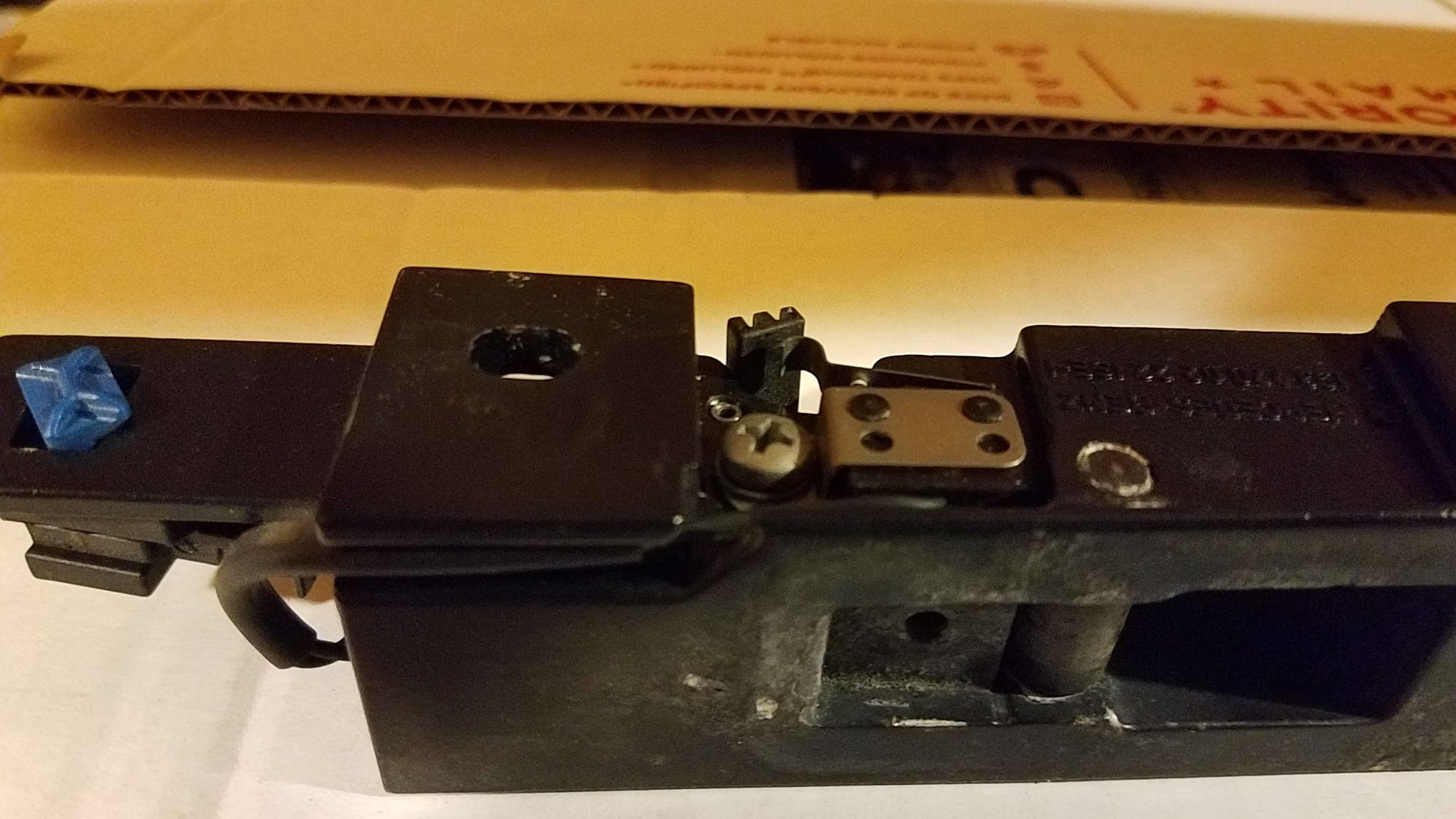

It looks like it is missing the switch??? How much do you want for it???

This is the switch. $40.00 shipped anywhere Lower 48. Canada $35 USD + shipping to Alberta. PM me your address and I'll get a quote.

That actual switch is probably still made, but without the little bracket.
Finding the exact switch in the manufacturer's parts pages - then finding a retail source for them is a nightmare - best to buy the one from Shamrock.
