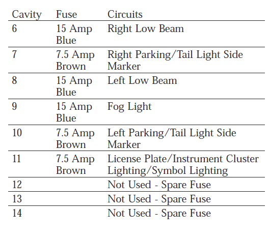

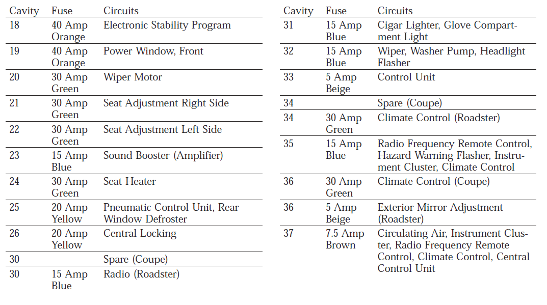

Can someone share with me a 2004 fuse box diagram? What I found from a owners manual doesn't match exactly what my car has. Some spots have the wrong size fuse and one spot that says it supposed to be a spare looks like it has connections inside it

from the 2004 service manual :
The 2004 owner's manual says :
