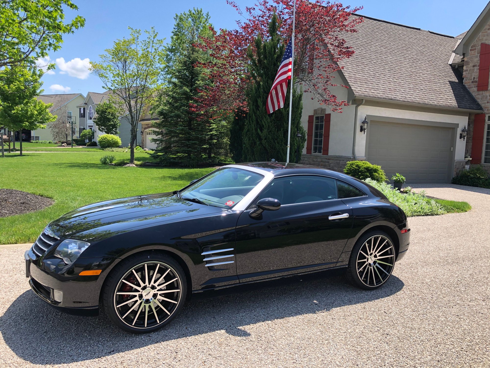

Put my new rims and tires on. TSW Rims, Pirelli PZero 235/35/19 front, 255/30/20 rears.

Very nice. How does it affect the ride & handling going +1?

Just drove it around my subdivision, taking it out on the highway this week. I will give you an update after I make some speed runs.
I replaced four G Force Sports, no traction and very loud.

Nice looking rims & stance. It will be interesting to see you feedback on ride & handling.

Really love that look. I wish they had made the car stock 19’ 20’ offset especially with the SRT6 wheels. I doubt we’ll ever have anyone make replicas for our cars that are up an inch, so something like what you have is what I’ll be on the hunt for. If you don’t mind me asking, what are the width of both wheels and are you running spacers? Also are you lowered at all or using any of the camber kits? Thank you in advance.

The fronts are 235/35/19 +33 offset 8.5"wide. The rears are 255/30/20 +25 offset 10"wide. No spacers or camber kits. I have not lowered the car although it sits a little lower in the front because of the V8.
