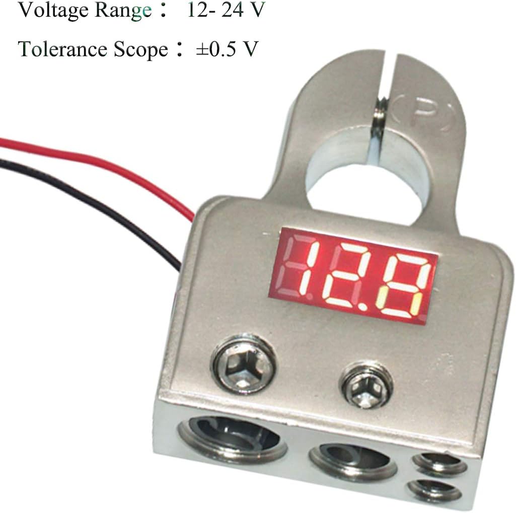

Amazon Amazon
Plus, I was hoping you'd go full-fancy and get a (+) terminal with a built-in voltage readout!
Amazon Amazon

But, but, but...didn't you get the set? The positive terminal will get lonely by itself. https://www.amazon.com/AUTOUTLET-Ter...82/ref=sr_1_21
Plus, I was hoping you'd go full-fancy and get a (+) terminal with a built-in voltage readout! https://www.amazon.com/dp/B0834PHXS5...pa_dk_detail_5
I bought a set but there is no room to use it on the negative and I like my pure brass terminal much more. I'll see what I can do with the other negative terminal.
