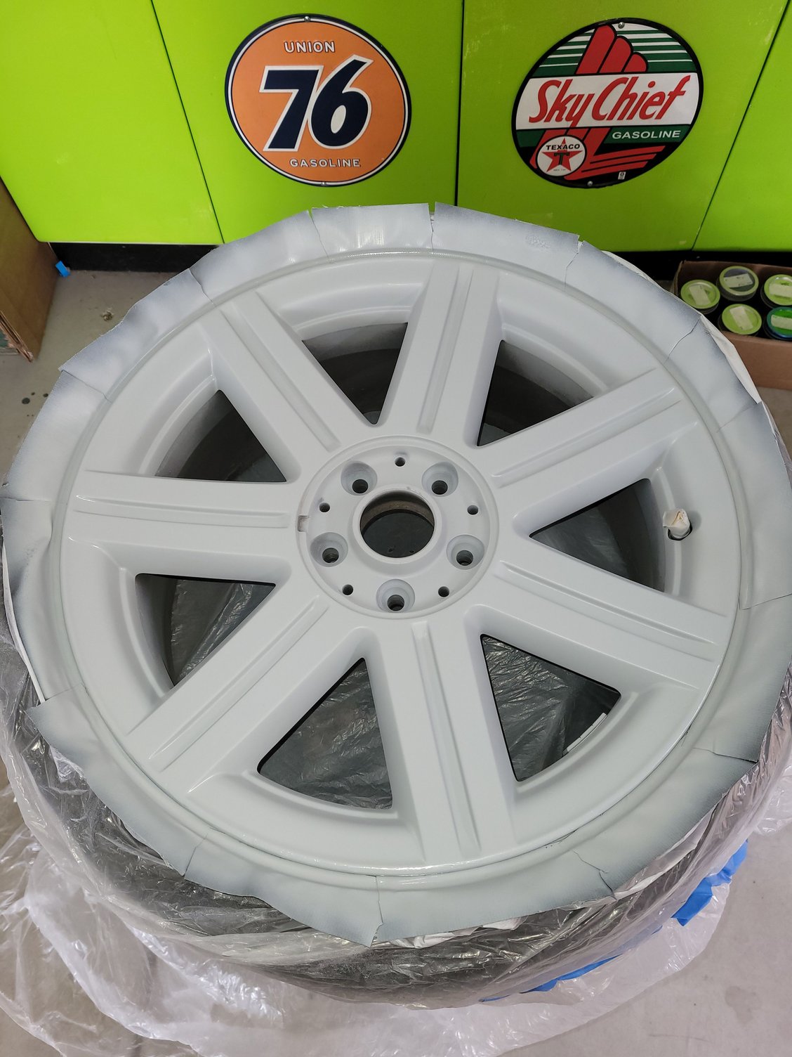

Fronts got recoated with Chrysler PAK-W Sparkle Silver
Sparkle silver
Clear coated
Mo betta
Clear coated
Mo betta
Nice!!! What 'prep' did you do before the spraying?

From: Aloha
Washed and degreased with scotchbrite.
Then sanded them till smooth, used some bondo on the marred areas and resanded down to 1200. Self etch primer two coats with touch up using glazing putty and light sanding. Prep-solv them of course for oils, 90% alcohol works too. then three coats of color and two clear.
Self etching primer after sanding baby smooth

Thanks for the details, they look GREAT!

[outstanding work , paint looks better than Factory 😎👍
QUOTE=CaughtInaXF;967650]Washed and degreased with scotchbrite.
Self etching primer after sanding baby smooth[/QUOTE]

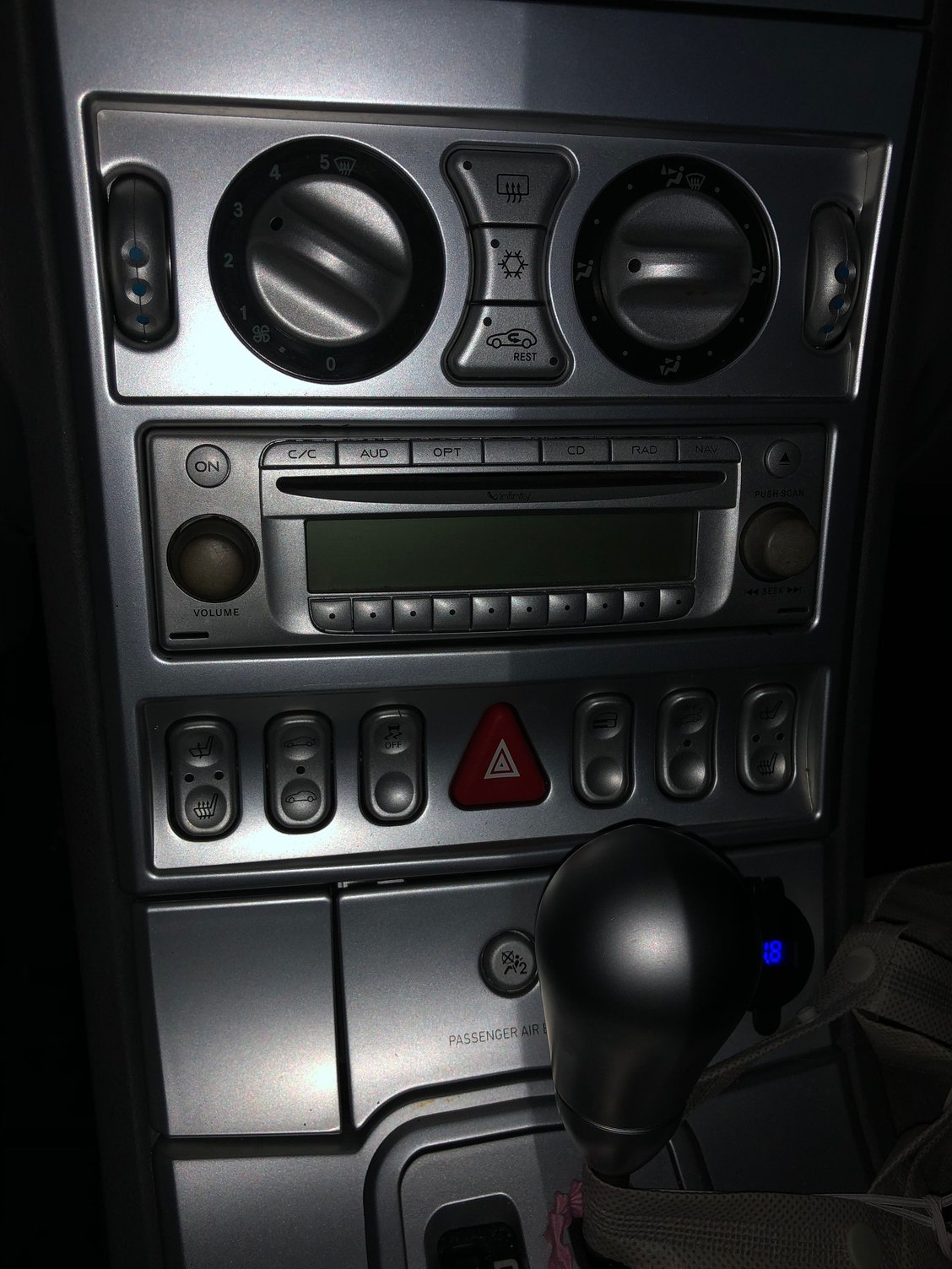

I replaced my cigarette lighter with USB… it even has a blue light that shows the voltage.
Where did you get it?
