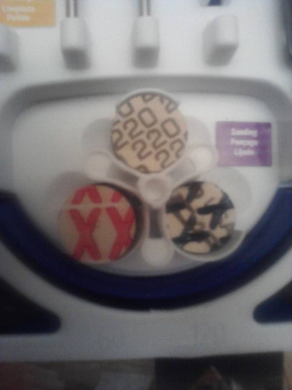

You guys are right, it is glass...so I can work it out...plan on doing it this weekend...so, I should use the finest discs I can find? What about the initial disc you used? Skip that? How do you mount your discs? I just have the part that goes in the Dremel...

This is the first sanding wheel I used. DO NOT USE THIS ONE - it scuffed the glass (but it also told me that the glass was penetrable)
This is the one I used, it took all the pits out but I had to be careful or it would scuff the glass...
I used the discs on the bottom right of these three, the dark blue X...
And the finishing touch, I used a combination of rubbing compound/headlight polish and steelwool pad. It was pretty tedious, I was watching TV and polishing during commercials for a couple of hours (I watch TV anyway so I made it productive time lol)
I have to say if I can do it anybody can do it...so geter done!
