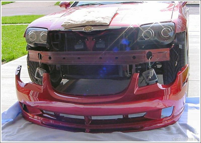

You have just the spoiler, or the complete bumper cover?

Hi James
I have the entire bumper cover. It is new for a SRT. It will have to be painted. It is in prime only.
Joe

Default Re: SRT spoiler conversion on a Limited
Everything will change over with no problems and no additional parts.

Thanks. I will keep the OEM limited cover in case someone wants to take it back. Thanks for the picture it confirmed that I liked the look. I have the same color as your car only it is roadster.

James about how long did it take to do the conversion?
Old Dec 24, 2013 | 05:05 PM
I've had my front bumper cover off a couple of times.
I'd give it 2 hours tops, with jacking up the front, using stands, and removing the front wheels - makes it much easier to access
the inner fender covers for removal.
