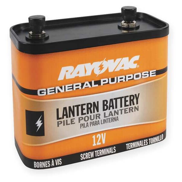

This has 12 volts too.. but I don't think it will start your car..

ok what should I do

Follow the advice given already? Not to mention this was confirmed by Advanced...
