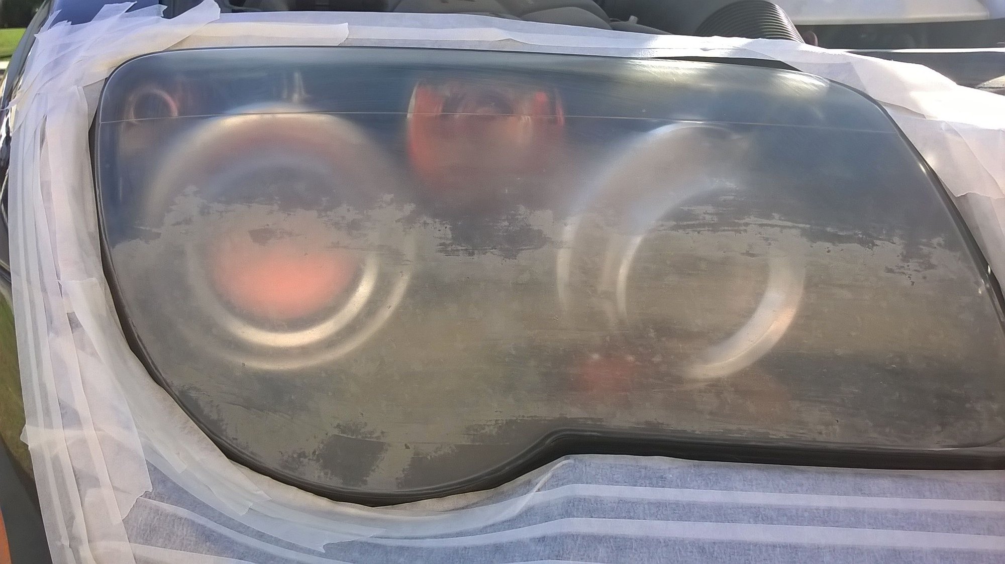

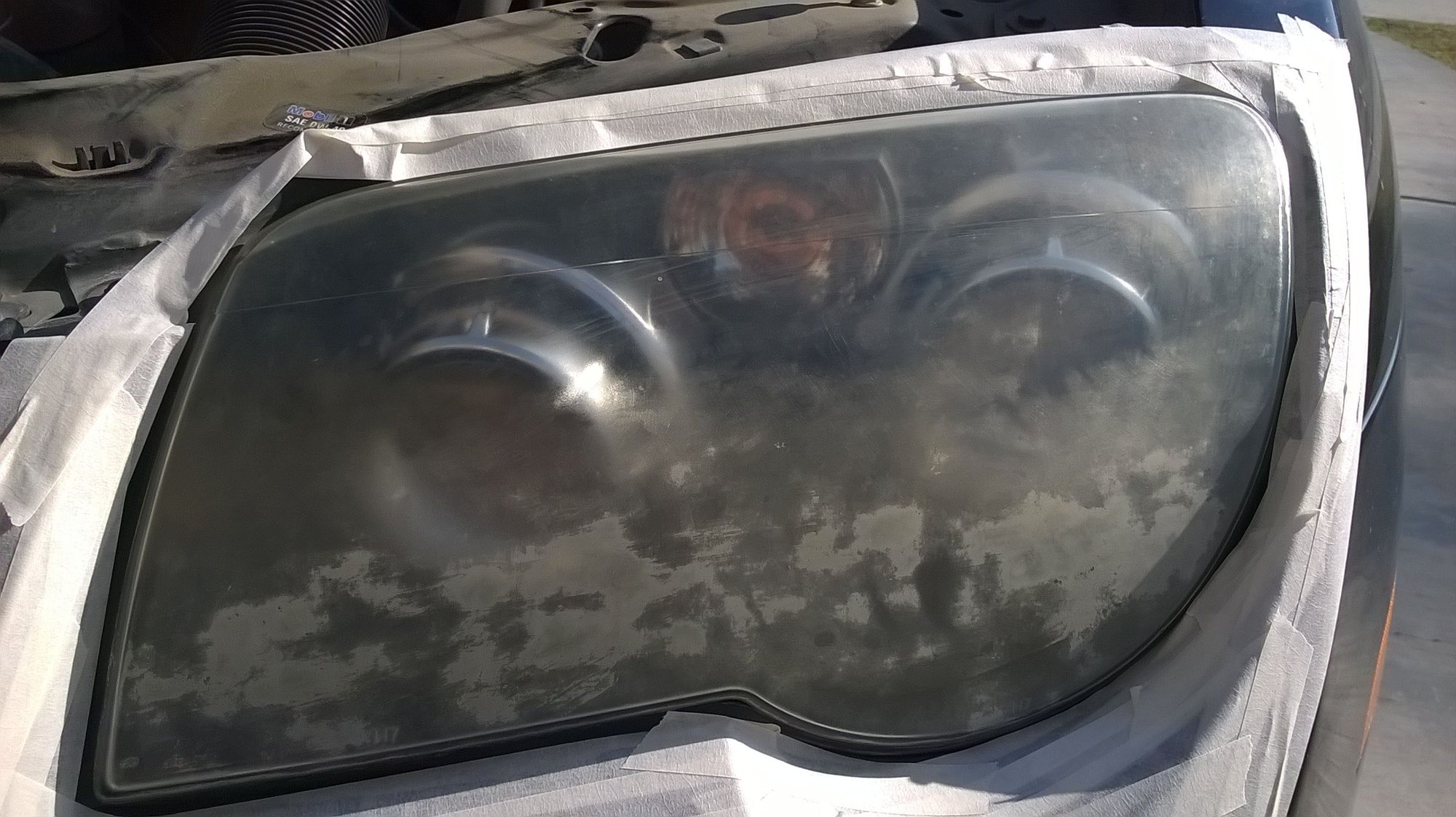

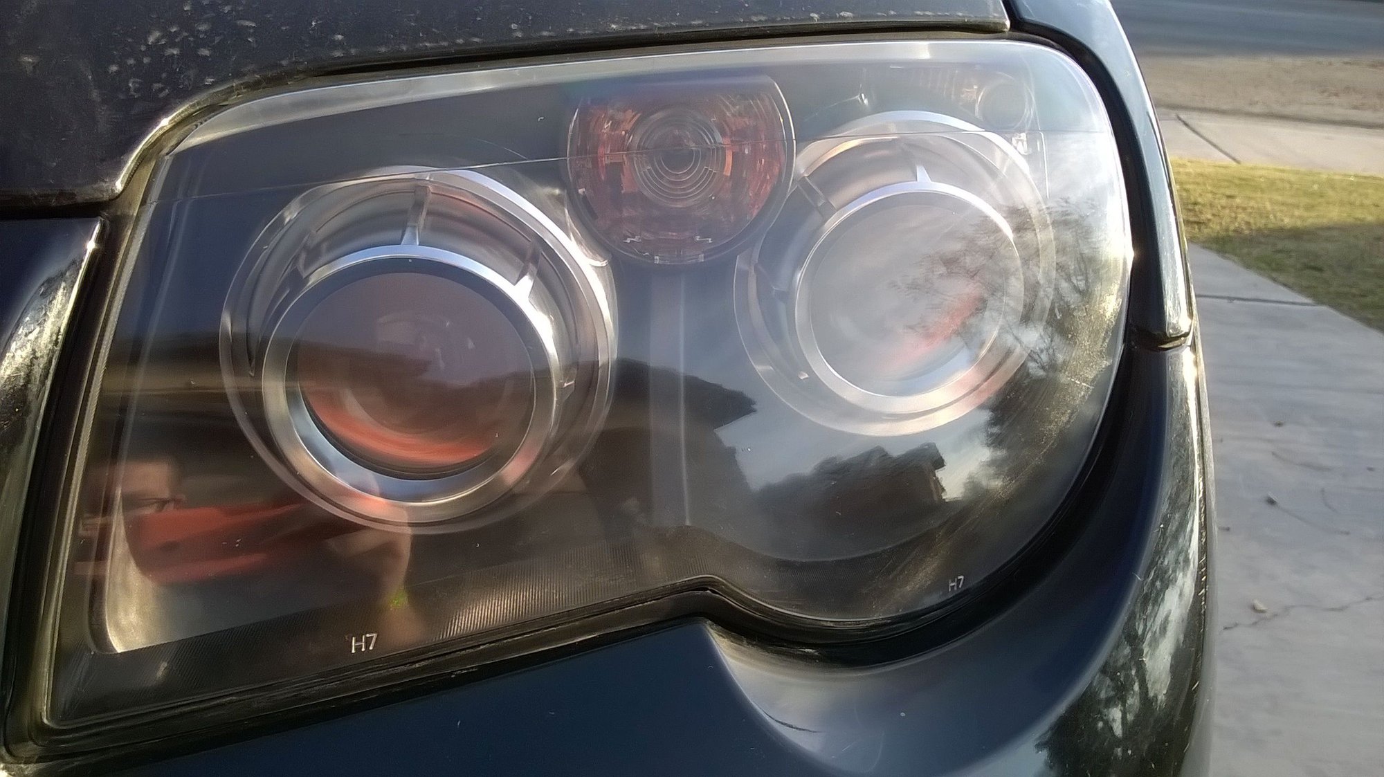

Next thing I did was the headlights. They were pretty foggy and corroded. I got the Meguires Heavy Duty headlight restore kit from Walmart for $23 and gave that a go. Took me about an hour and a half to do the pair. I was taking my time and not in any real hurry. I probably should have got a bit lower of a grit to start with since it took awhile to get that first uniform haze with the 1000 grit. I'll attach pictures at the end of the post.

Edit:Forgot to add pictures. Here are the two lights with nothing done to them and then after I got through with them. Don't be fooled. I haven't started sanding them in the first two pics. They were just really bad. I'm hoping driving at night will be a bit more enjoyable now.
