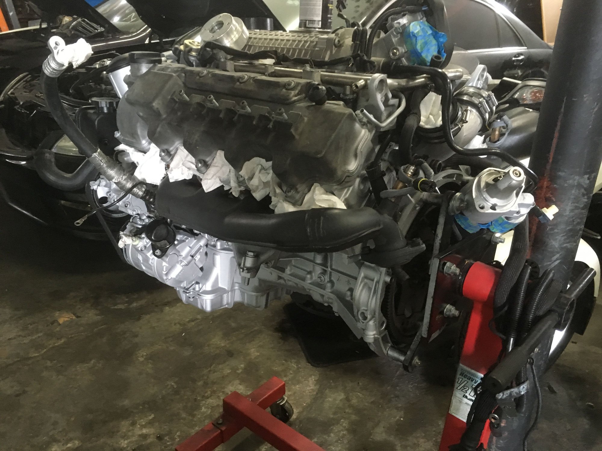

engine out
new seals gaskets and 1/2 painted
i removed the engine and tranny to do some mods,,paint,gaskets and seals and exhaust

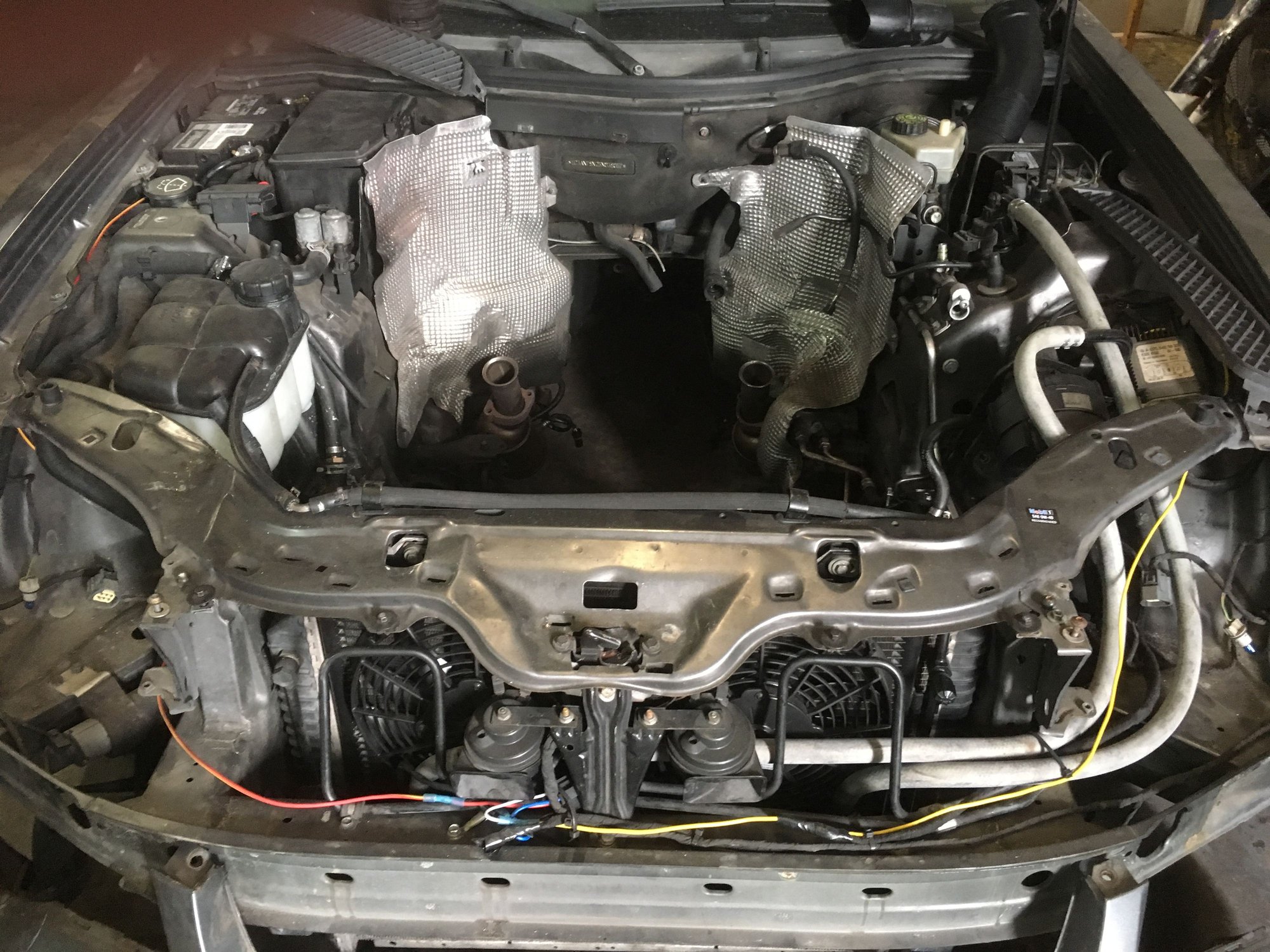

cut!!!! removed the upper radiator support,,, lowered and moved forward the lower radiator support

in the last few days we dropped the engine in 4 times did some modifying to lower the engine and tie it down,. the front is almost ready to install
wow side ways hood mount!!! LOL

Hay Les, just fixing the car ,,lowering and moving forward the lower radiator support, for extra cooling ,,,and making the upper support ,,so i can change pulleys and radiator faster , you know with the v8 the engine is more forward so need to fix that, re balance the car, add brakes ect.. when i get through the car will be a 10 second daily driver LOL How is your car doing,,, i know you had it rough after the storm. lets go to the track!!! jim

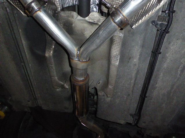

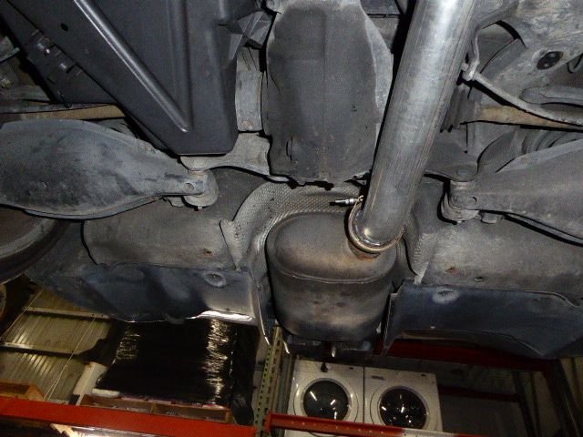

Engine back in,,, front end done,, see the fuel regulator
two 2.5 into 3" muffler
3" into srt 6 muffler

Default Re: V8, keep up with my mods
Is that a washer and dryer you have attached to the muffler? Just saying.
Thanks, Ken
Old May 16, 2019 | 09:19 AM
Posts: 6,723
Likes: 463
Yes it is, this way i never have to wash the car,, when i turn the key off the washer starts,,

Can you tell me how you have got your electric fans wired in?
Old May 28, 2019 | 03:13 PM
Posts: 6,723
Likes: 463
I have a fan from a C something i think it was a 300 and trimmed down to make it fit and hooked up- stock so far it has not run full blast and it was 89 yesterday, 1 needle width past 1/2 way is as high as it goes, stock thermostat.

my exhaust is 2.5 off engine to the Y then 3" to a 3"resonator/open muffler inline then 3" into the srt6 muffler (((opened the muffler to 3" inlet and two 2- 2 1/2 outlets))

Thanks for the info on your fan, but I actually meant the 2 electric fans you have in front of your rad.
Old May 29, 2019 | 08:53 AM
Posts: 6,723
Likes: 463
that ks what i was telling you about i just forgot to say that the two fans were removed and i replaced them with one big with more cfm ,,from the mercedes C class and had to mod it so it would fit.
