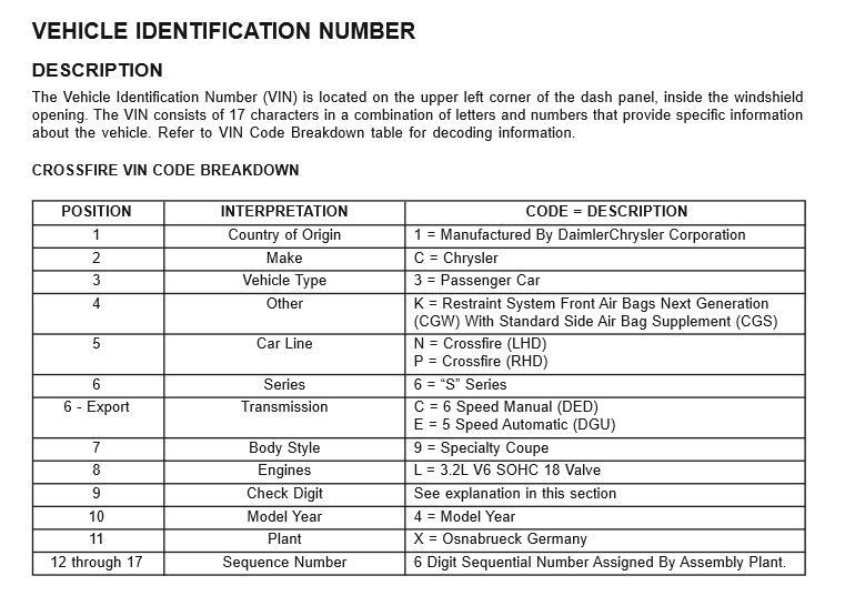

Attached are VIN Decodings from 2004 & 2005 Crossfire Service Manuals. Later model years had even some additional decodings for the VIN.
2004 Service Manual
2005 Service Manual
