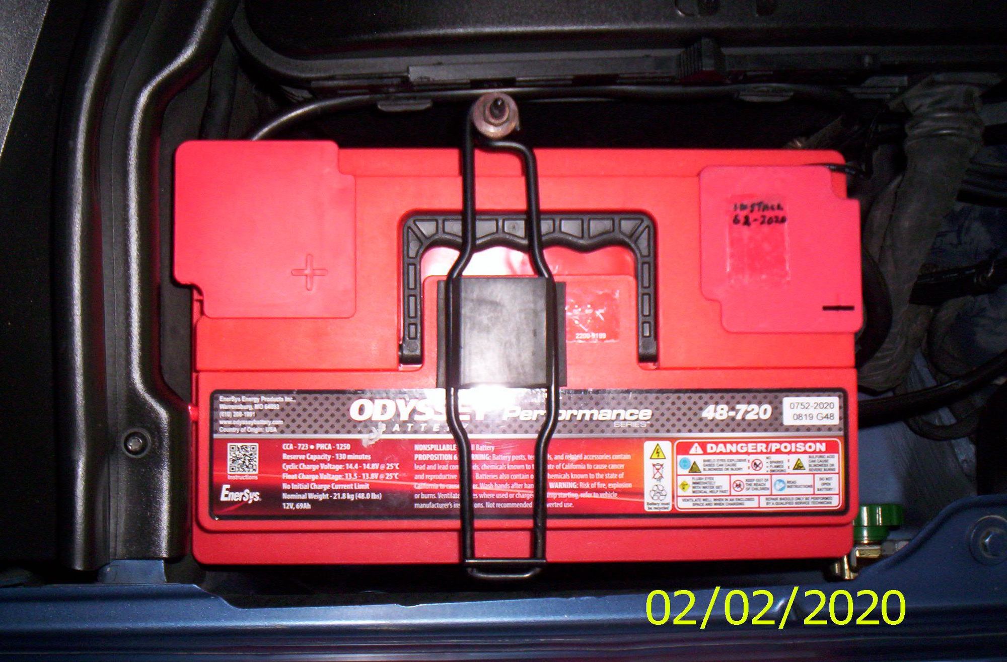

Last Fall the 10 Years old Canadian Tire Battery showed for the first time it was time to change it. ( Spoiler went up by itself . . . SRT6 do not have this Battery warning feature :-) )
Each time I had to put the car away for Winter( NOV to MAY ) , i disconnected the negative post before connecting the Optimate 6 Charger to it ,simply because some charger detect when the car electronic is still connected to the Battery and will not perform battery recondition with the same efficacity .

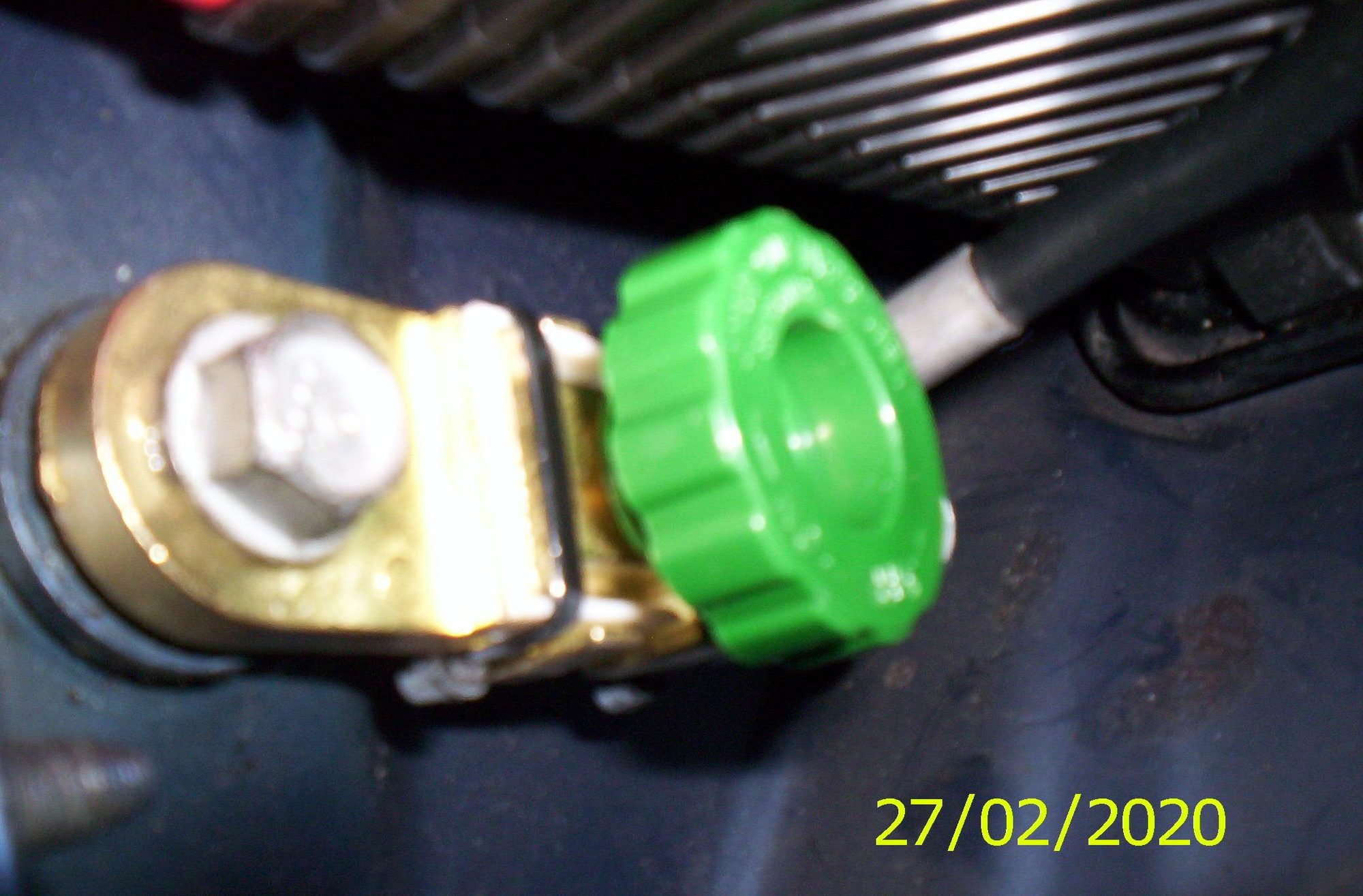

Two days ago ,I have installed a brand new Odyssey Performance Battery . . . https://www.odysseybattery.com/Batteries/Model_48720
I have also installed this Battery Cut off between the bolt of the right fender and the Negative wire . . . https://www.banggood.com/Vihicle-Cut...r_warehouse=CN
Now , all their is to do to disconnect the negative is turning that small Green Handle .

Just like ZIP439 mentioned , the material between the two brass part of this side post " battery cut off " seems to be made out of teflon . It will act like using a Nylock nut on a bolt .
Anyway . . . I already have intended to use LOCTITE® 222 on the thread as an added safety measure . It is a low-strength threadlocker that is ideal for low-strength metals like brass .
When the green handle it unscrewed for a turn or more and the charger is connected to the Battery , their is no way to get any spark at all .

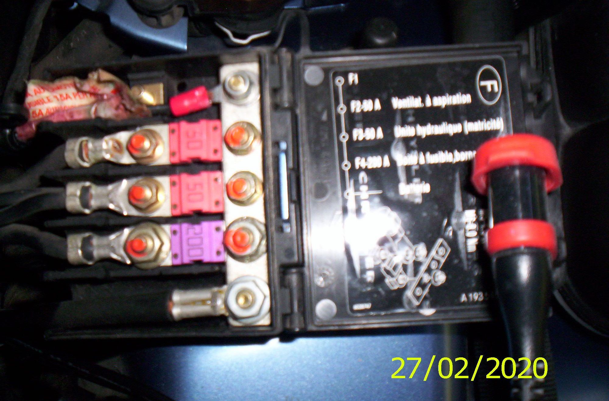

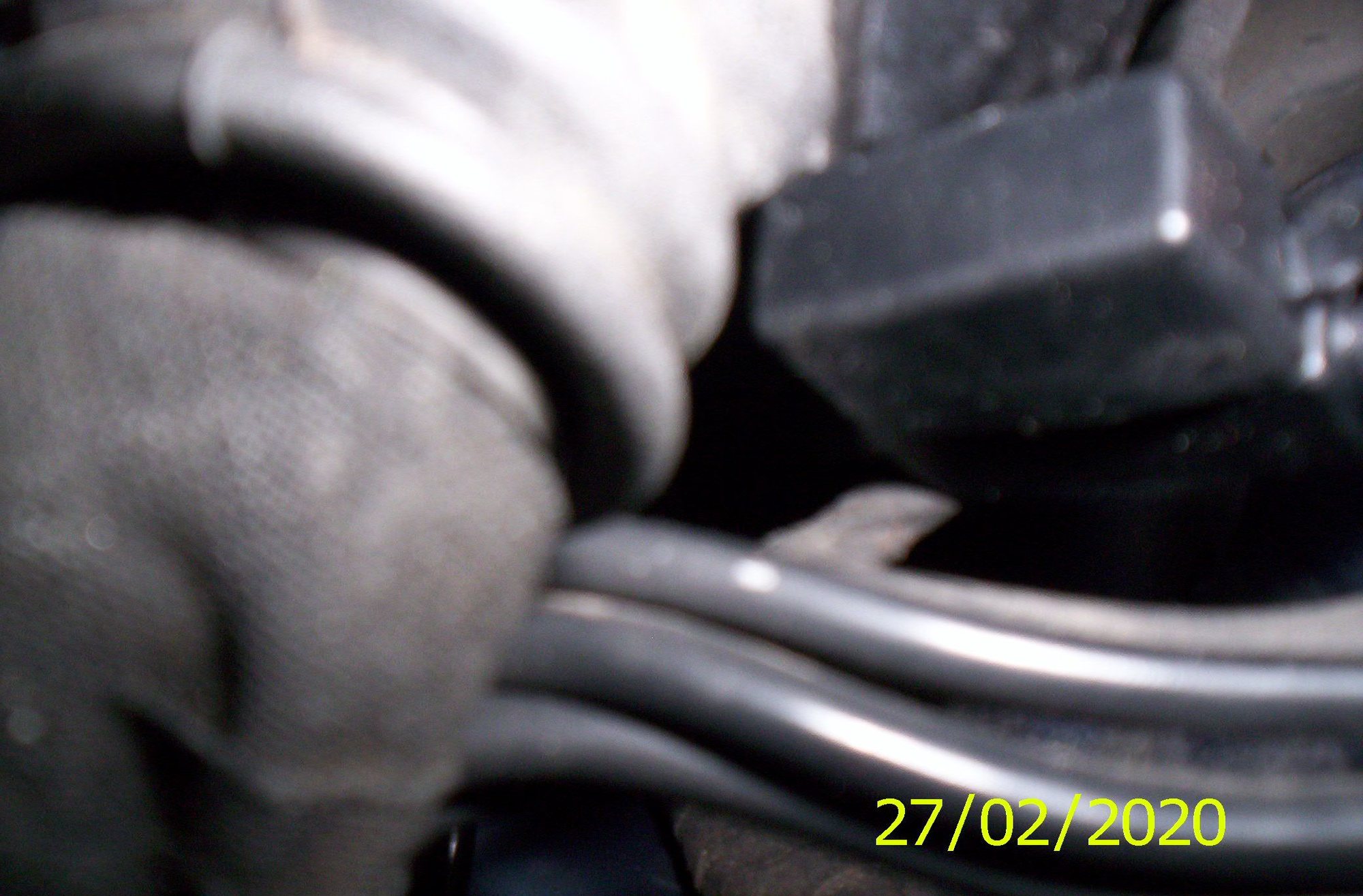

Battery in place with vent hose on the right side . . . following , is more details on the installation of the Battery " Cut-Off " , Battery charger that I have been using since Winter 2012 and is direct hook up on the Battery at all time . . . https://tecmate.com/fr/products/optimate6a/

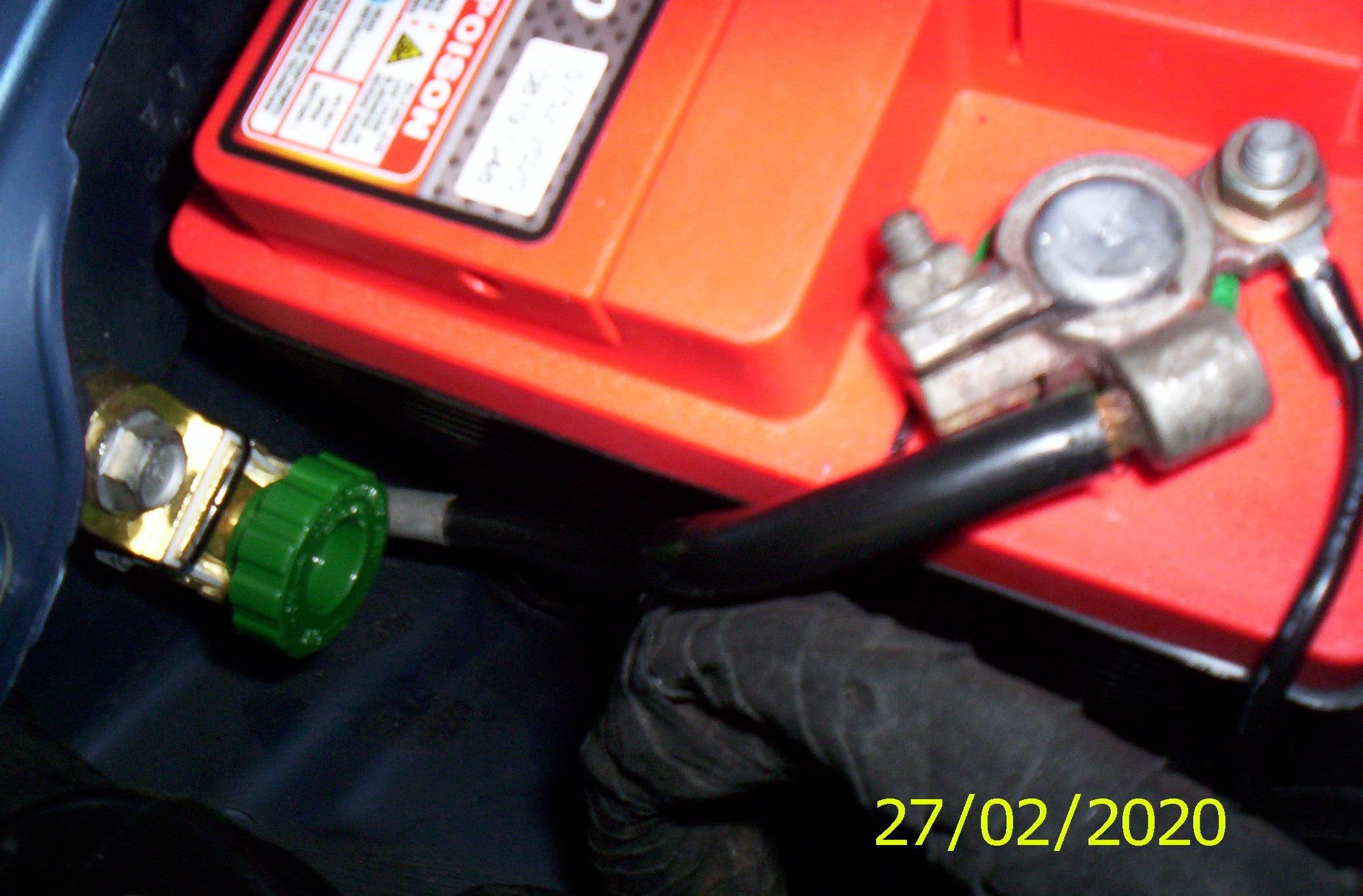

Battery connected with original ground wire to Cut Off , vertically install on right fender and bolted on original location off ground cable on right fender .
Since Cut Off is vertically install , added two small tie wrap to keep both parts of Cut Off together to eliminate spark to the minimum when green handle is screwed or unscrewed .
For the connection of the Optimate 6 to the Battery , the permanent connection was used instead of the alligator clips . Negative side of the connection bolted on the small lug on the original negative battery terminal .
" F1 " terminal in this junction box was used to connect the positive side of the permanent connection .
Fuse on the positive wire of the permanent connection sit on the left side of the junction box .
The first real use of the battery Cut-Off was this Spring in March . It was the first time this new Odyssey Battery was also connected to the car electronics . . . I noticed that the amount spark when I screwed the green handle of the Battery cut-off was almost non existent to the point that I had to go inside of the car to check if power was back on . I am very satisfied with the result of this simple modification . I will also check , once and a while , on the green handle tightness . Will report here if it come loose . . . but I do trust that the low strength Loctite will prevent this .
