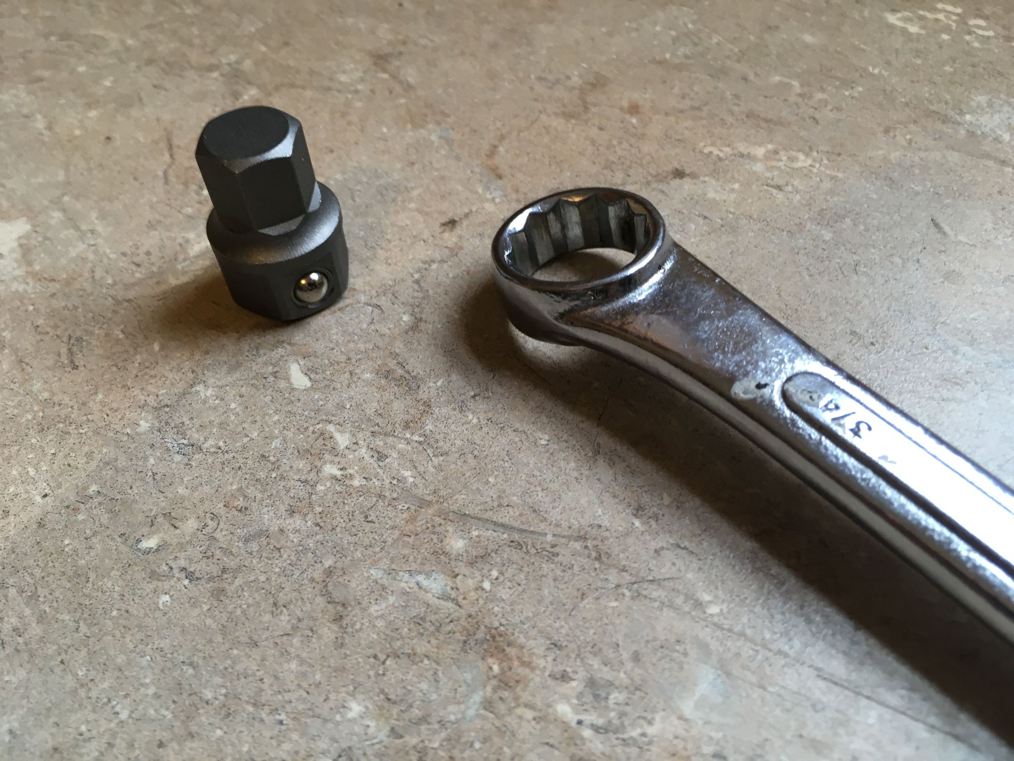

Tool for fill plug manual transmission: Here's a link for ebay this tool fits in your 3/4" box end wrench to remove the fill plug on our manual transmission
https://www.ebay.com/itm/CTA-Jeep-6-...72.m2749.l2649
snaps in snaps out

I pulled out a metric nuts and bolts our of my drawers that where the right size, and welded the nutts on so I just used a metric wrench.
Me too , for rear end -- maybe the same hex for trans ?

For the rear end and the manual tranny you'll need 14 mm and 17 mm. That's a great idea using the bolt heads
