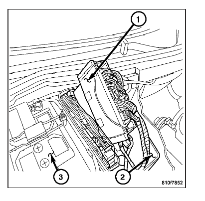

Hey guys im looking for this part SOS Diagnostics requires the ECM, and SKREEM module for programming keys.
I cant find an engine computer in the service manual.
Can you guys help me find some instructions on where and how to remove it?
this is the pic of the ECM they sent me

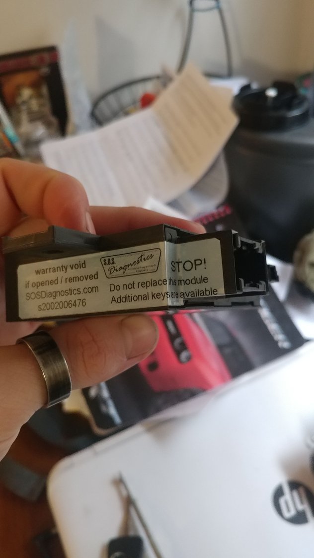

Update - My copy of the service manual has the ECM listed as the POWERTRAIN CONTROL MODULE
Going to pick up the keys and install tonight or tomorrow. this is the stock photo of the key they sent me
they also put these nifty "void if tampered with" warranty stickers on SKREEM and PCM. Looks like reputable work. And the key is perfecto.

ECM is easy:
Raise hood, go to driver's side, remove cover from large box next to battery.
In there, you will find the RCM, BCM and ECM.
The SKREEM is not easy:
The SKREEM is behind the speedometer.

ECM is easy:
Ok is there any kind of like diagram or labeling?
i gotta take these parts 30 mins away id rather not bring the wrong parts.

Sound like a total noob here. I dont know anything about vehicle electronics though so...
The box on the right is the ECM then? Engine computer? This is called powertrain control module in manual, no?
Old Feb 11, 2020 | 12:10 AM
Default Re: What part is this? ECM?
It is the center module :

😂 got it done y'all... Now to see how long these keys will take
