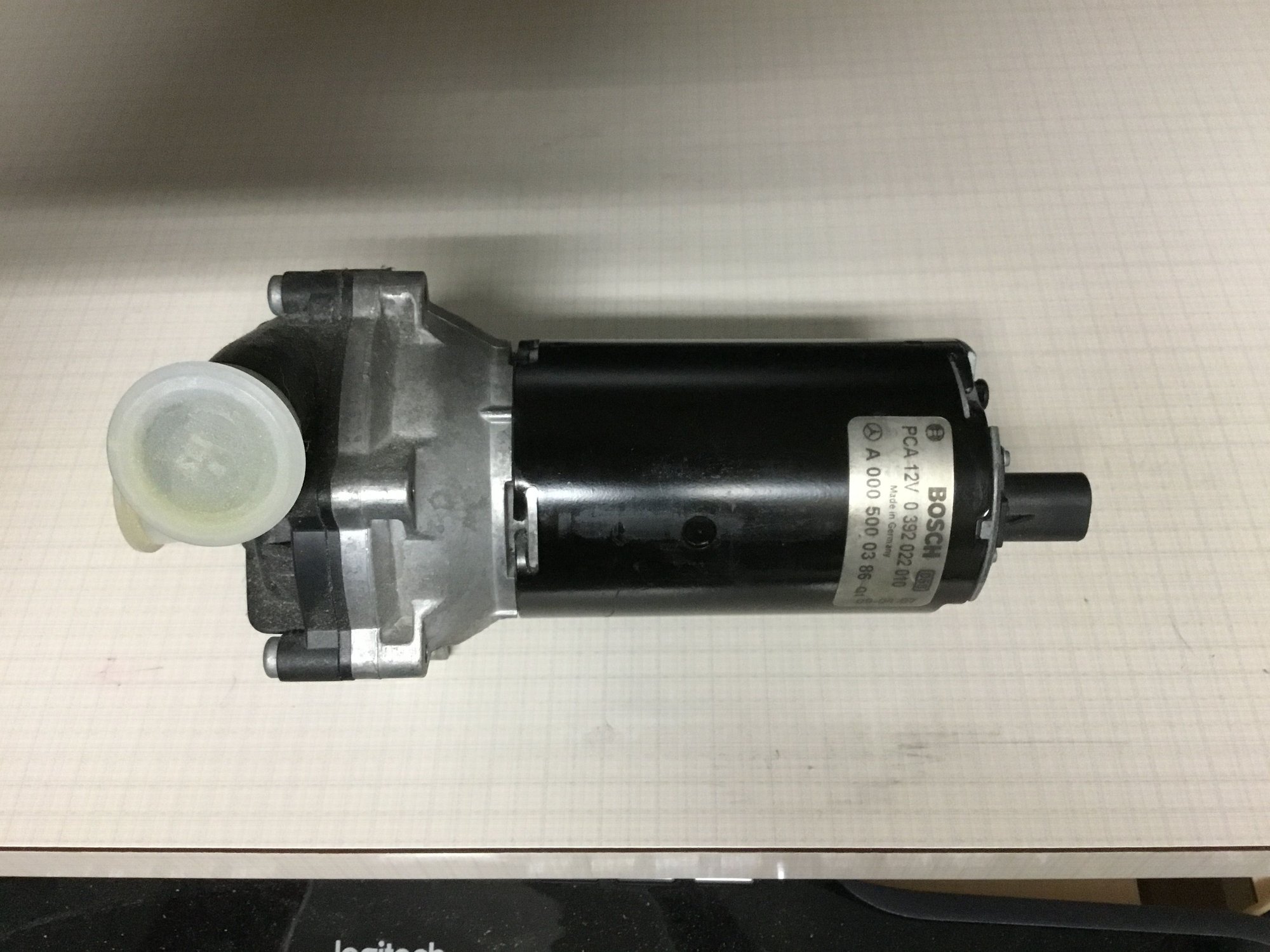

ok where would the part number be located on the pump

As shown below. The new pump #0392022010 is shown, the old pump which often failed is #0392022002.
Do NOT buy from a Mercedes dealer or use the Mercedes part number as it will cost much more.
