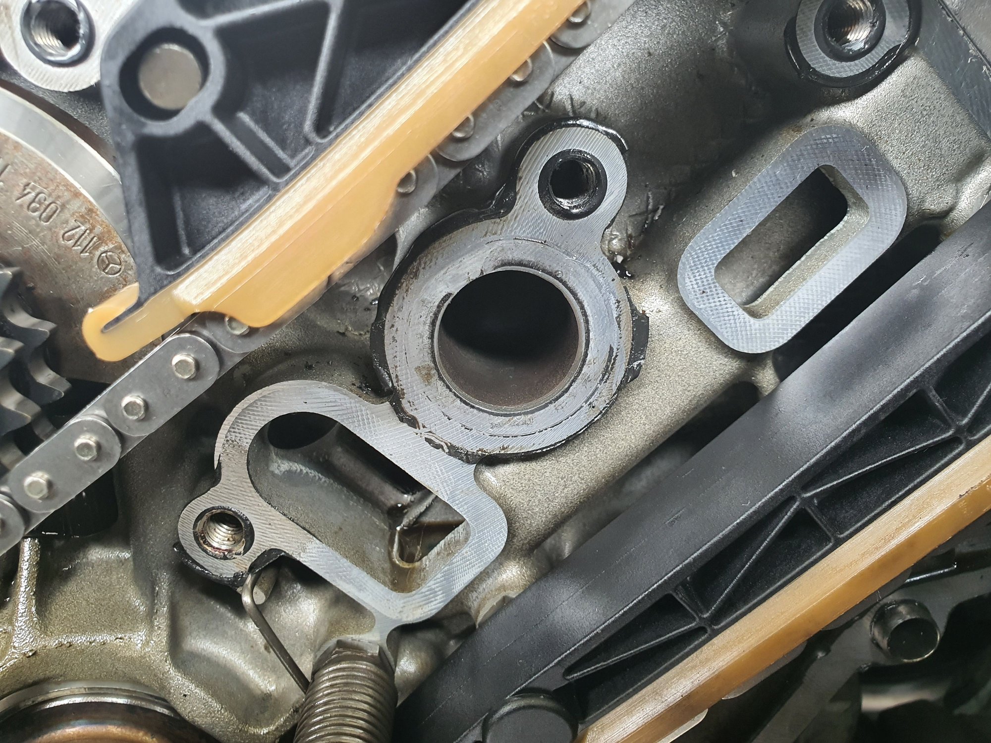

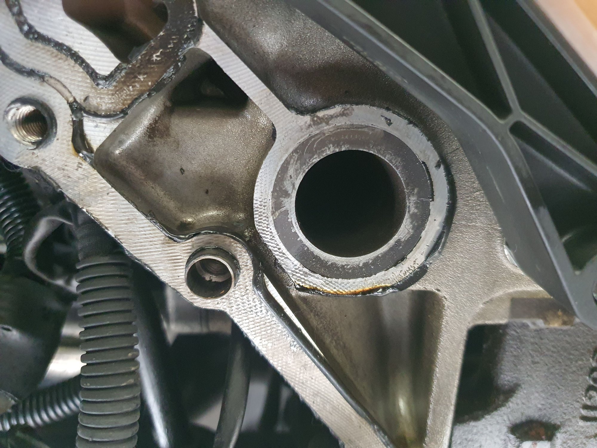

Hello,
Is here anyone who found missing rubber seal at timing chain cover?
I found one missing of two seals, so I installed new two seals.
It might had been happen at factory stage.
1.
2.
3.
4.
5.
Picture 4 & 5 are engine side which the seals attached.
Pic.5 is missing point and the color is different from Pic.4.
Missing seal -> coolant leak -> overheat -> cylinder head deformation -> high pressure at coolant line -> more coolant leak
I repaired cylinder head.
I think the beginning was this seal.
