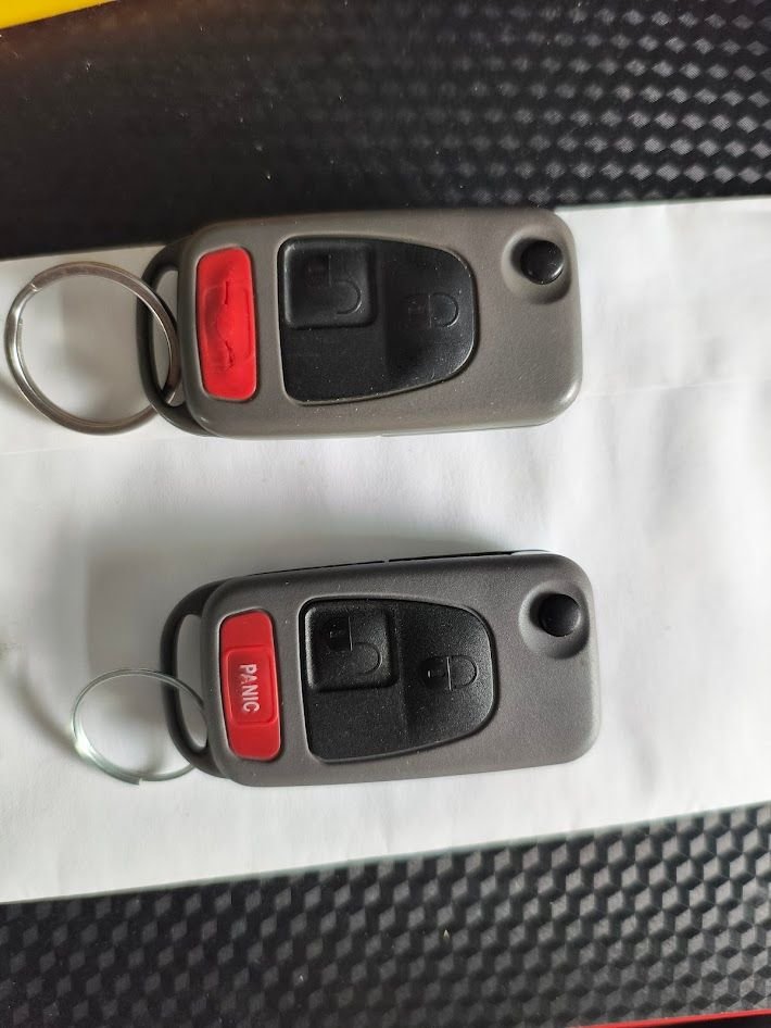

Old Jun 25, 2024 | 01:50 PM
bossman4's Avatar
Joined: Jan 2004
Posts: 81
Likes: 23
From: Michigan
Default Re: Key Fob
A slight hijack of the thread. I just picked up a base 2006 roadster with low miles. It has 2 key fobs and both keys will start the car, but only one key will lock/unlock the door and run the flashers. I replaced the batteries, thinking that may help, but it did not help the key fob that looks more worn.
It does not sound like as big of a problem that some folks are experiencing with their keys, but it is annoying.
Does this require the "send in" and "$250 a key" solution?
Thanks in advance!

Have you tried the procedure to resync the FOB?
Old Jun 25, 2024 | 04:00 PM
richb55's Avatar
Joined: Nov 2019
Posts: 147
From: Boston
Default Re: Key Fob
yes I was going to say similar “pairing” the key
Somebody on here will know the procedure 👍
Old Jun 25, 2024 | 04:01 PM
Posts: 6,647
Likes: 777
Default Re: Key Fob
One method.
To synchronize the key fob transmitter
This may be required after replacing the batteries or when receiving a replacement fob.
Directions as stated in the Owner Manual.
 Aim the transmitters red eye at the vehicle.
 Briefly press the lock or unlock button twice.
 Within 30 seconds, insert the key in the ignition.
 Turn the key to the ON/Run position.
The remote control function should again be operational.
Second method
PROCEDURE
Transmitter programming by the customer is done by performing the following steps: Insert the key into the ignition switch.
1. Press either the lock or unlock button momentarily twice.
2. Turn the key in the ignition switch to the ON/RUN position within 30 seconds.
Old Jun 25, 2024 | 08:58 PM
bossman4's Avatar
Joined: Jan 2004
Posts: 81
Likes: 23
From: Michigan
Default Re: Key Fob
Tried procedure 1 and 2 several times with the inoperable remote. IR transmitter in the inoperable key not functioning?

Old Jun 25, 2024 | 10:30 PM
bossman4's Avatar
Joined: Jan 2004
Posts: 81
Likes: 23
From: Michigan
Default Re: Key Fob
Followed speed shop recommendations.(you tube video)
Turned out that I mixed up the new and old batteries during my escapade with one of these newer child proof battery packages. %$#$$###
At least I did not cut my finger off.
Thanks for all the help!
