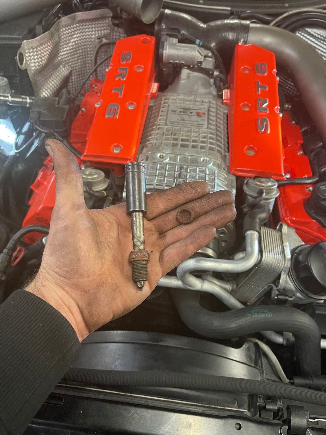

This is what victory looks like. My brain was already going through the process of pulling the head. Got lucky. Put anti seize on them. Hopefully never run into that again. Lol.

That's why it's always a good decision to change plugs even with low mileage. It's the age of the plug and how long they've been in there 14-18 years is a long time
