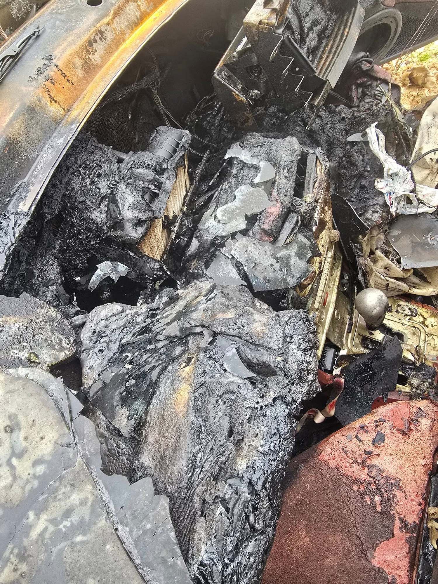

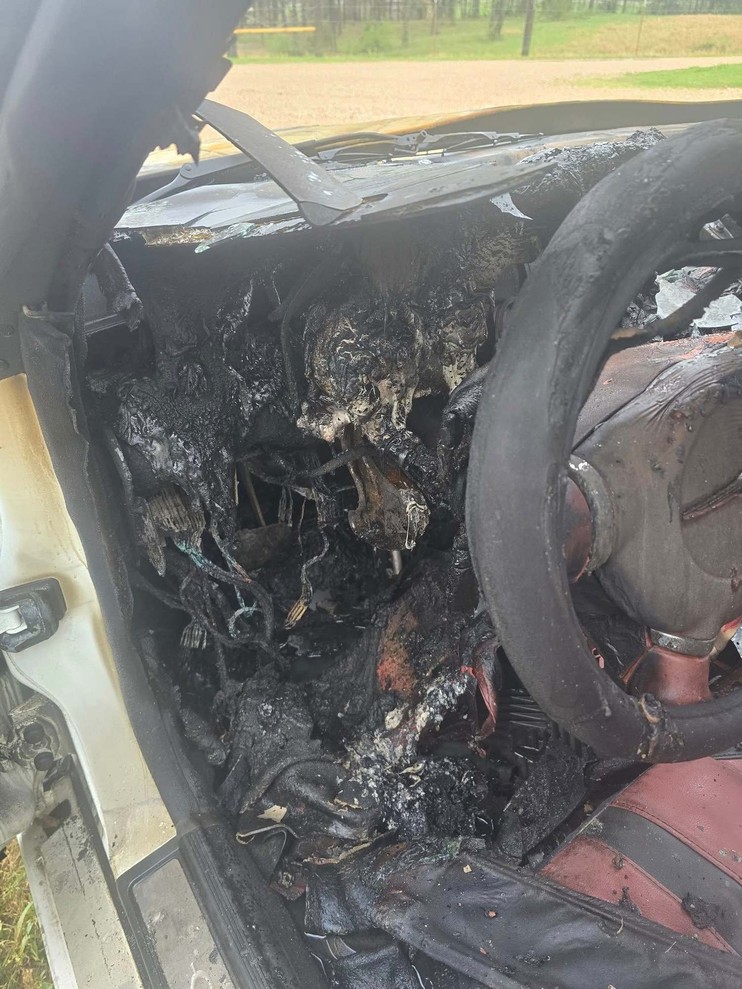

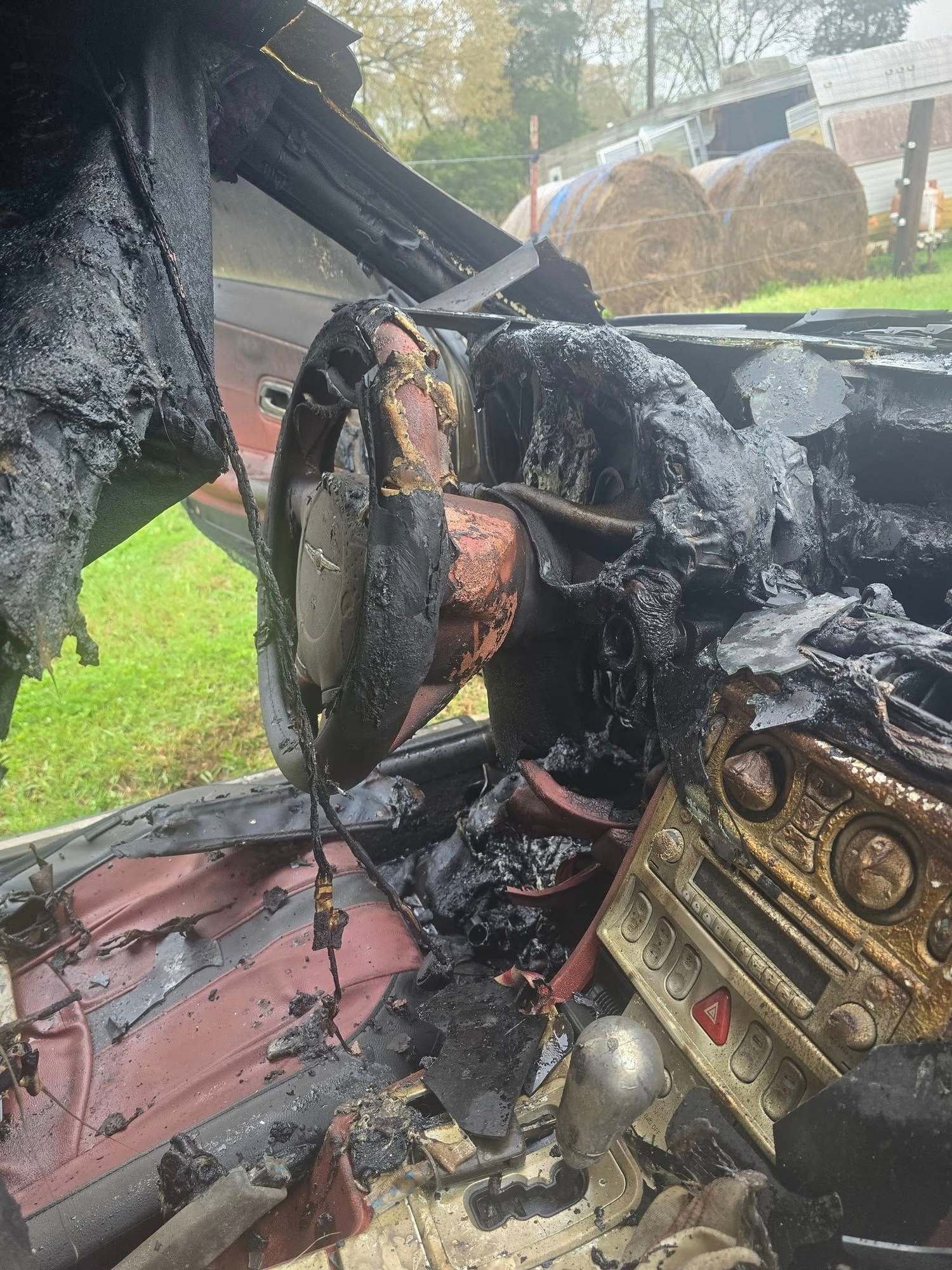

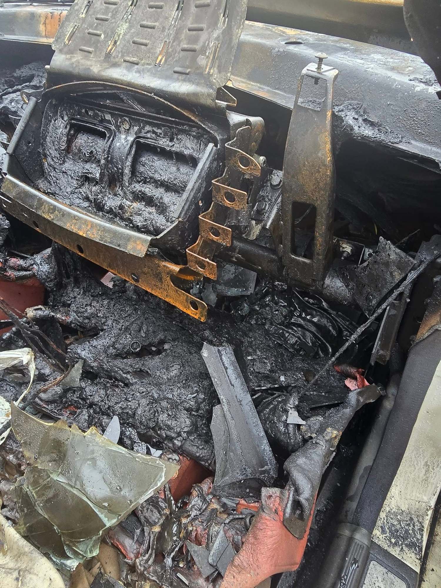

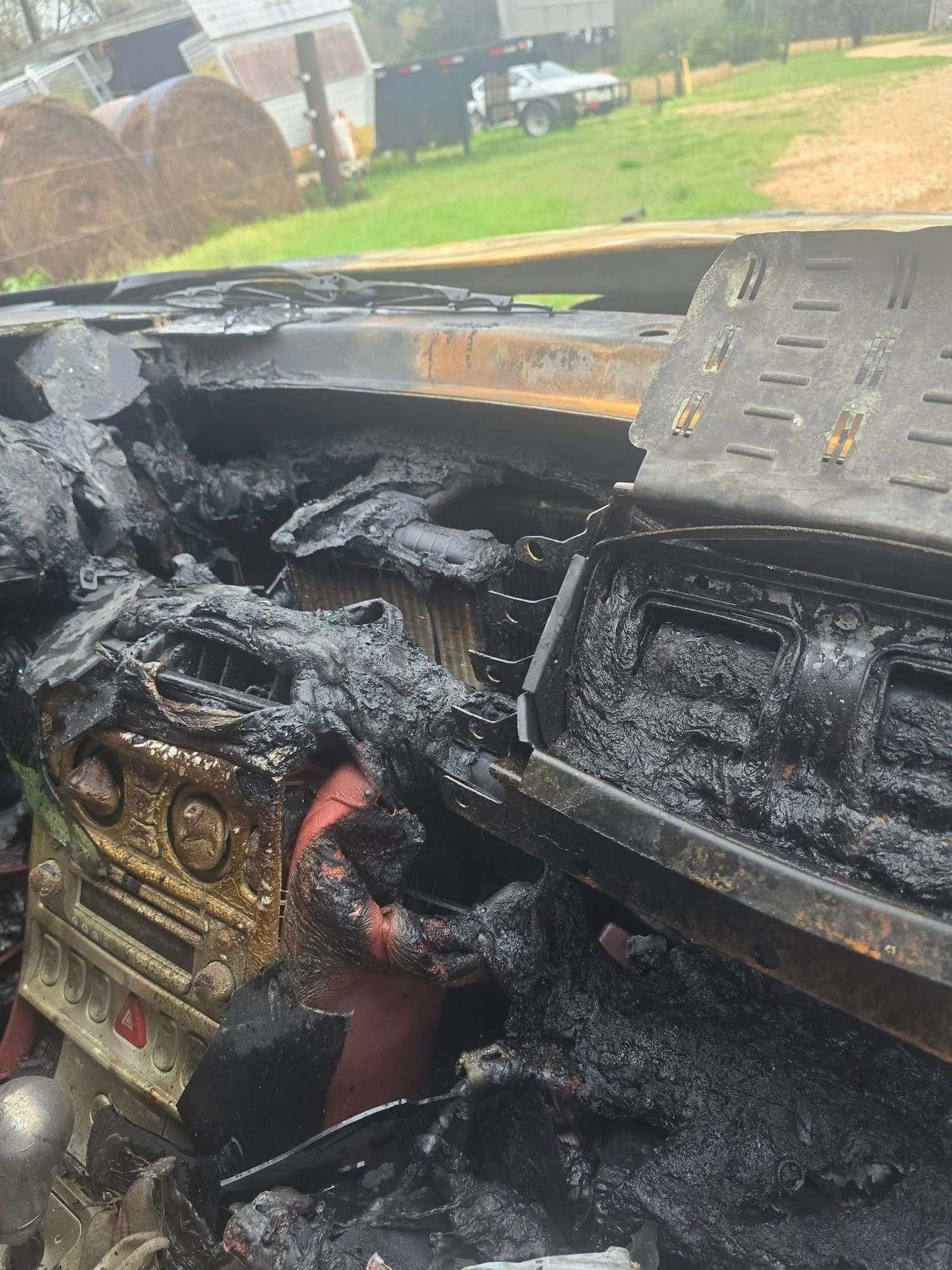

This was shared on Facebook by a long time owner of this Crossfire
She had this as a daily driver over 181,000 miles
And suddenly this occurred while it was parked in her driveway and not in her garage thankfully !!!
Lucky she was home when it happened and saved the house from catching on fire too !!
Something in the dash caught on fire while her car was parked outside
Thought to be the headlight switch based on several comments by others who have had dashboard fires in Crossfires
The only fuse to the headlight switch is the 200 amp chassis fuse.

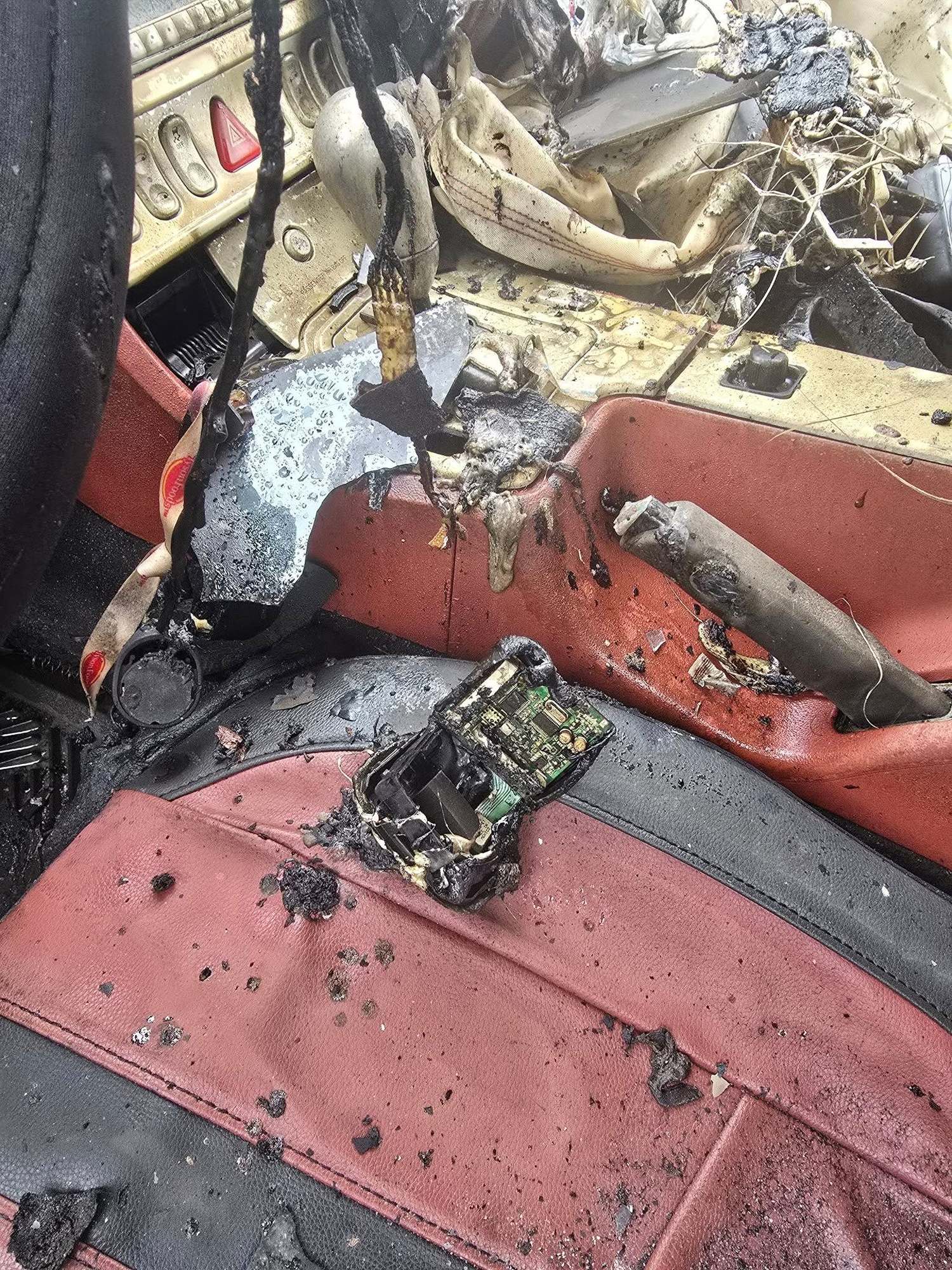

Another write up concerning the headlight switch shorting on a Crossfire posted today on Facebook ......
Hi everyone so I purchased another crossfire last September from a friend who had owned the vehicle for quite a few years and we have previously maintained it for him before he toured Europe without any issues so we knew the car was in good health.
After we bought it it sat around for a few months only getting used occasionally as we own quite a few cars.
Any way one morning dad jumped in it to drive to work which is only 1.5mile journey.
He had driven it home the day before. As soon as he started it and drove off he could smell
Something and got half way to work when smoke started to pour out of the dash board filling the cabin!
He pulled over straight away and switched the car off but it was still smoking so he popped the bonnet(hood) and disconnected the battery.
(Luckily we always carry a 10mm spanner in the center consol). We towed the car back to work and then started to inspect it.
The wiring loom in the engine bay and the 2 engine bay fuse board areas was all intact.
So I dropped the dash board down on the drivers side and could see the headlight switch had caught fire.
I removed the instrument cluster to inspect and check all the wiring in that side of dash board but could not see any other damage.
The fuse board on the side of the headlight switch did not have single blown fuse but one had signs of it getting hot.
But it was very close to completely destroying the car when you see how much damage had been caused inside the switch unit.
The lights had been working ok and the car is completely standard so no dodgy modifications.
I temporarily fitted a new switch unit from a donor car and connected the battery as I wanted to power everything up and check if all the lights and circuits connected to the switch were working, everything was ok and the vehicle was starting and running ok.
So it looks like the light switch went faulty, there was no sign of water ingress and the car was dry inside.
What I have now found is that there is a serious oversight in the wiring system that can allow this to happen as the switch unit is a load carrying switch so doesn't operate relays to take the load/current like most vehicles now on individual circuits.
This in it self is ok if each circuit is fuse protected but on the crossfire only the output circuits have fuse protection but the 2 incoming power wires are not fused.
So the switch has a constant 12v+ battery supply unfused and a 12v+ ignition supply is unfused.
Theses are both heavy cables so can hold a heavy current! The constant live is powered from a buzz bar inside the engine bay fuse board(driver side) this buzz bar does have 200amp fuse in the remote fuse board by the battery but this is far to high to protect from a faulty light switch.
So I have now fitted 2 new inline 20amp maxi fuse holders and fuses. Using crimp spade connectors to connect one end into the loom and the other end onto the light switch.
I made this flying loom about 14"" long so when the dash is back together the new fuses are accessible from inside fuse door on the end of the dash board just below the headlight switch fuse board. I am now doing this on all my crossfires and would recommend every one to do it as this fault could occur when the vehicle is not in use not just when being driven and also when the lights are not being used as the light switch has multiple functions not just the headlight lights.
I am going to look at what other circuits are powered off the buzz bar and add some more fuse protection to the incoming side of the other circuits/systems powered from the buzz bar.
I have also cleaned all the main earth points and added some extra earth leads now.

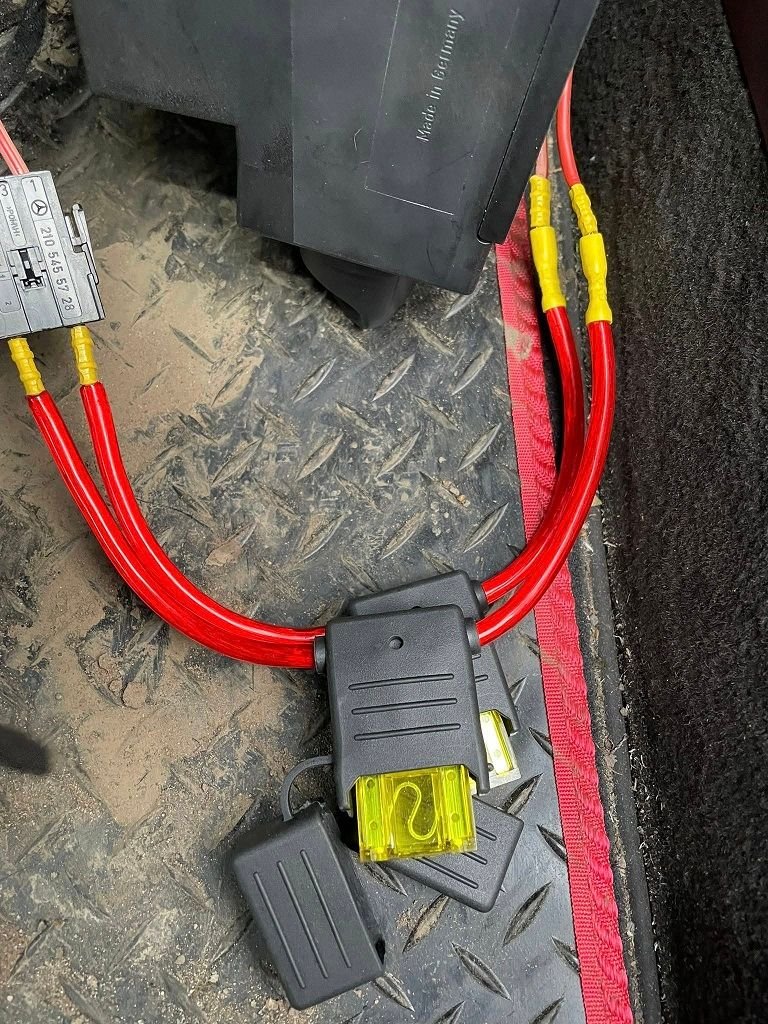

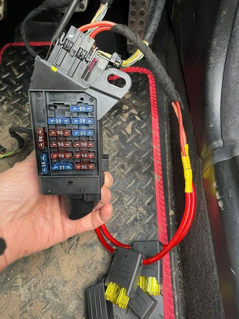

Here are some pictures from a facebook member that installed a couple of 20 amp inline fuses on the power leads going to the light switch.
He said he kept them about 14" so that he could make it so that he could access the fuses through the access panel door. These pictures coincide with Valk's post above.
I'm probably going to do this when I get back from the Athens event. If I do I will document it as always.
However, I've never really had my dash apart, so if someone with more experience wants to do it, please do.
