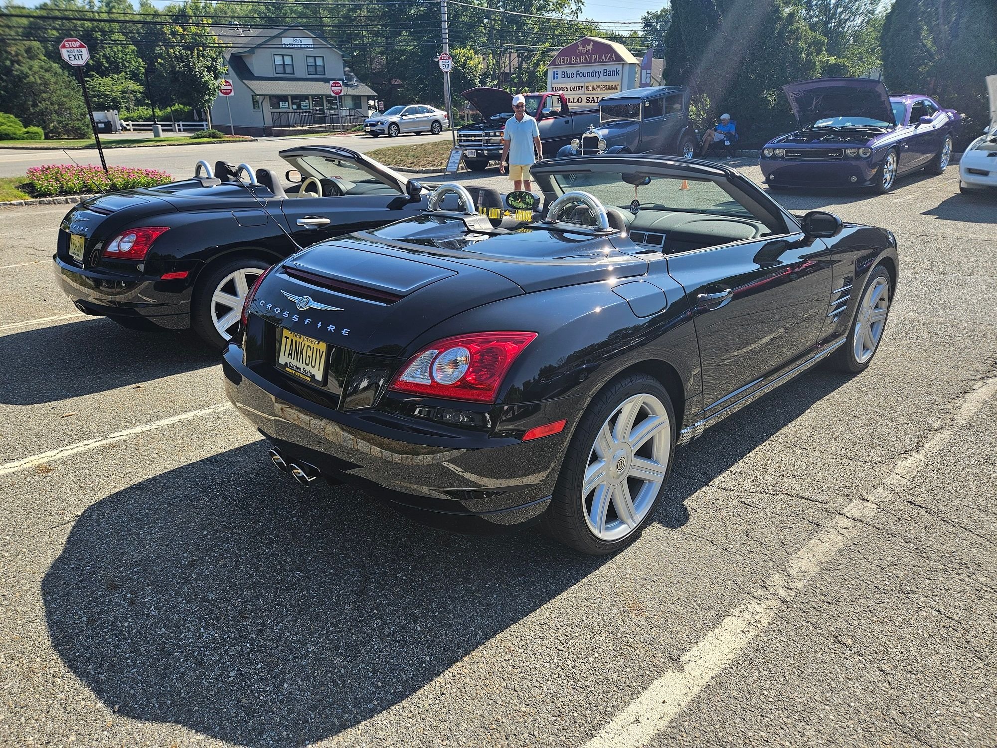

Svengoolie is surrounded by red Crossfires!
I've been to a few car shows recently and have run into 3 separate red Crossfires!
On July 20, 2025 I ran into a 2005 limited coupe at a show in Rockaway, NJ.
On August 2, 2025 the man with the 2005 limited roadster showed up at the Saturday night cruise in Towaco, NJ.
Today, August 3, 2025 a 2004 Coupe showed up at a car show in Belvedere, NJ.
All three of them are red! What the heck?
2005 Coupe at Rockaway, NJ show
2005 Roadster at Towaco, NJ cruise night
2004 Coupe at Belvedere, NJ car show

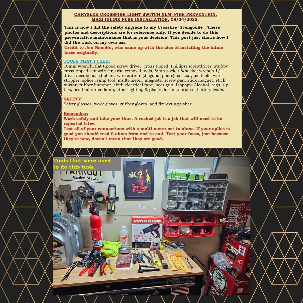

Illumination Control Module (Headlight Switch) Fire Prevention. Part 1 of 3
Svengoolie is like Smokey The Bear now... Preventing fires! Completed on August 22, 2025
(Due to a 10 picture limit, this post is divided into 3 parts).
After reading here and on facebook about a few Crossfires catching fire due to problems in the headlight switch, I decide to be proactive and hopefully eliminate the threat.
I have to give credit to Jon Ramdin for his original post on facebook addressing this problem and suggesting inline fuses as the solution.
The following posts are how I did the work on my personal car. I made the posts for reference purposes only. The work you do on your own car is your responsibility.
Remember to work safely. Patience is the key to a successful job.

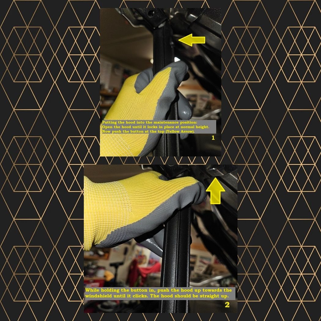

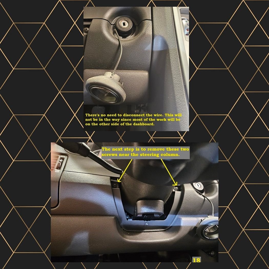

Illumination Control Module (Headlight Switch) Fire Prevention. Part 2 of 3

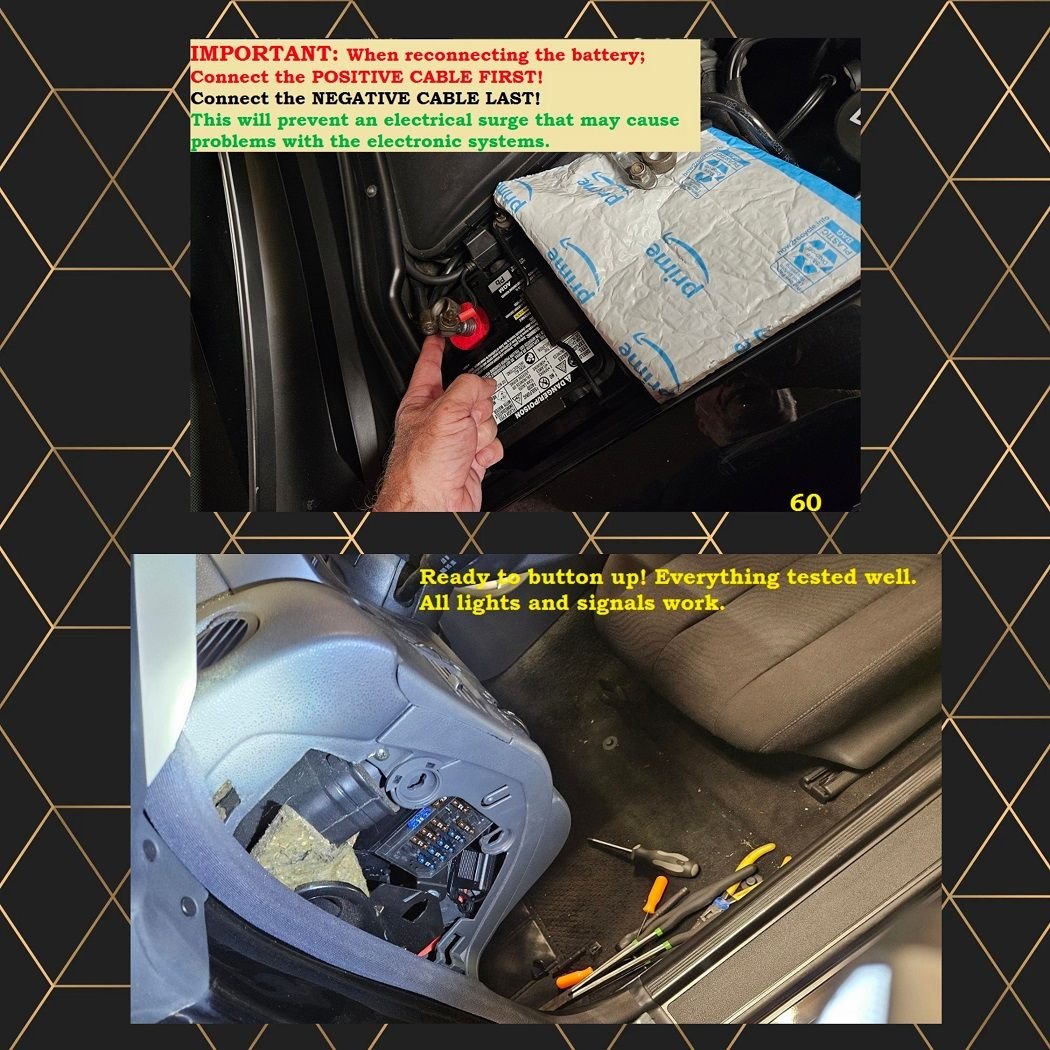

Illumination Control Module (Headlight Switch) Fire Prevention. Part 3 of 3
