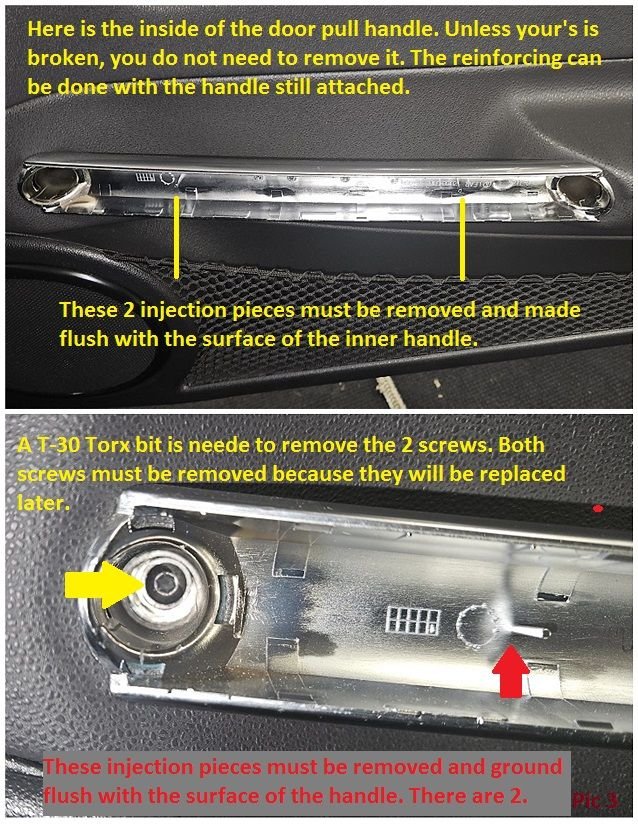

Inner Door Pull Handle Reinforcement
Ladies and Gentlemen... The Doors!
Svengoolie gets his door pulls reinforced. PART 1 of 2
February 22, - February 26, 2024.
After reading posts about people's inner door pull handles breaking, I wanted to find away to prevent this.
I found a couple of posts here and on facebook on how to repair the broken ones. So I combined parts of both of those posts that I liked and modified it for more of a preventative maintenance solution.
Here's how I did the work on my car:
