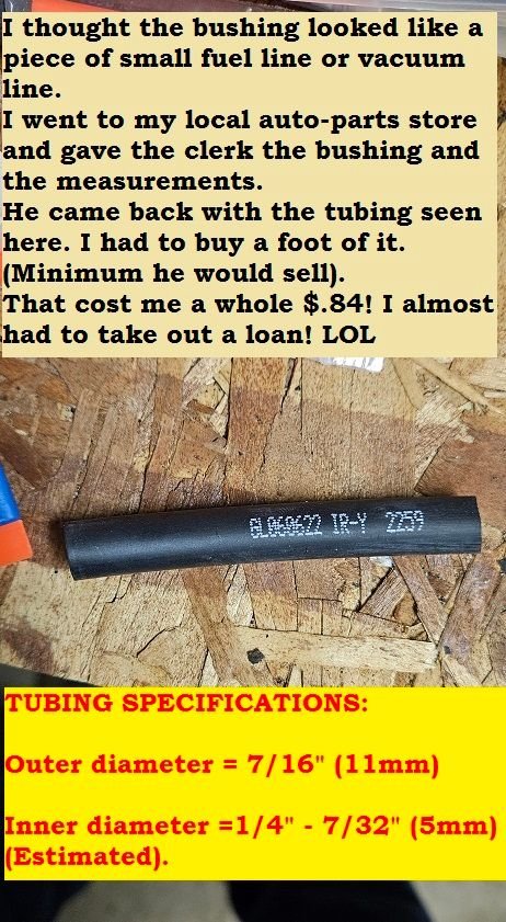

Svengoolie let me know his battery was low by popping up the wing when I turned the ignition to the on position. We had some very cold weather that week.
While the wing was up I took a look at it. I noticed one of the bushings was falling off and the other was gone. I repaired it on December 29, 2023.
Here's a cheap and easy fix to solve the problem...
