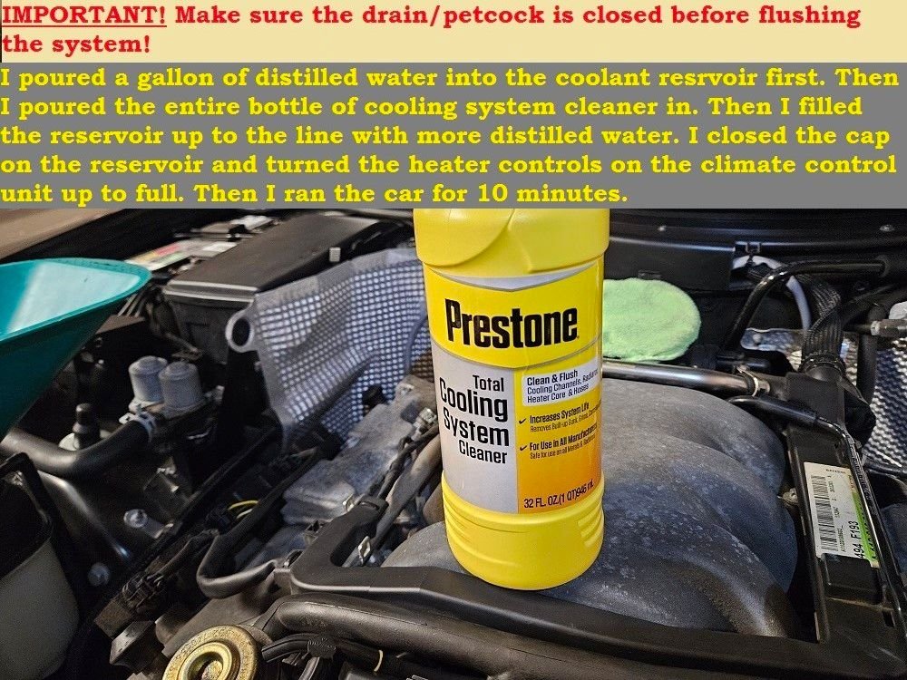

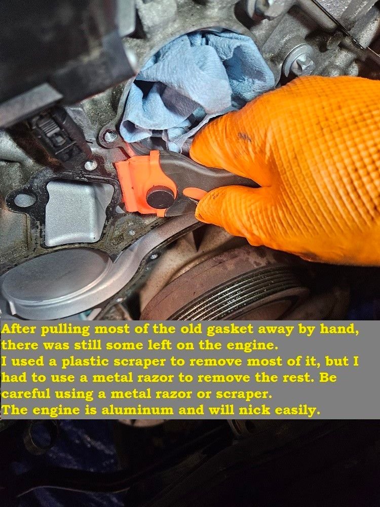

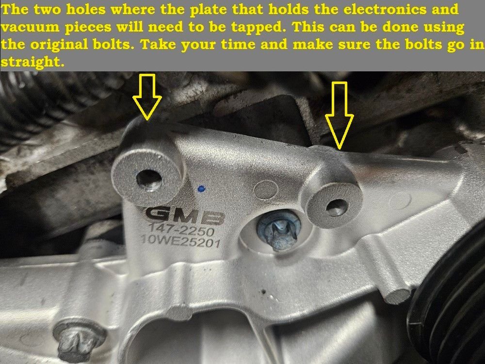

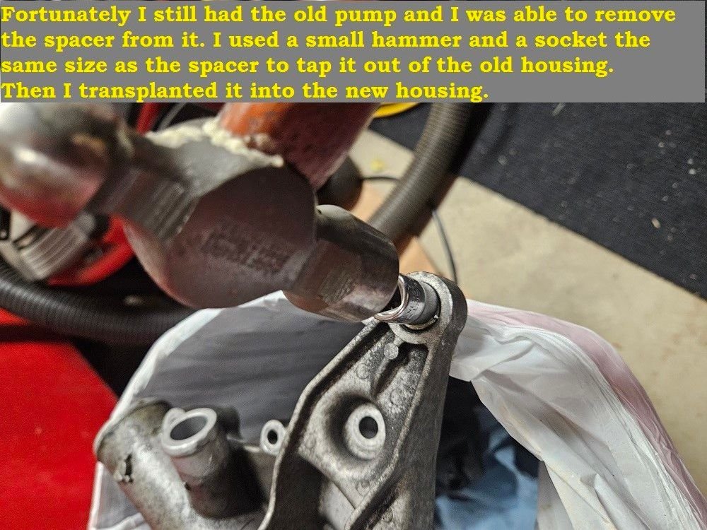

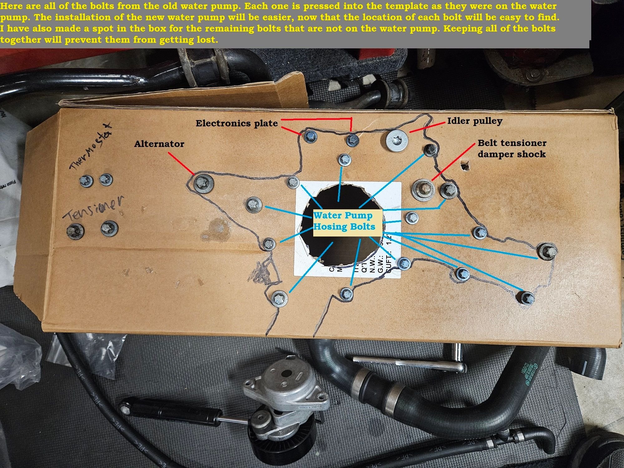

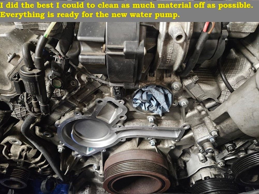

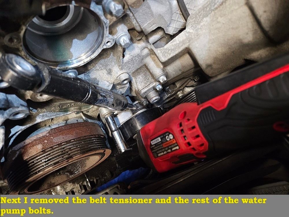

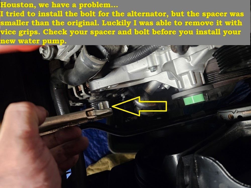

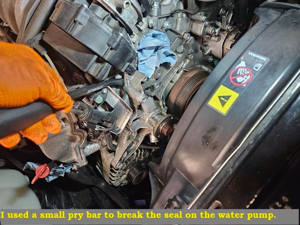

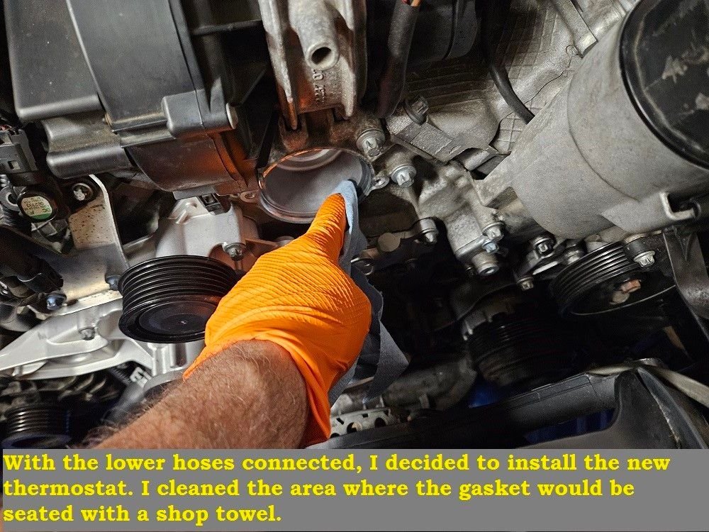

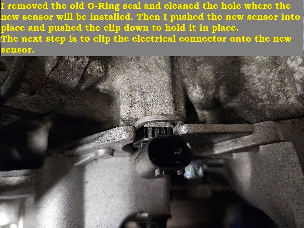

Water pump, Thermostat, Coolant temperature sensor, Hose Replacement and Coolant flush. PART 4 of 7 (10 picture restriction per post) March 29 - April 6, 2026. (working on other things as well).
Svengoolie flushed like he ate too many burritos at Taco Bell!
I'm going to be doing a 1,000 mile trip out to the Crossfires in Athens event in Ohio at the end of May. Although the coolant tested fine with a hydrometer and the pump seemed okay, I have decided to upgrade the 20 year old cooling system.
I am replacing the water pump, thermostat, Coolant temperature sensor, upper and lower hoses and doing a coolant clean and flush.
Special thanks to Rob at Needswings.com for the fast shipping of my order!
This is how I do the work on my car. I'm not a professional mechanic. The pictures and descriptions are for reference only. Any work that you do on your car is your responsibility. Safety first and patience make for a job well done!

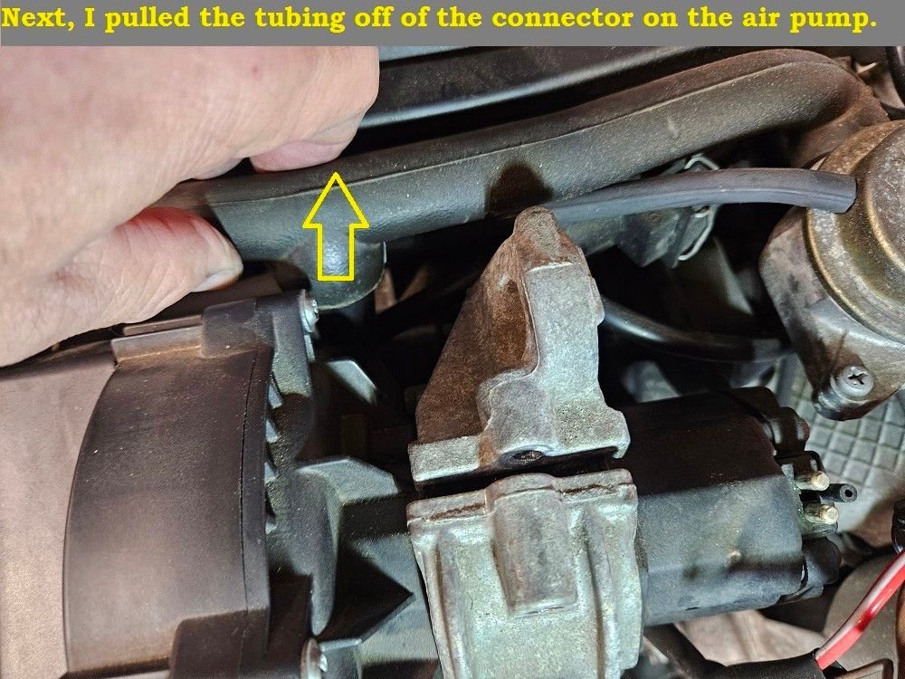

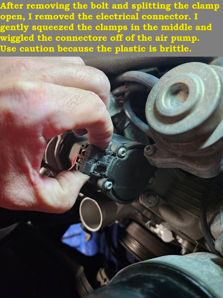

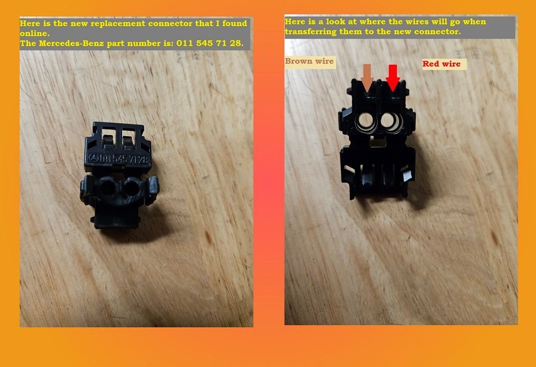

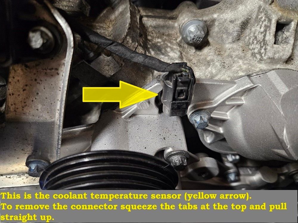

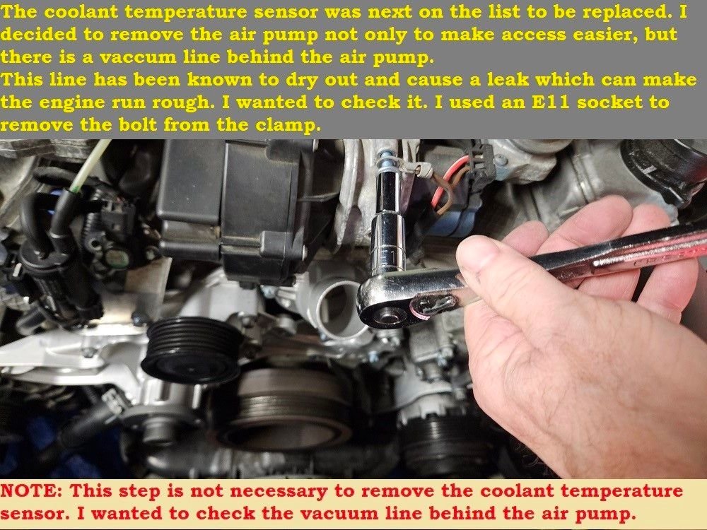

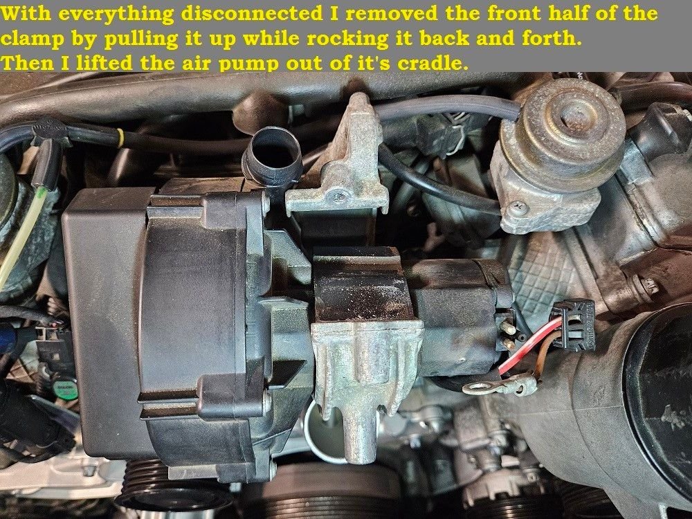

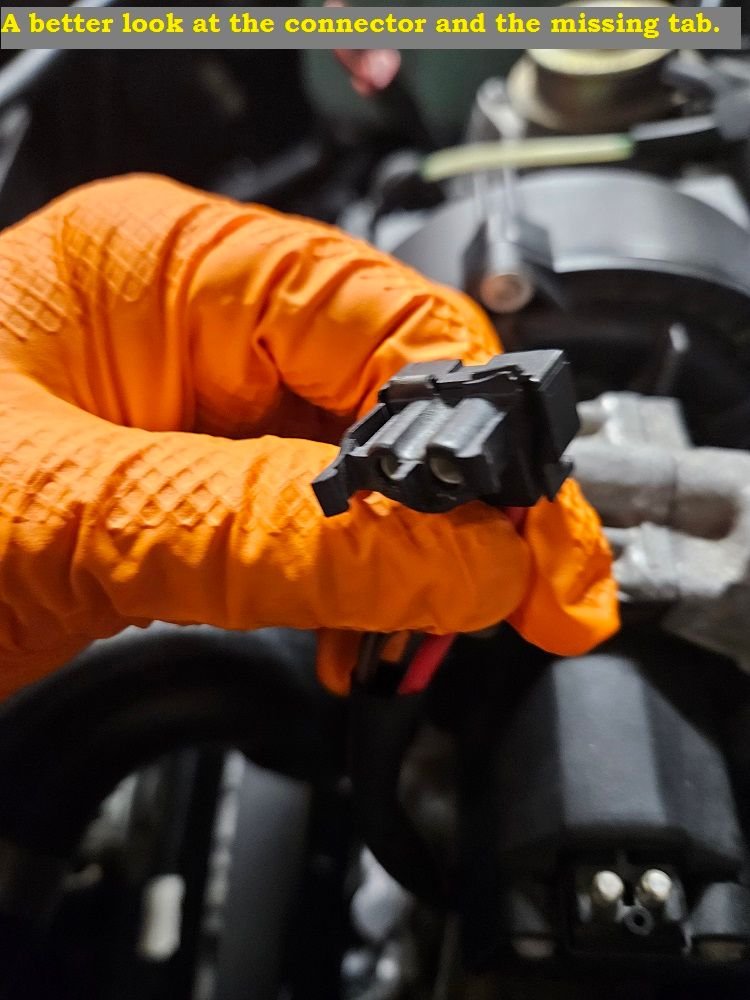

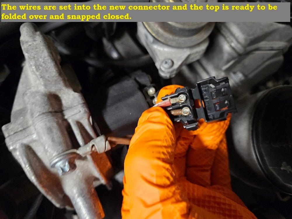

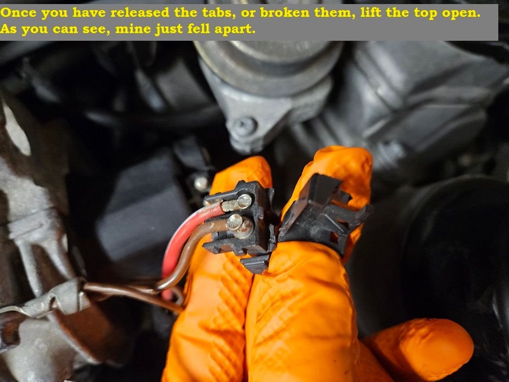

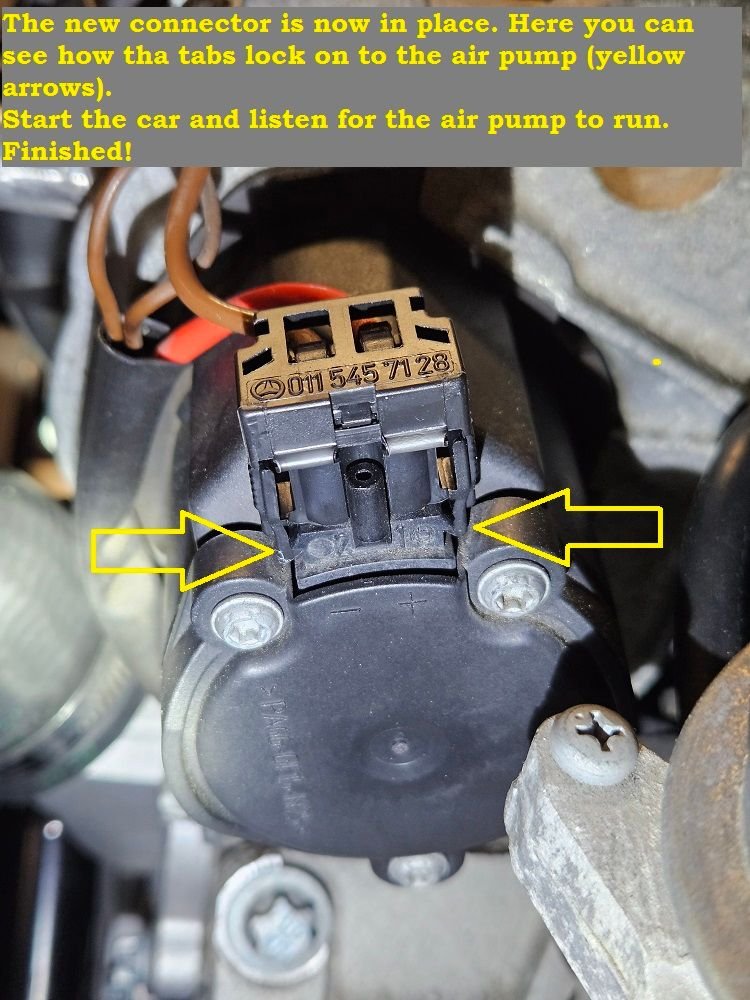

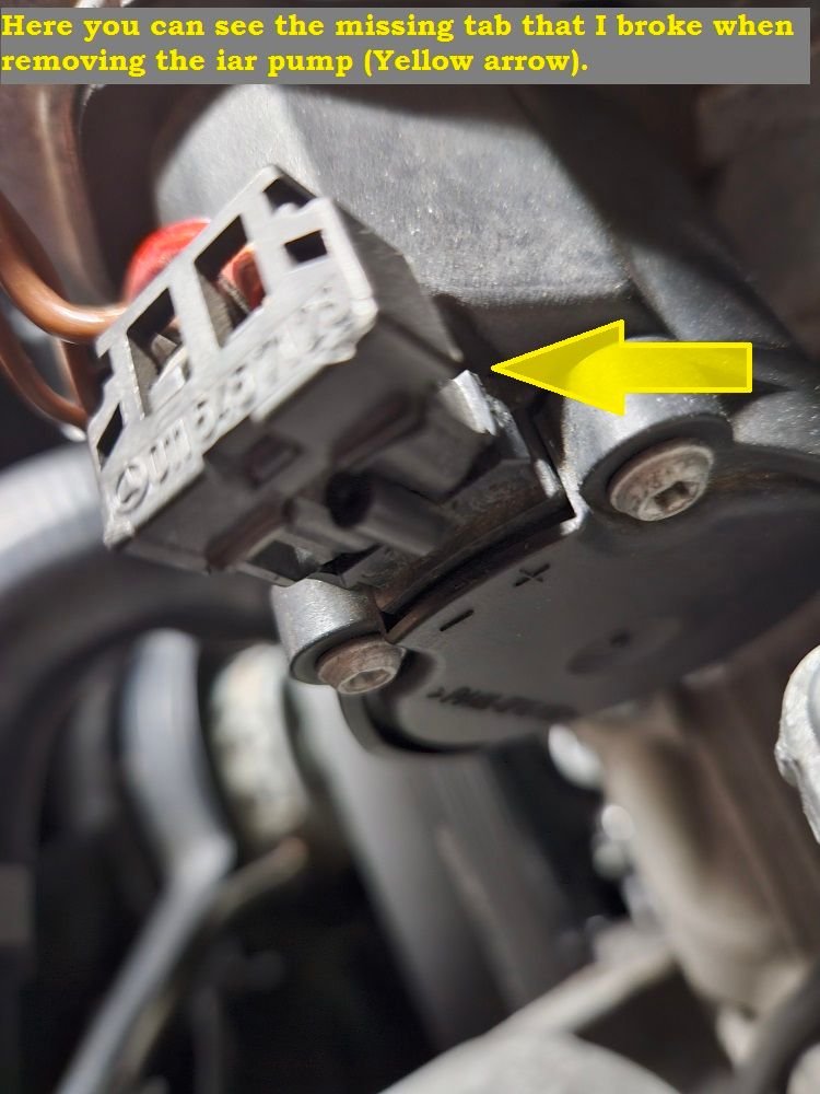

Air Pump Electrical Connector Replacement. April 24, 2026.
Svengoolie says "We pump you up" like Hans und Franz!
When I was removing the air pump to check the vacuum line behind it, I broke one of the locking tabs. This post shows how I replaced it with a new one.

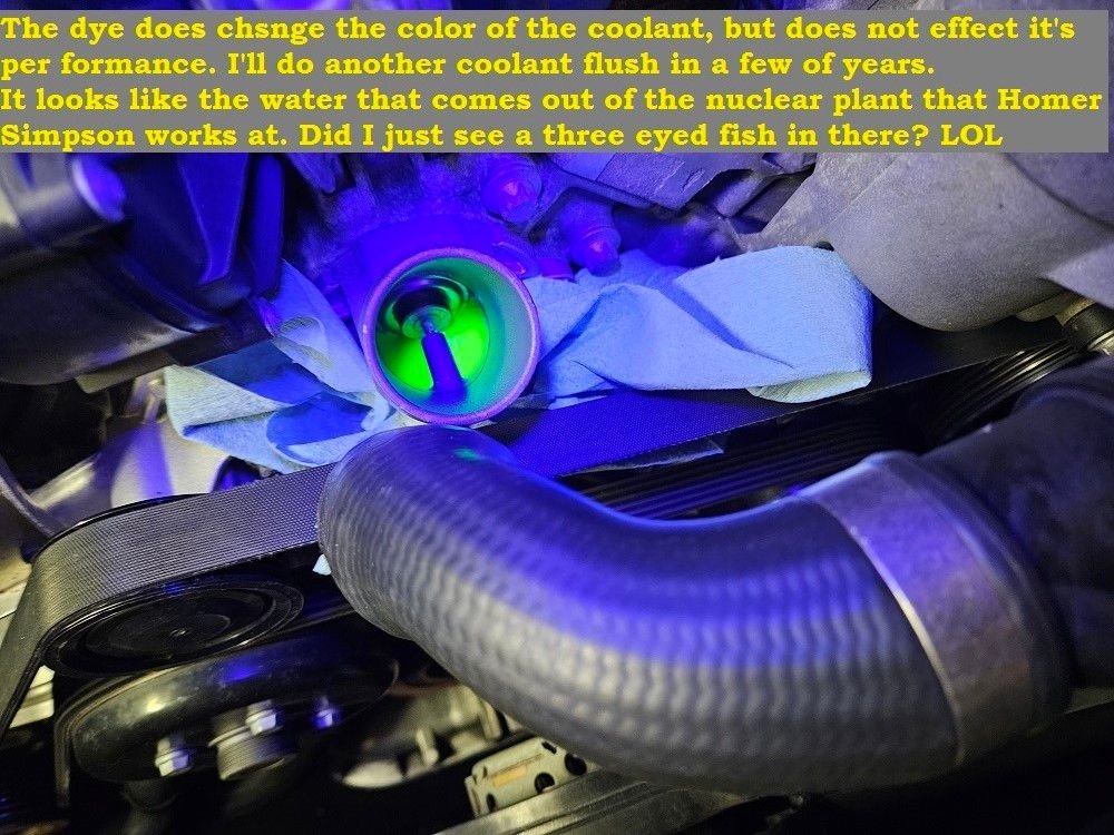

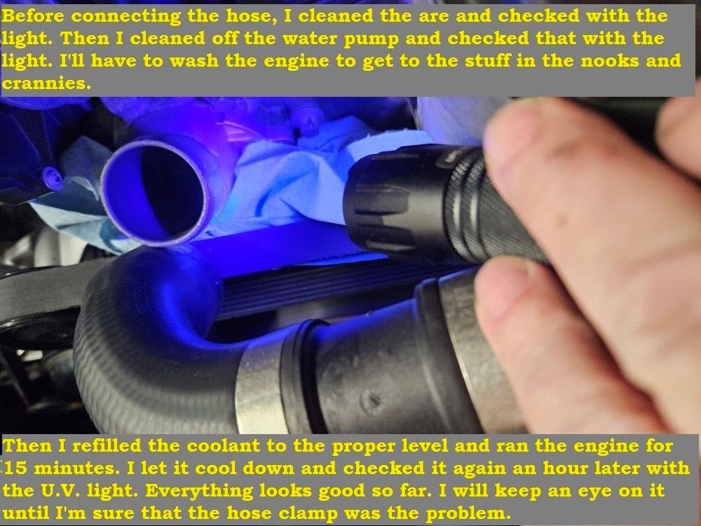

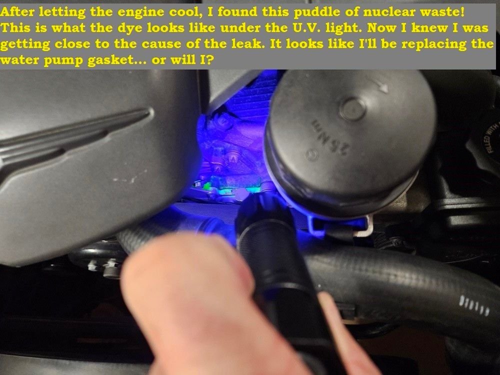

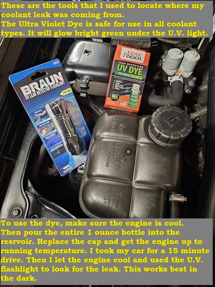

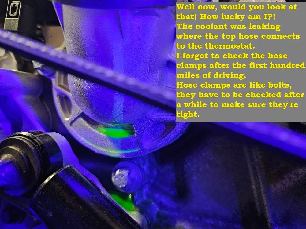

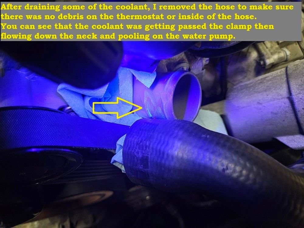

How to locate a coolant leak. April 23, 2026.
Svengoolie was glowing like a 1970s Jimi Hendrix poster!
Well, nobody's perfect.
After I had replaced the water pump, coolant temperature sensor, thermostat and hoses, I drove the car a few times. Then I noticed coolant in the engine belly pan.
I looked around and saw coolant on top of the water pump. I assumed it had leaked up through the top of the gasket. I re-torqued all of the bolts and that seemed to solve it.
Then I went for a long drive and when I got home I didn't really see anything. Then I opened the hood after the car had cooled down and there was more coolant in the belly pan, but I couldn't find where it was coming from.
I decided to use a U.V. coolant dye and a U.V. light to find it. Here's what happened...
