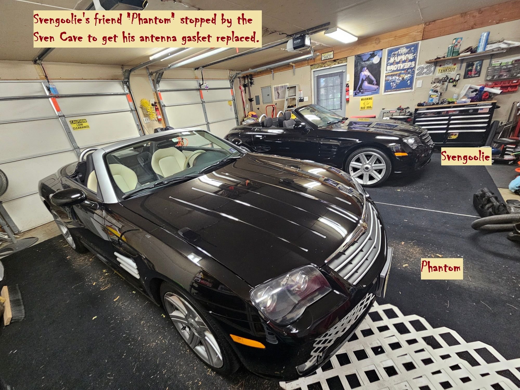

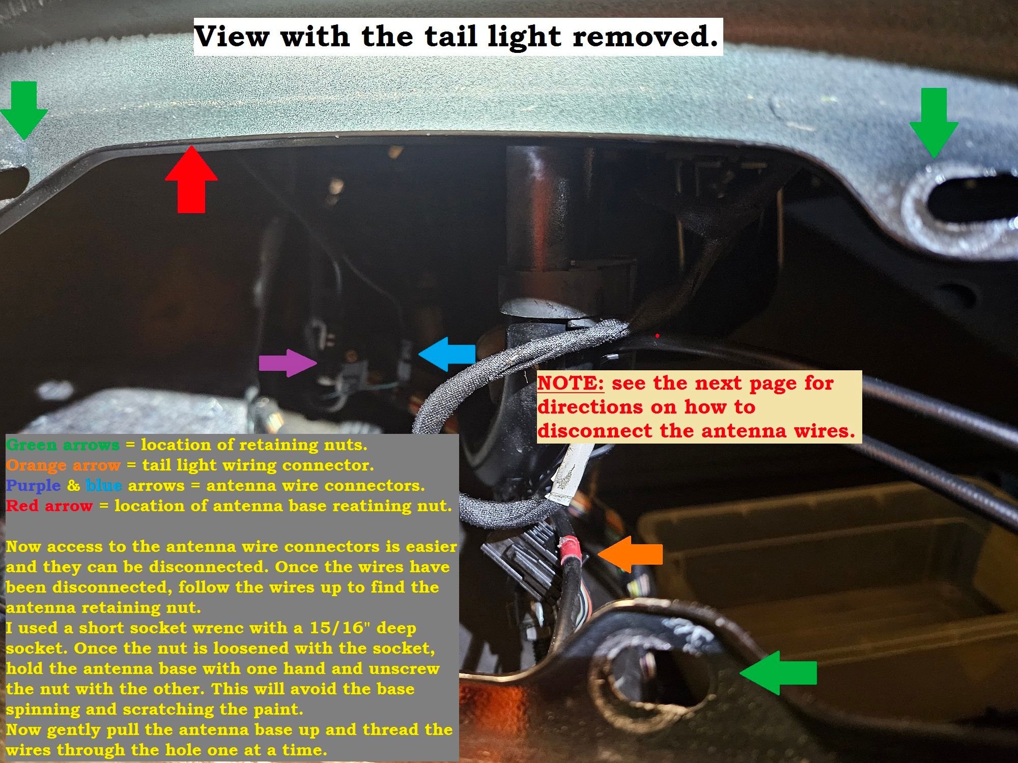

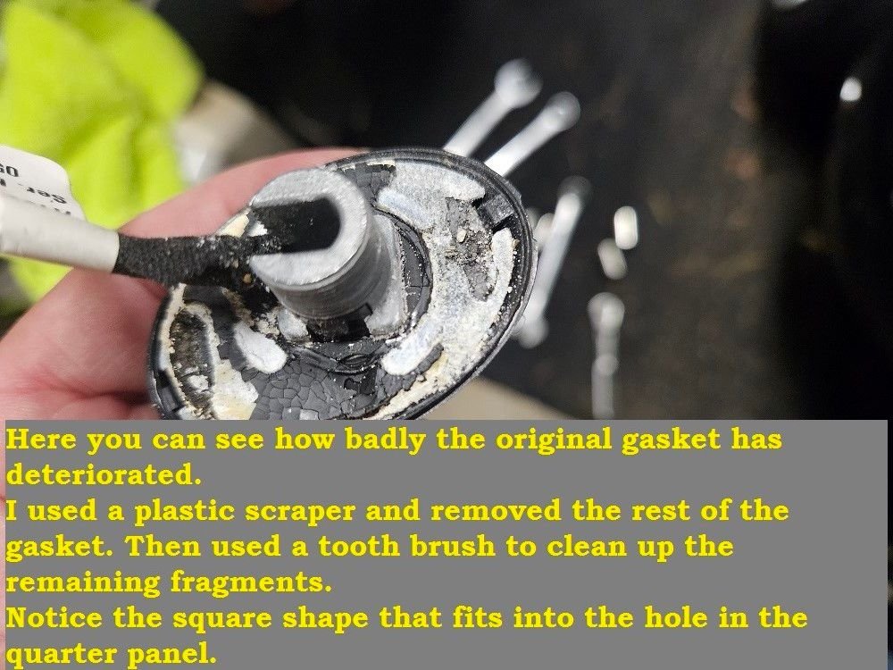

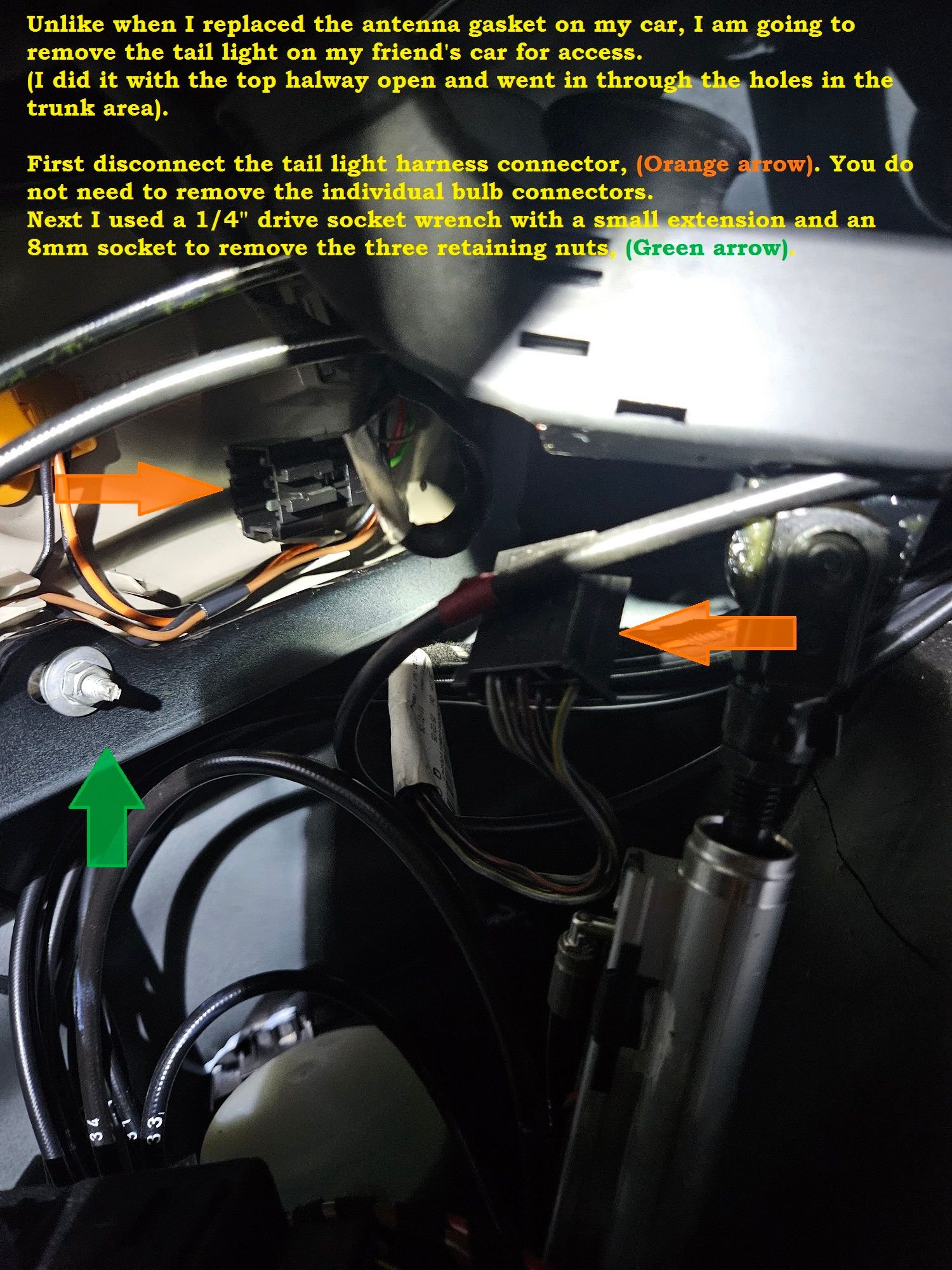

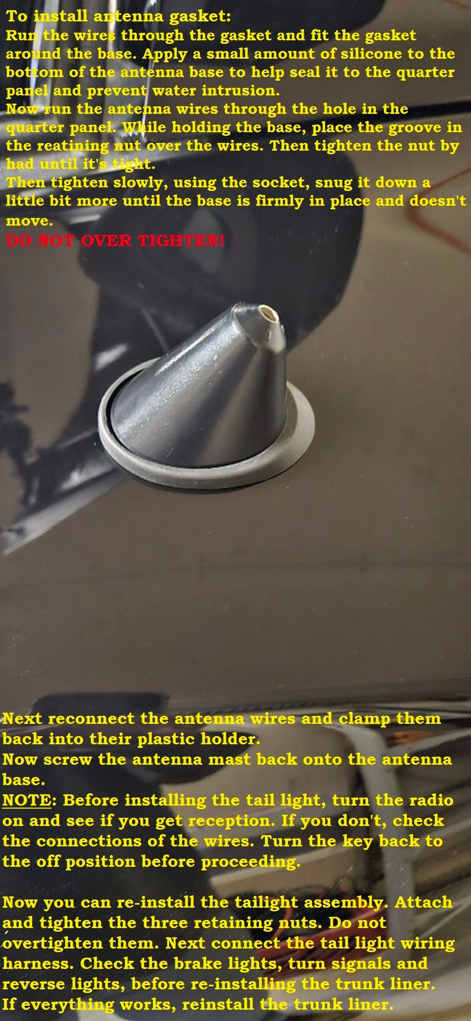

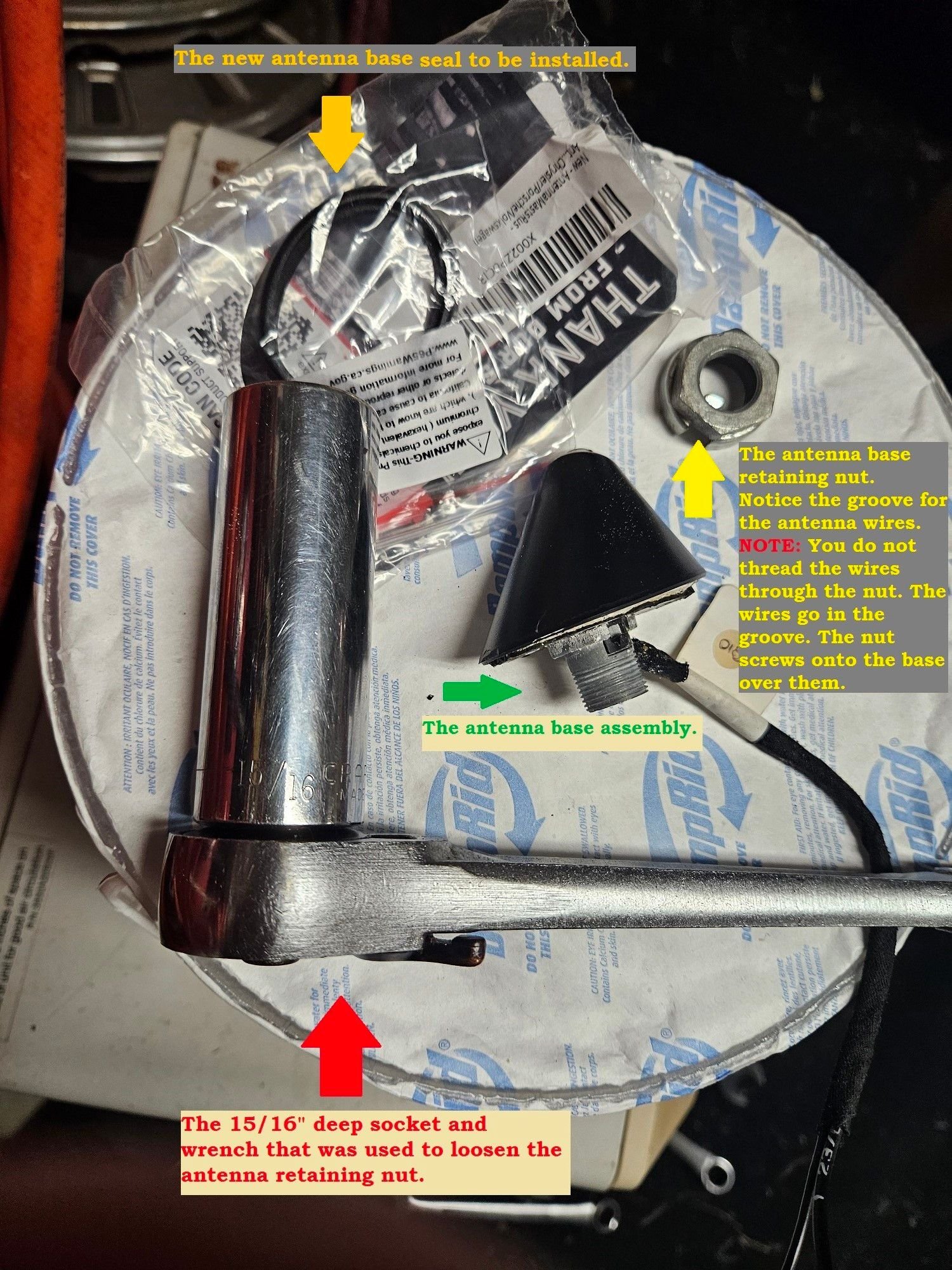

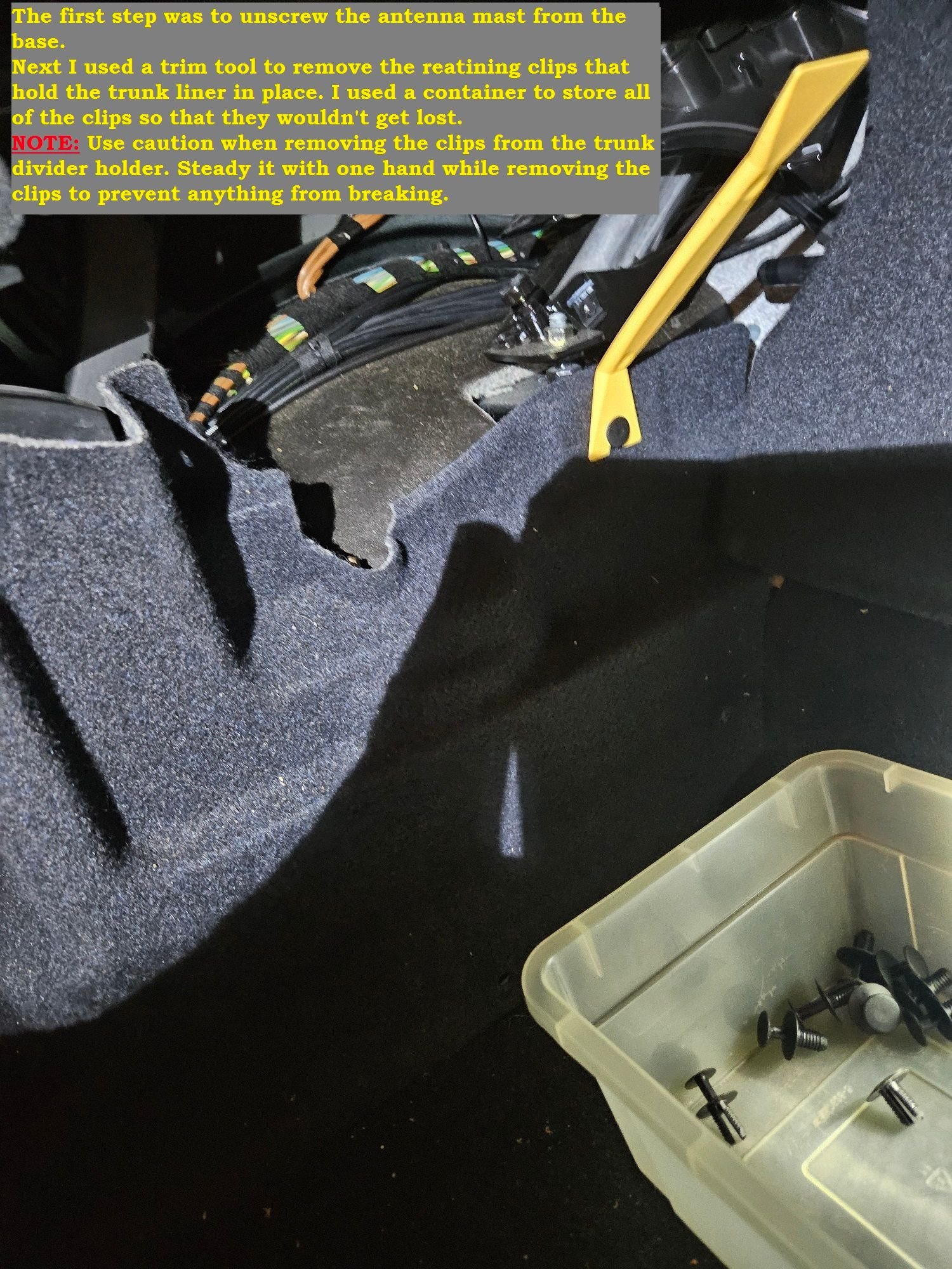

Roadster antenna gasket replacement #2. Part 1 of 2
Svengoolie gets a visit from a Phantom... Completed on September 26, 2025
(Due to a 10 picture limit, this post is divided into 2 parts).
Remember to work safely! Patience is the key to a job well done.

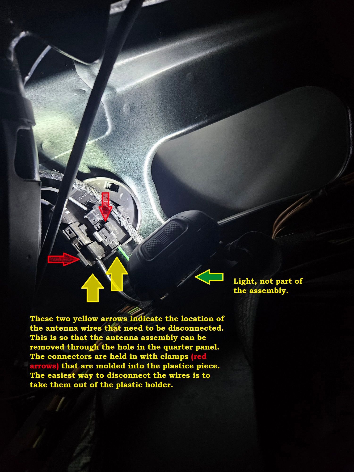

Roadster antenna gasket replacement #2. Part 2 of 2

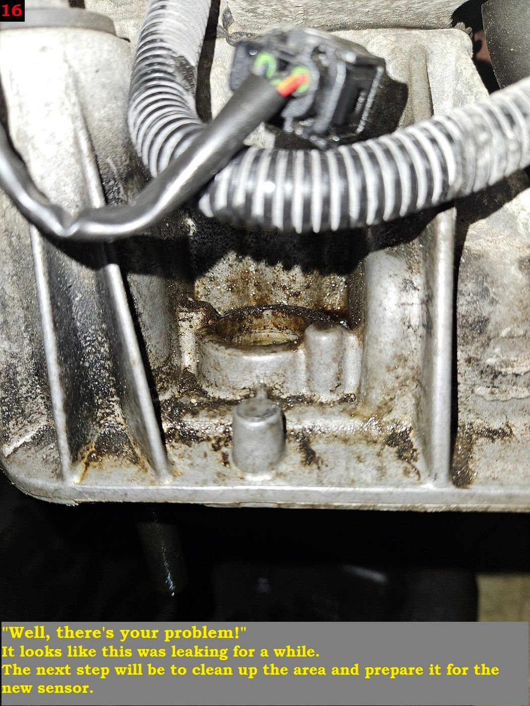

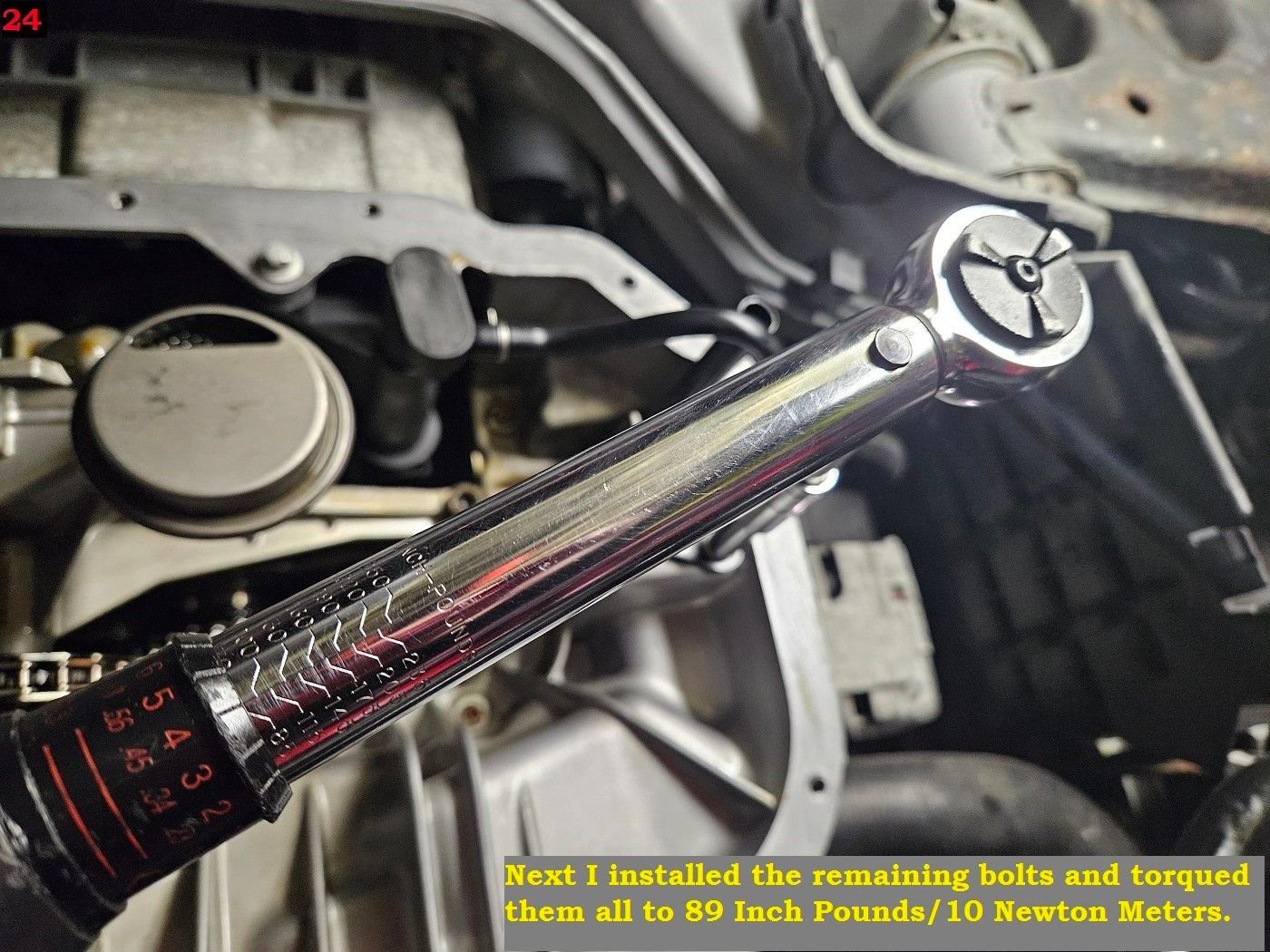

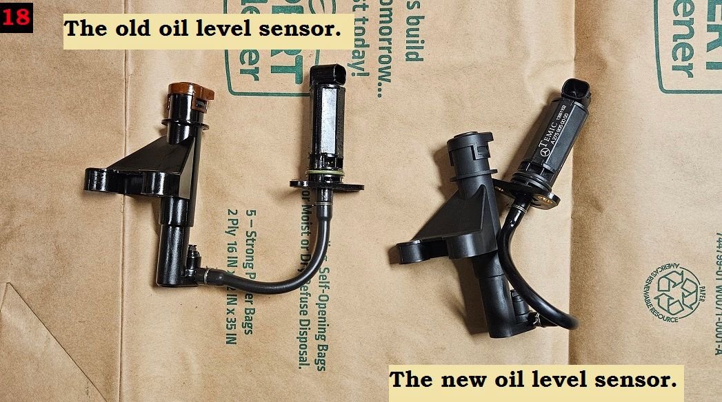

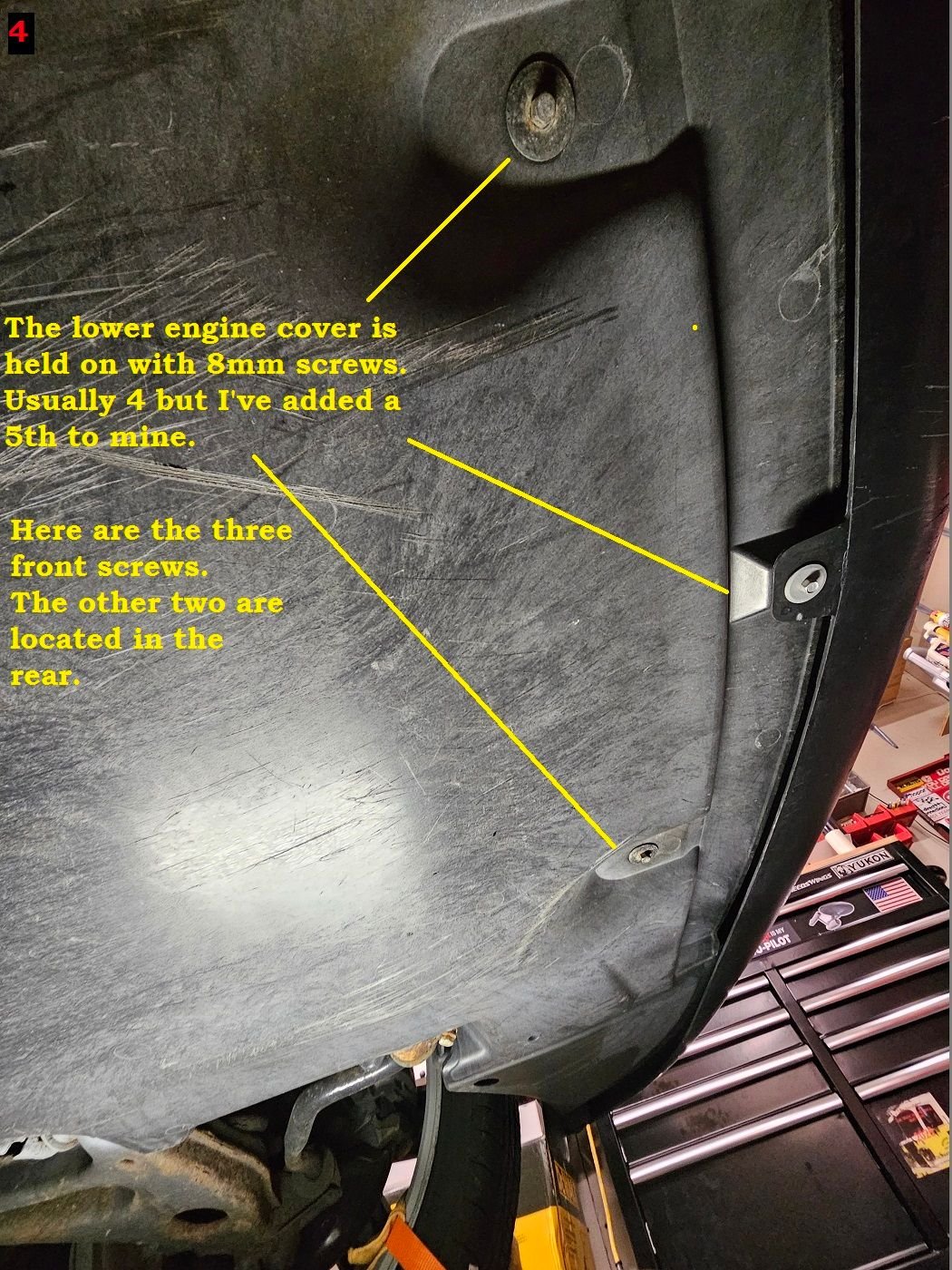

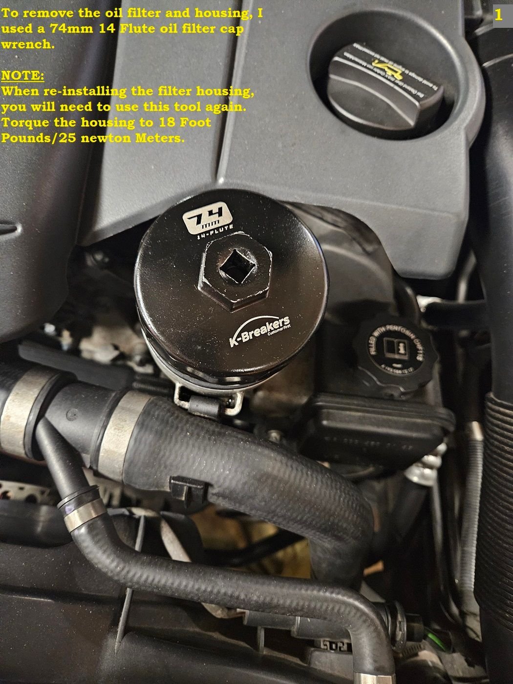

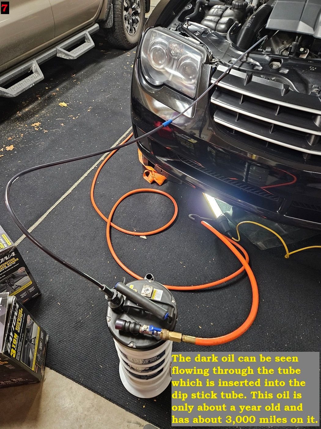

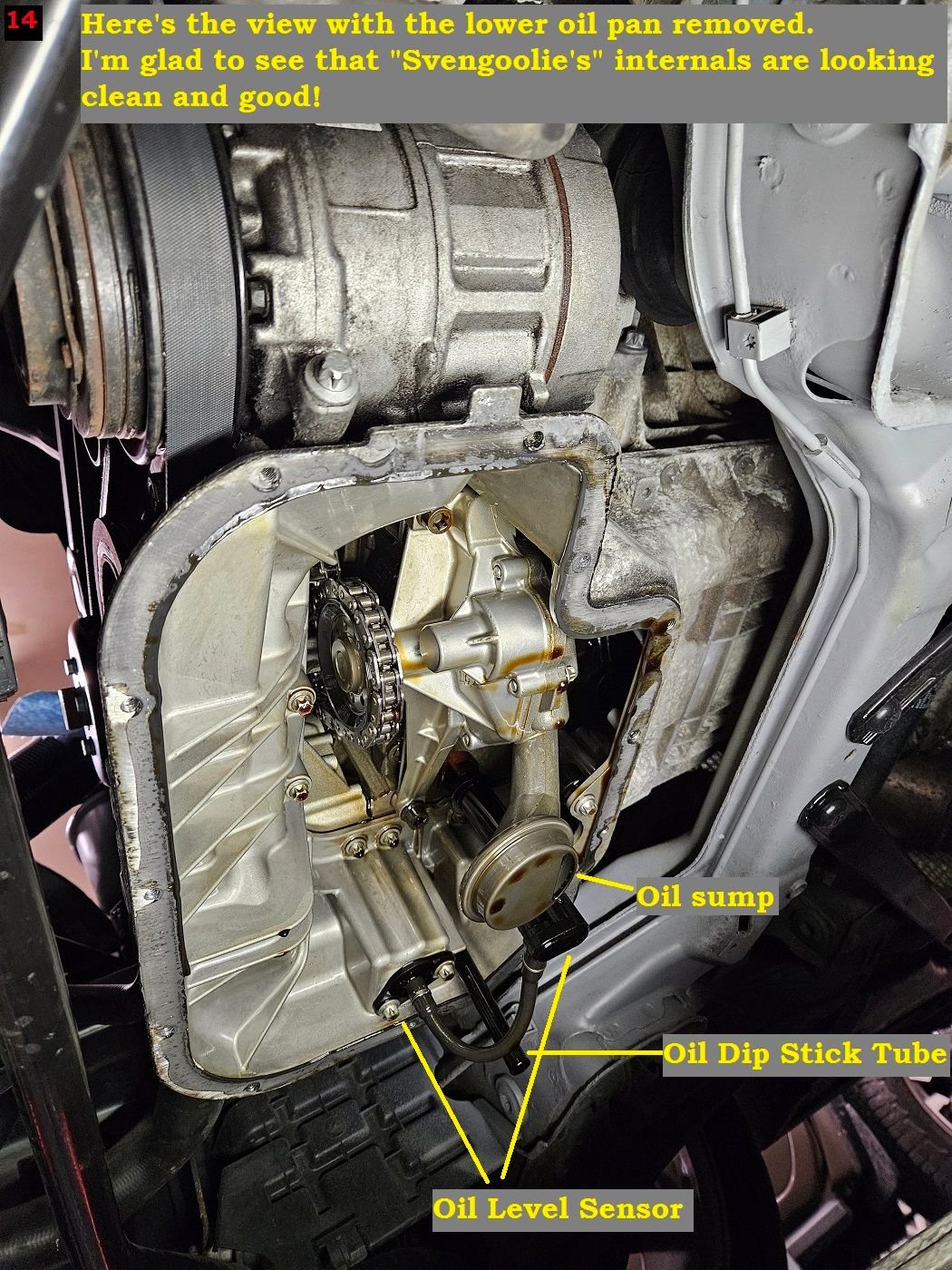

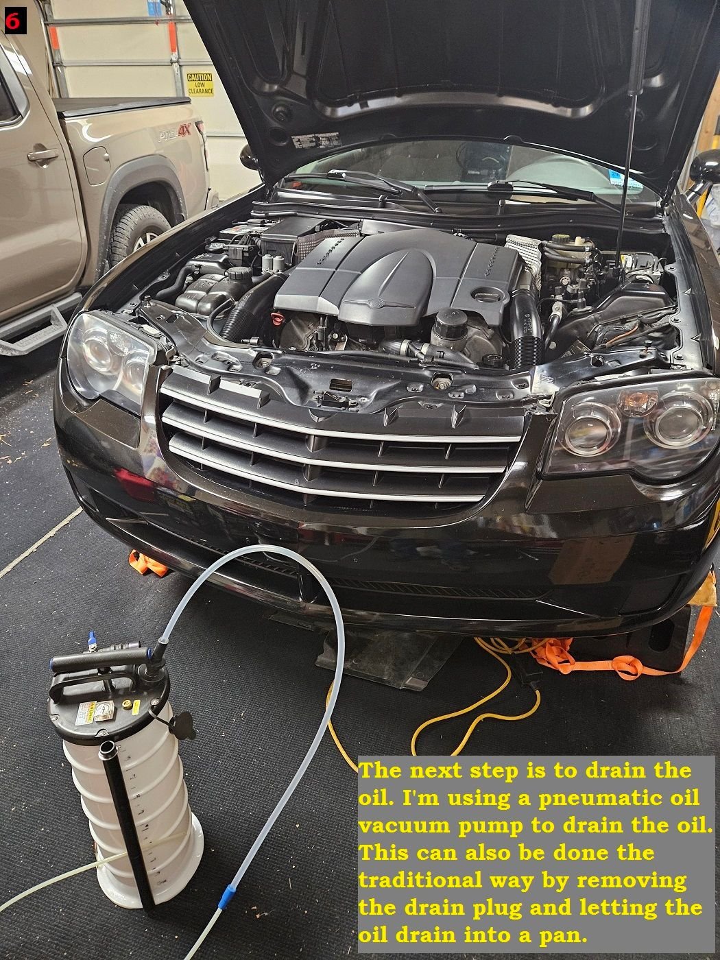

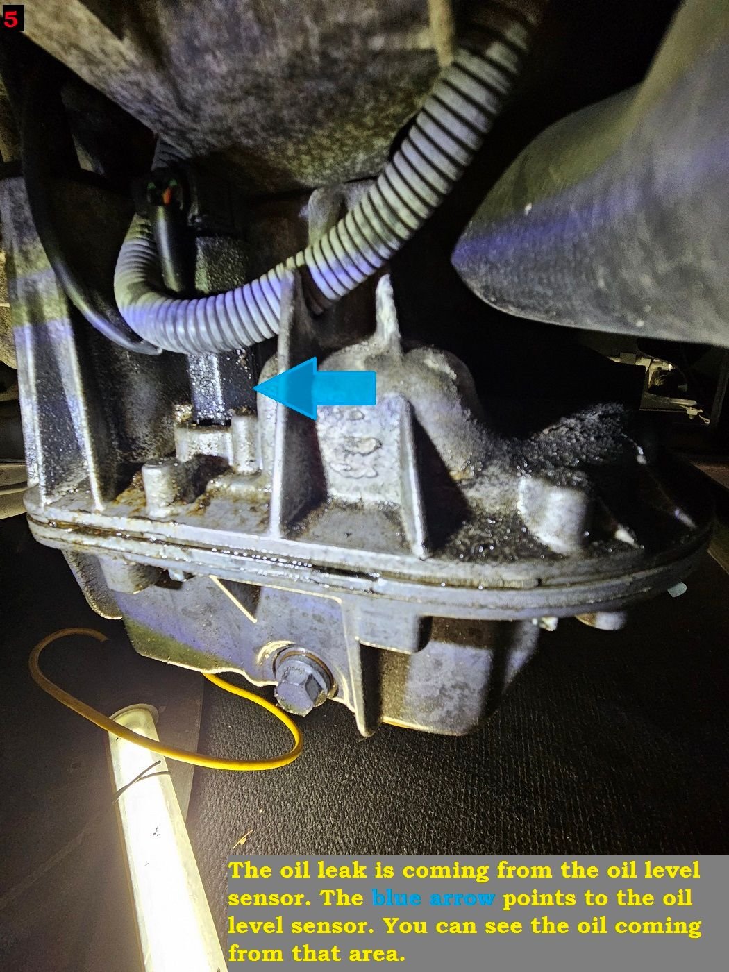

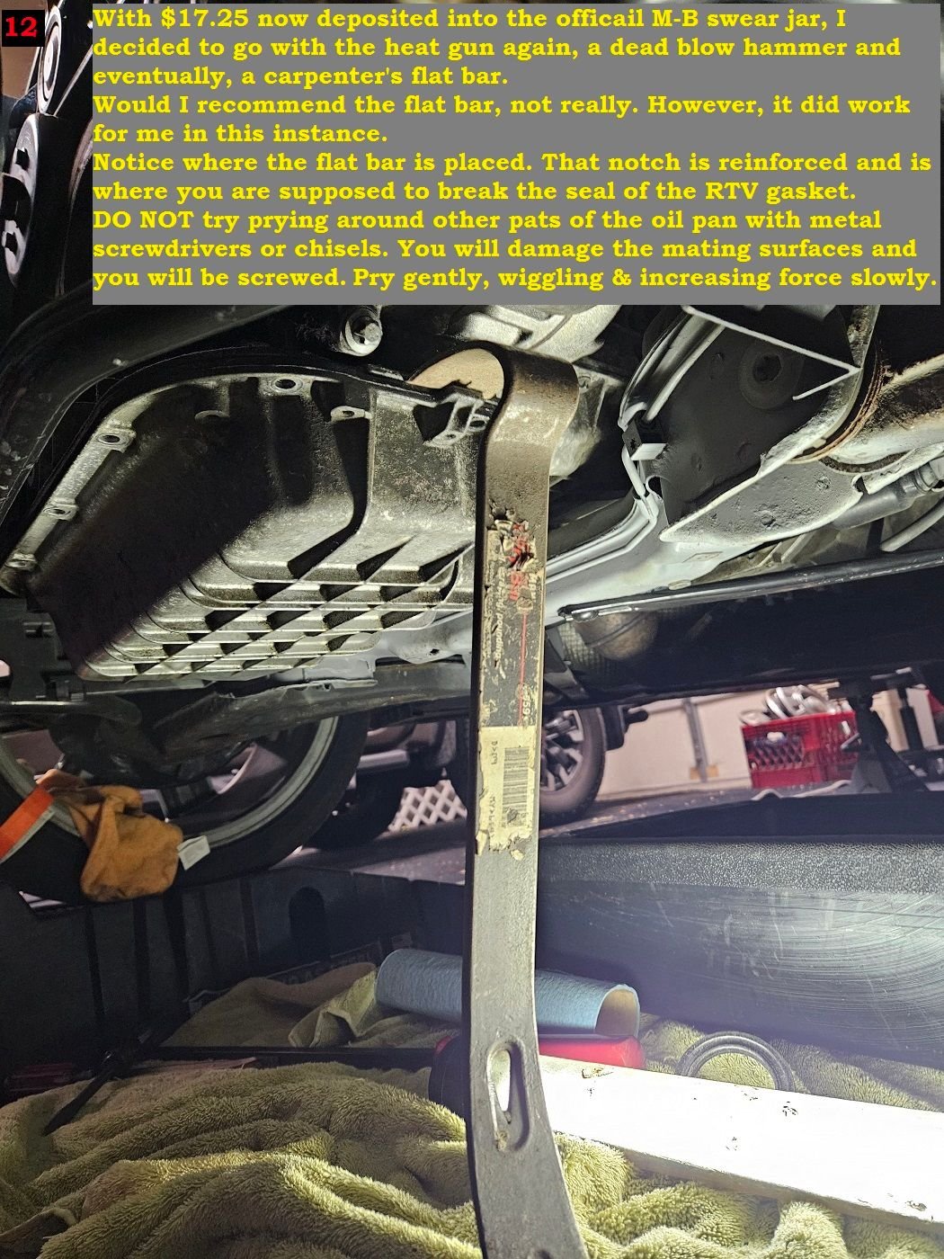

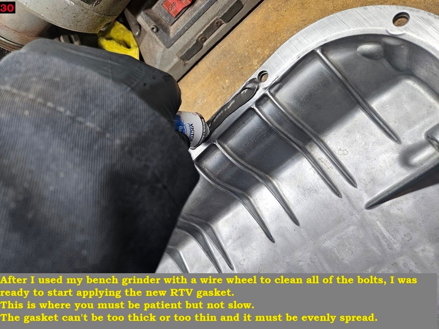

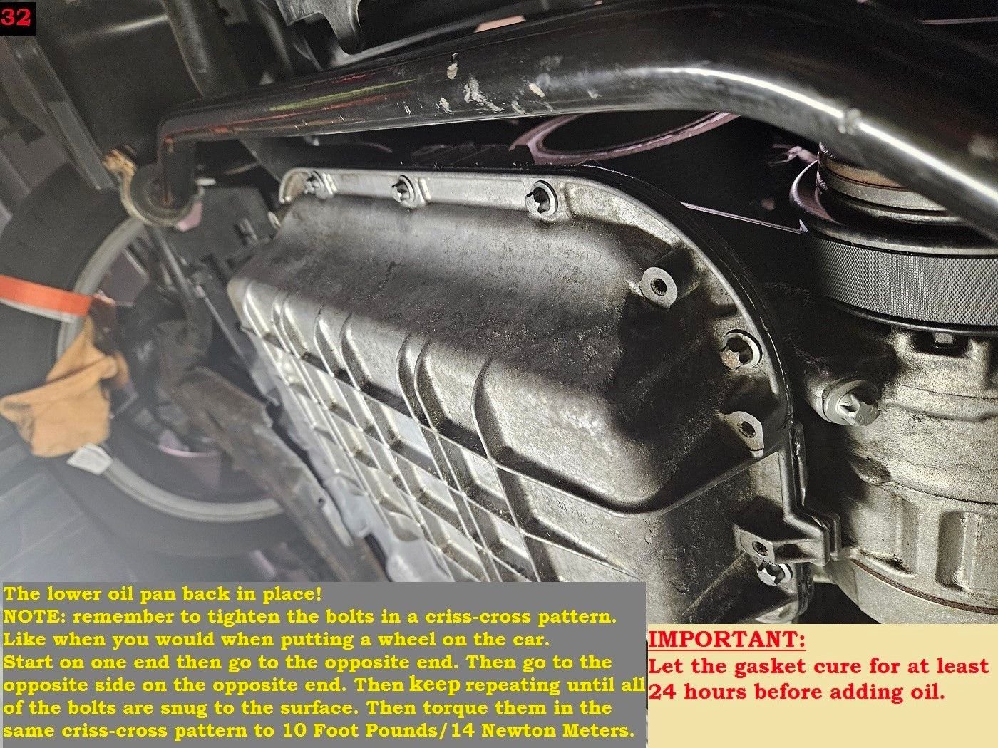

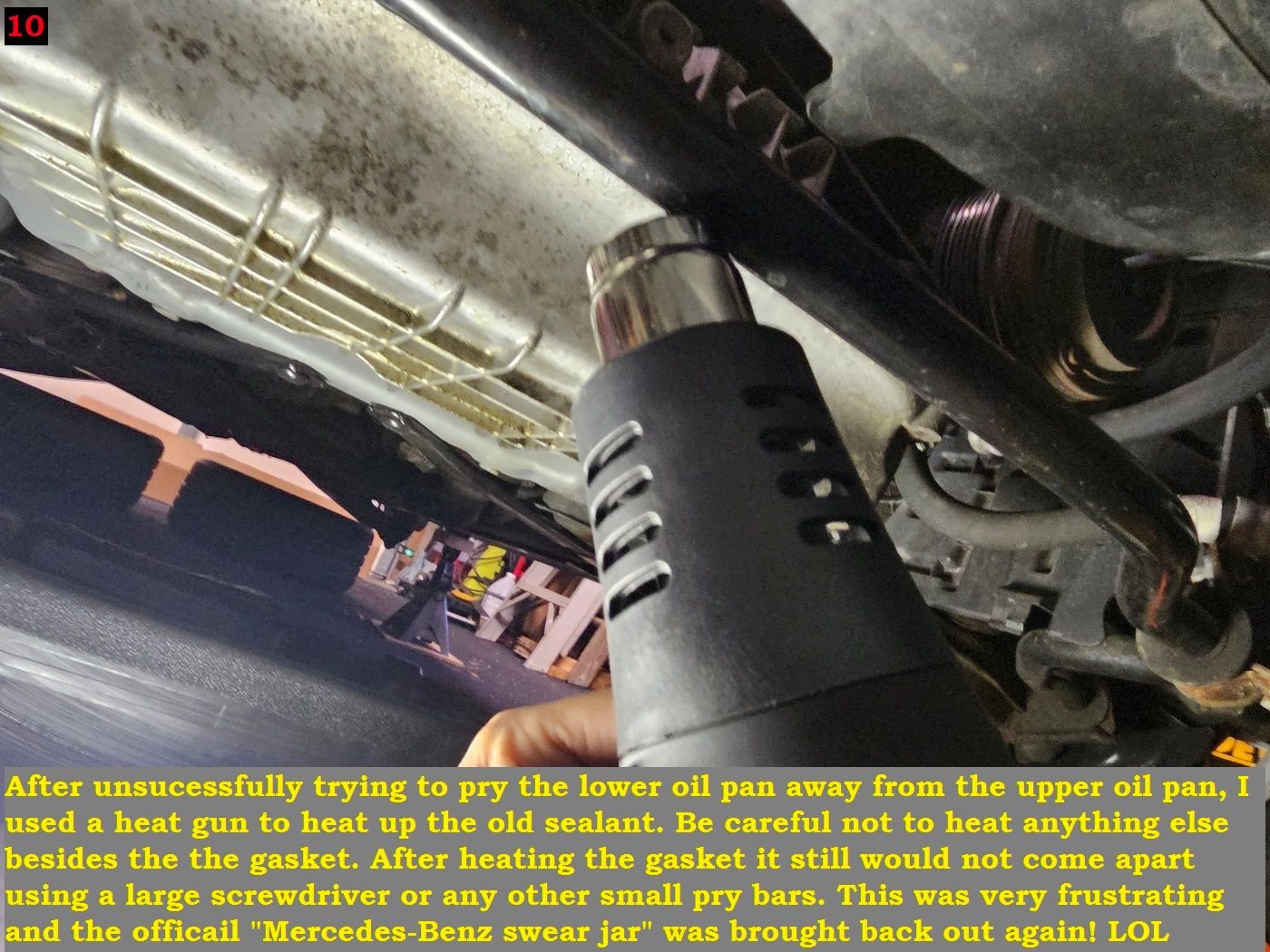

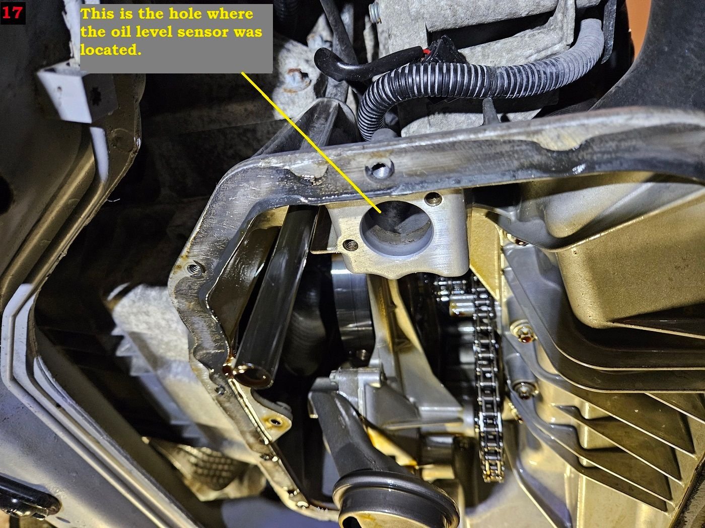

Oil Level Sensor Replacement. PART 1 of 4 (10 picture restriction per post) January 4th - 12th, 2026.
Svengoolie get sensored!
The oil light kept coming lighting up on my dashboard. I checked the oil with the dipstick and all was well. So I crawled under the car, and there was oil on the lower engine cover.
Well, here we are again with another post!
This is how I do the work on my own car. I'm not a professional mechanic. The pictures and descriptions are for reference only. Any work that you do on your car is your responsibility.

Oil Level Sensor Replacement. PART 2 of 4 (10 picture restriction per post) January 4th - 12th, 2026.

Oil Level Sensor Replacement. PART 3 of 4 (10 picture restriction per post) January 4th - 12th, 2026.

Oil Level Sensor Replacement. PART 4 of 4 (10 picture restriction per post) January 4th - 12th, 2026.

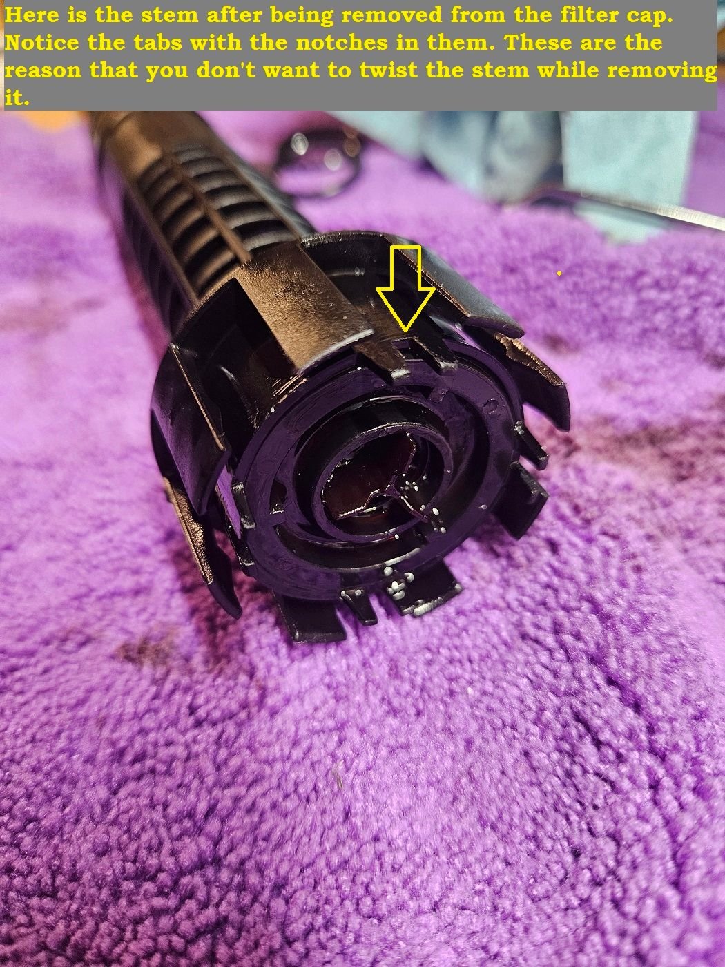

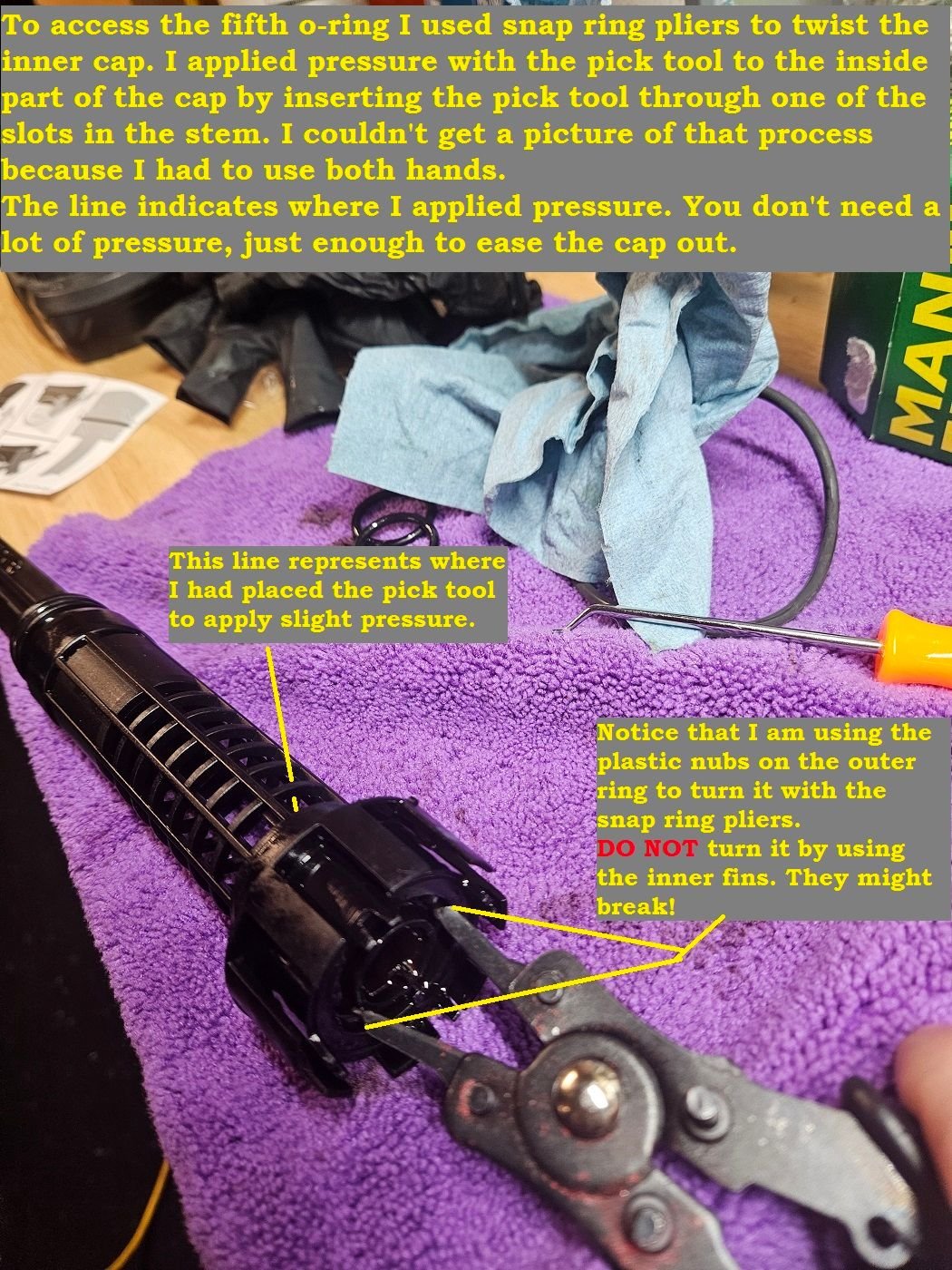

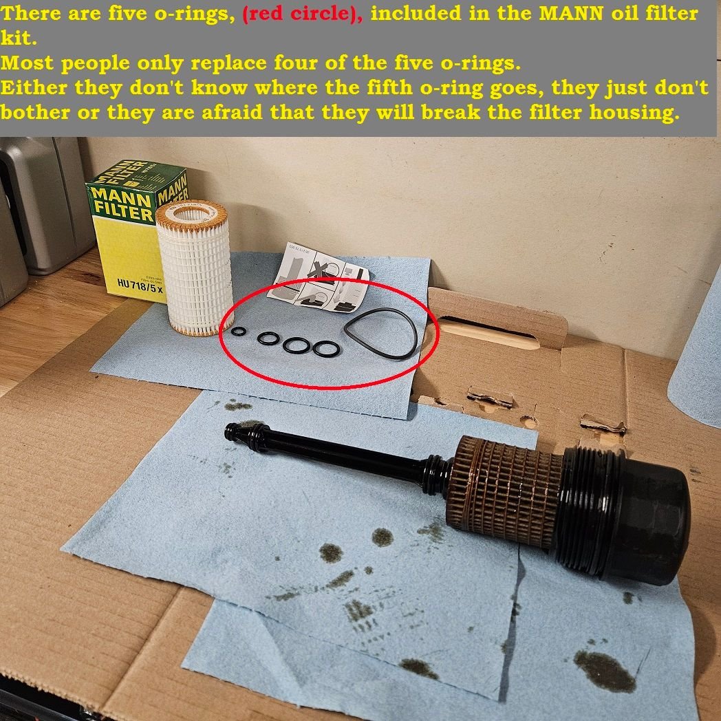

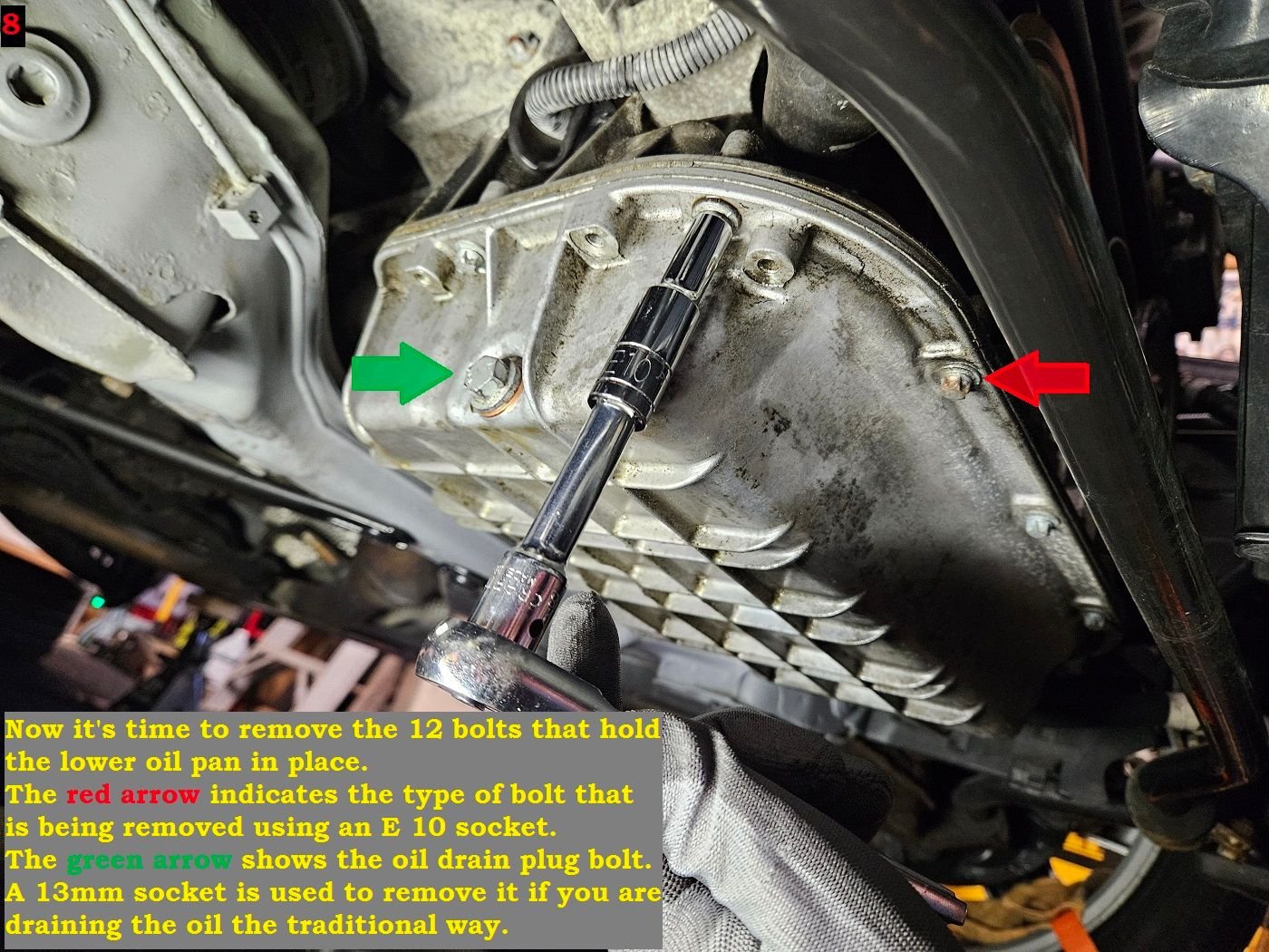

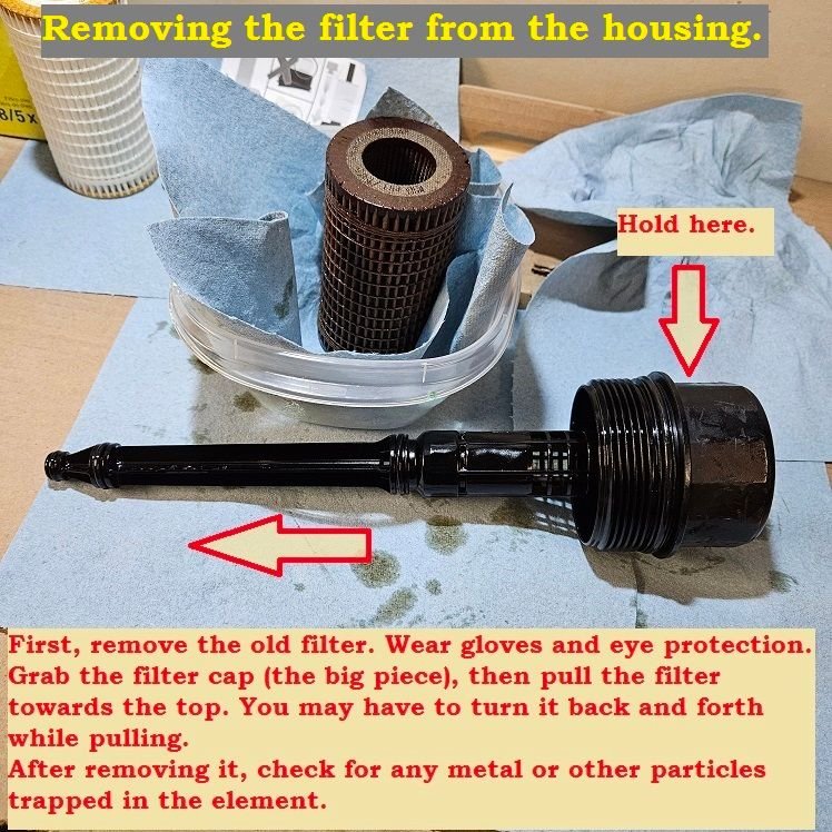

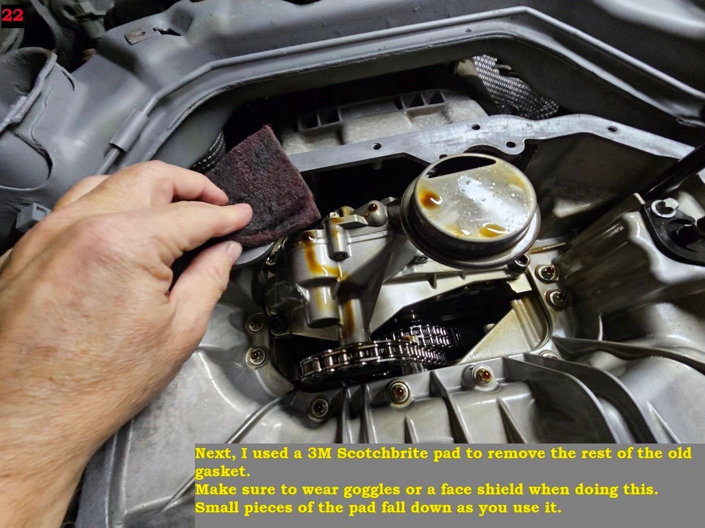

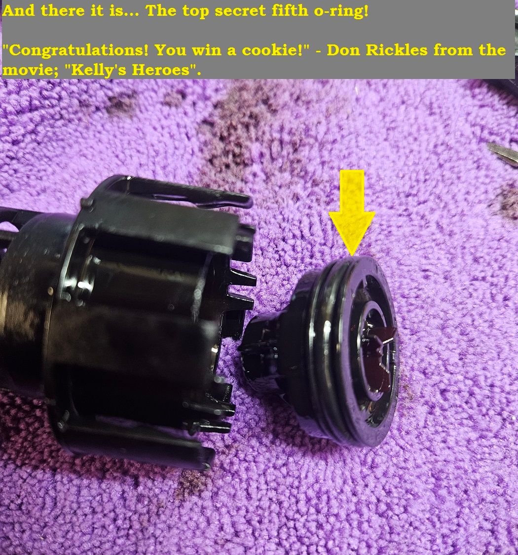

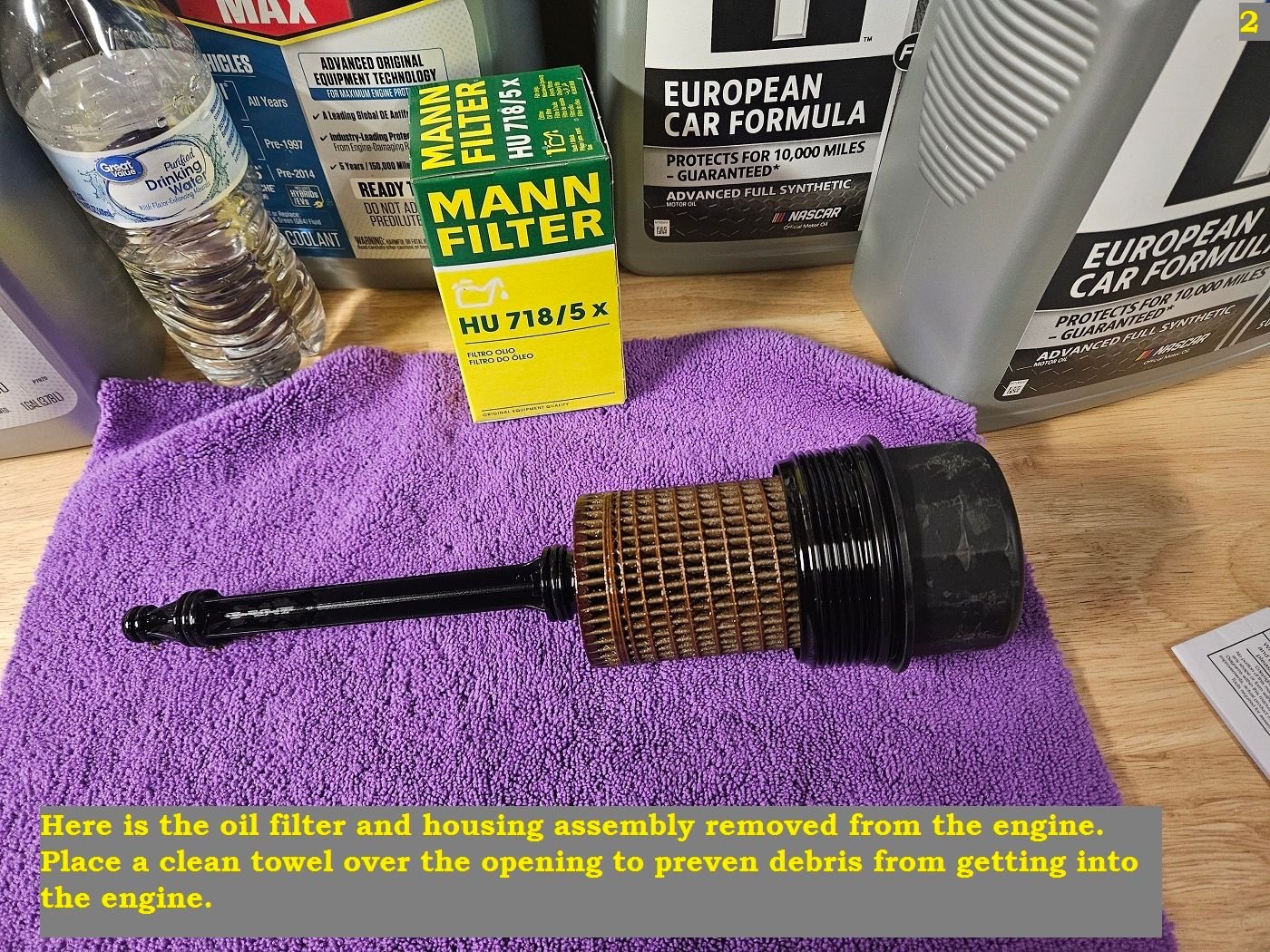

THE FIFTH ELEMENT... I mean O-Ring Post 1 of 2 January 12, 2026
Starring my car "Svengoolie", Bruised ******* and Mimi YoYodawitch.
NOTE: It is not necessary to change the 5th o-ring.
This post was done just to show where and what it was for. It is possible to break the filter housing if it is done incorrectly.
After doing the oil level sensor, I had to add new oil and a new oil filter.
The MANN oil filter kit comes with 5 o-rings.
Usually when people change their oil and filter, there's always that extra 5th o-ring that gets tossed out.
Well, I did a little digging, which led to more pictures, which red to more descriptions, which led to another post!
This is the work that I did on my car. It's for reference only. Any work that you do on your car is your responsibility.
