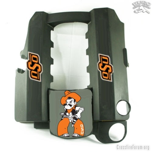

JB WELD.. Sand flush.. CHEVY ORANGE.. good as new!

Well...maybe with a WHITE Crossfire. Maybe.

Nope.. no mabe's .. its a definate!
