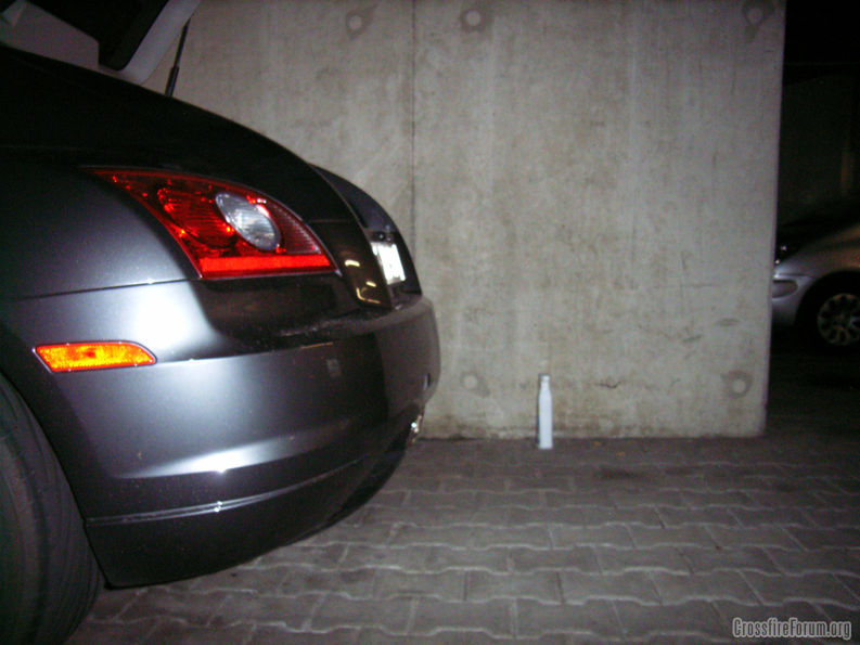

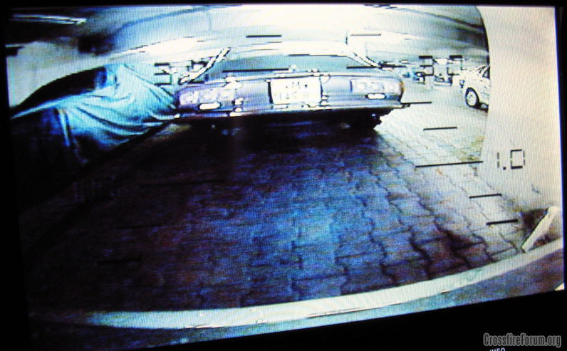

Just to give you an impression. I have a 180° field of view license plate camera installed. The picture on the headunit is a lot better in daylight conditions. These pictures were taken in the parking lot with only very little light.
Notice the little bottle on the passenger side. Thats how far you can see to the side. The car stands only inches away from the wall.
That's very impressive, thank you for the photos.
So I guess as long as I track down a 180* lens I should have no worries of backing out of spots using a plate-mounted camera.
