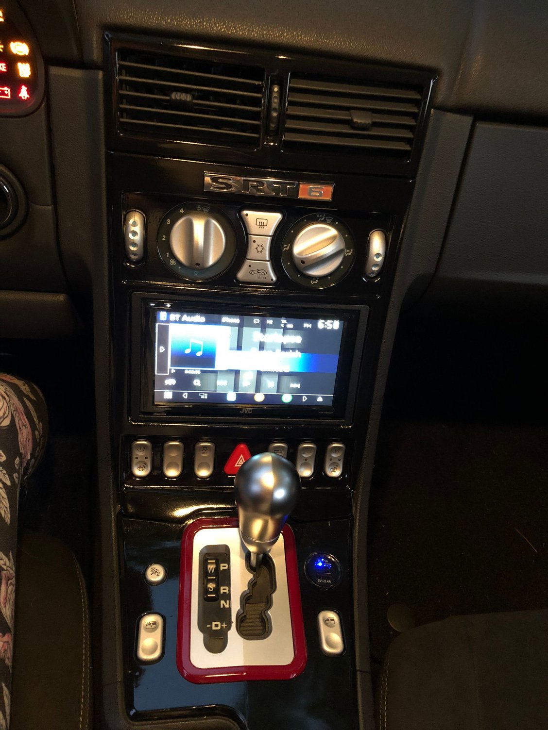

Old Feb 5, 2019 | 04:18 AM
  #58 (permalink)
pschlan's Avatar
Joined: Oct 2018
Posts: 41
Likes: 14
From: Germany
Default Re: Stock Amp is 4 channels!
I did this a couple of days ago. It was super easy to do and the result is amazing. Thanks so much!
(Pioneer SPH-DA130DAB Head Unit)

Old Feb 16, 2019 | 05:35 AM
  #60 (permalink)
pschlan's Avatar
Joined: Oct 2018
Posts: 41
Likes: 14
From: Germany
This is the current state. Still working on the button panel and have to re-paint because of some dents/scratches.
