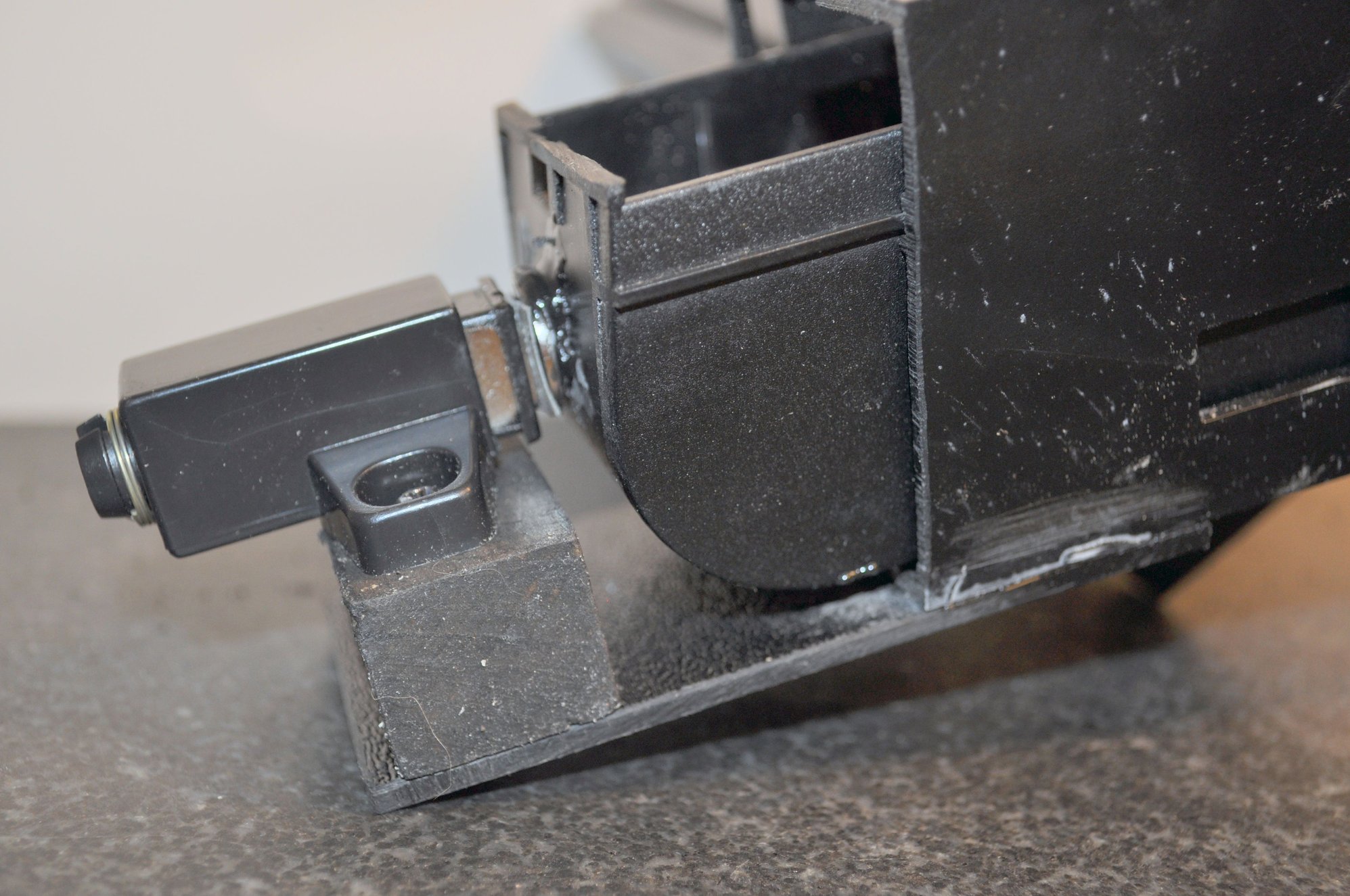

Good idea, remember the back of the ashtray has to be cut off to clear the head unit as they are at different angles, when it is cut off you lose the opening and closing spring and latch - see my photo below. I had to add the magnetic catch, it needs cleaning up but you get the idea.
