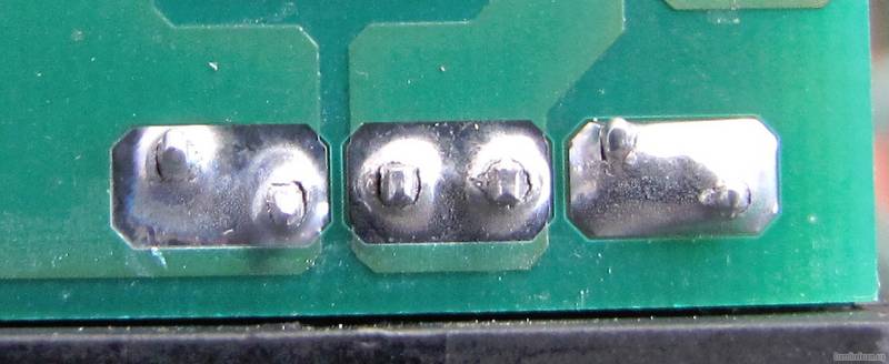

Hey Chuck I think we found the problem!
RCM repaired, Horny mod installed and shipped back.
Enjoy and thanks for the extra beer $$$!!!!
Most generous of you & Missy!
Old Jul 9, 2010 | 08:51 PM
MikeR's Avatar
Posts: 5,180
From: North Plains, OR
Default Re: Help Please Anyone!!!
WOW! Those are REALLLLLLLLLY bad! Good job DJ!
