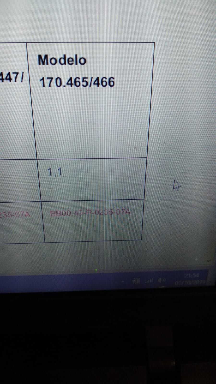

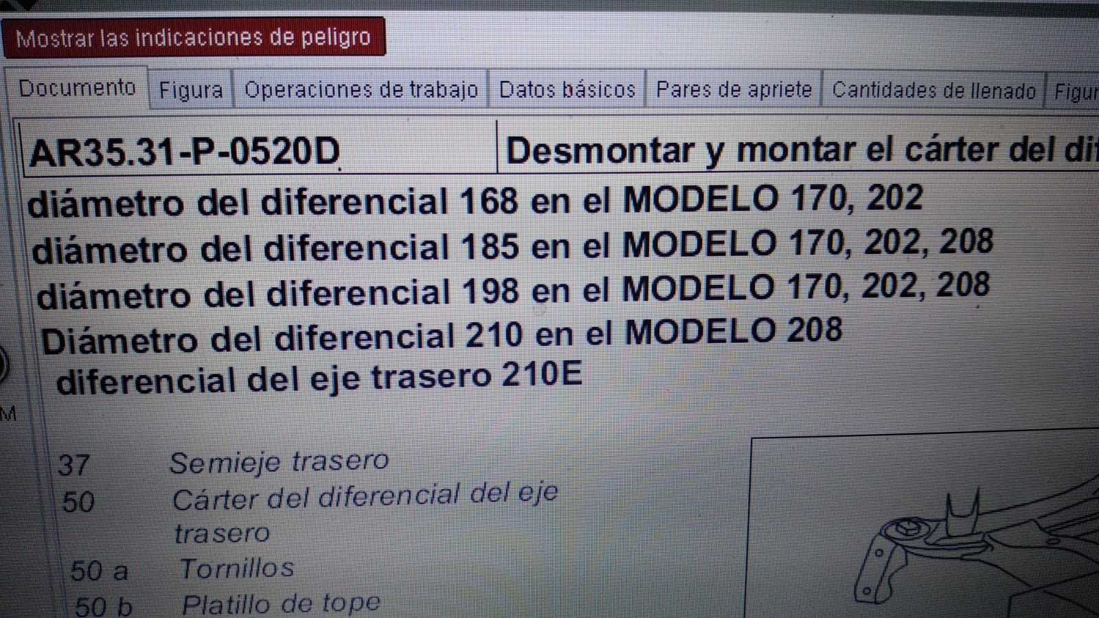

Here I post the pics from the Mercedes Benz official software for SLK320 and similar.
In my case, my manual gearbox, and I am quite sure is for all Crossfire sold in the world, it comes with a ref. in the Gearbox wich is 716.667.
As you can see, for 716.6, the line recommends 75w85, 235.10.
So, for 716.667 Gearbox, the oil is 1.5 Liters of BB00_40-P-0235-10A.
MB 235.10 manual transmission oil A 001 989 84 03Daimler AG, Stuttgart/GermanyGear Oil
MB 317 Exxon Mobil Corporation, Houston, Texas/USAPage Daimler bb00.40-p-0235-10a, Gear oils
Now, let´s see the rear diff:
1.1 LITERS of BB00.40-P-0235-07A
Recommended oils:
Product name Customer, town/country
MB 235.7/ 235.74 FE hypoid gear oil A 001 989 33 03 Daimler AG, Stuttgart/Germany
Fuchs TITAN SINTOPOID FE 75W-85 Fuchs Petrolub AG, Mannheim, Germany
Mobilube FE 75W-85 Exxon Mobil Corporation, Houston, Texas/USA
Mobilube FE Plus NG 75W-85 Exxon Mobil Corporation, Fairfax, Virginia, USA

i cant see clearly what you mean. pics show part of a sheet, not the whole.
but, above all, do you trust a chrysler dealer in spain above the instructions in the manual?
for what i read, at least in north america, chrysler dealers are not trustworthy at all.
