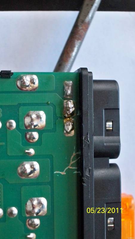

Ok guys let me know what you think....I really hope I did this goodenough.

I think I would double check the top one in the pic. IMO. James

should I try to smooth out the other 2 or good enough ? whats the top one for ?
It holds one of the four feet of the solenoid to the board and it is also one side of the power supply that operates the spool inside the solenoid.
This solenoid is for the air pump.
