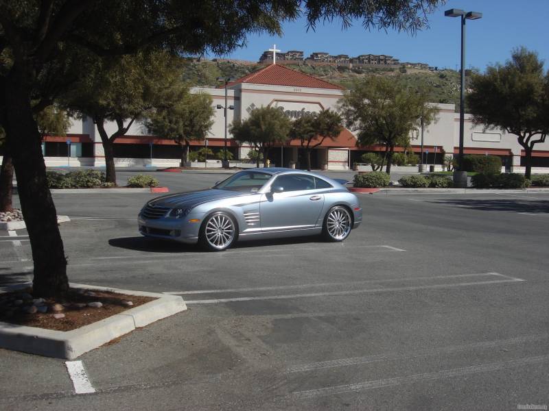

Originally Posted by 05CrossfireCid
i looked up the slk eibach pro kit springs but i only found it where it said lowering from 1'' to 1.5'', i want tha 2'' like ur white one. right now im on h and r springs and its 1'' in the front and 1.3'' in te back but like i said i want 2'', if you could post the exact number or where i could find it i would much appreciate it sir.
~ the eibach numbers are conservative...
additionally, i never made any additional suspension mods after my alignment... yes the rear has negative camber but my tires lasted 25k or so with the lowering springs and koni shocks i later added.
hope this helps.
(they lowered the car approximately 2" ... as seen in pics below) ...

Originally Posted by andrew
Favorite shot ever.
