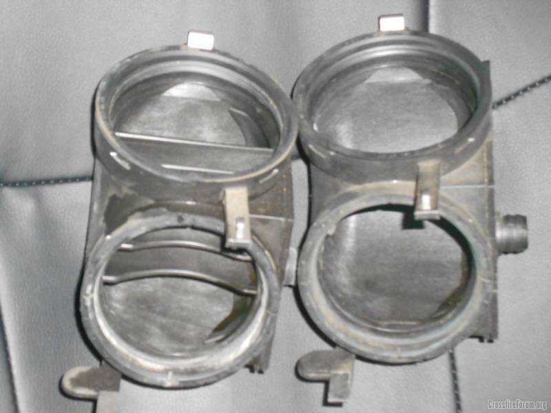

Hey guys, just wondering what the best way to remove the baffles in the MAF elbow is. Any info is appreciated. Thanks

I took pruning sheers to cut out the one side, the other side is slipped into a groove. Then I took sandpaper to smooth out my cuts. IMO though I would have used a dremel if I had one to grind the cuts then sand paper to finish it off. The sanding took forever.

Default Re: MAF Elbow
i did the mod quickly, no time at all.
went to home depot/lowe's and bought a couple of grinding attachments for my cordless drill.
very simple.

Channel locks to break out the plastic, and my dremel with a sanding wheel quickly took care of the job...

Its in the 90 degree elbow right underneath the MAF.

while you are at it....take out the plastic screen.
just leave the metal mesh one.

Found you a pic in the gallery.. one oem.. one cleared out..
