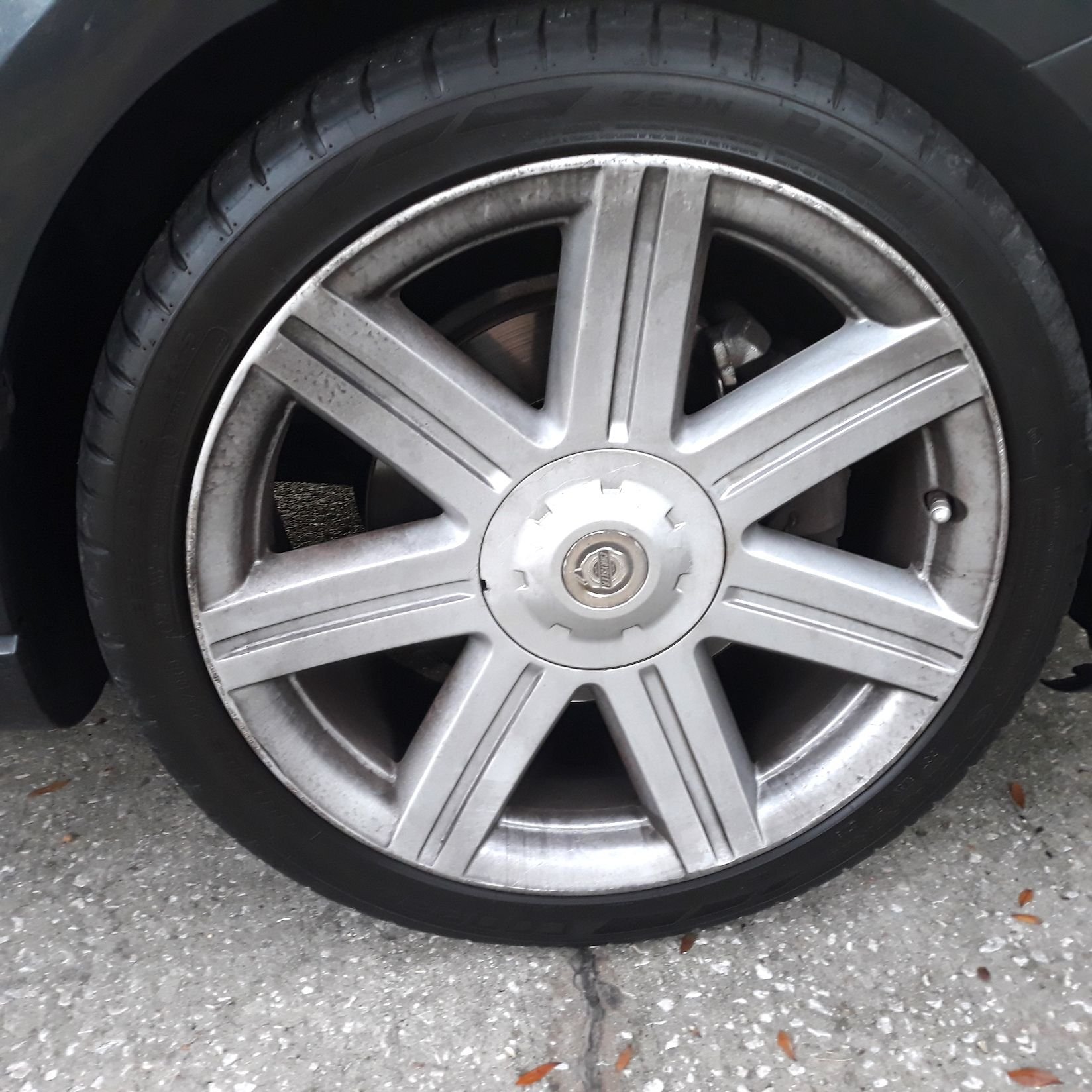

I've got the same problem with squealing! Good point about applying on backside of the pads. My biggest complaint is "sooo much brake dust" on my wheels! I've had my car for about a month now and don't know what disc pads are installed. I'm assuming ceramic. Gonna have to find a rim cleaner that "actually" works.

Ok! I just ordered the Akebono pads, 2 new rotors and Locktite Stick. The disks have 89k miles on them so it's probably cheaper just get new disks instead of having the old ones turned. Guess we'll see how things work out in 2-3 weeks. The picture doesn't really show how bad they really are. Thanks
