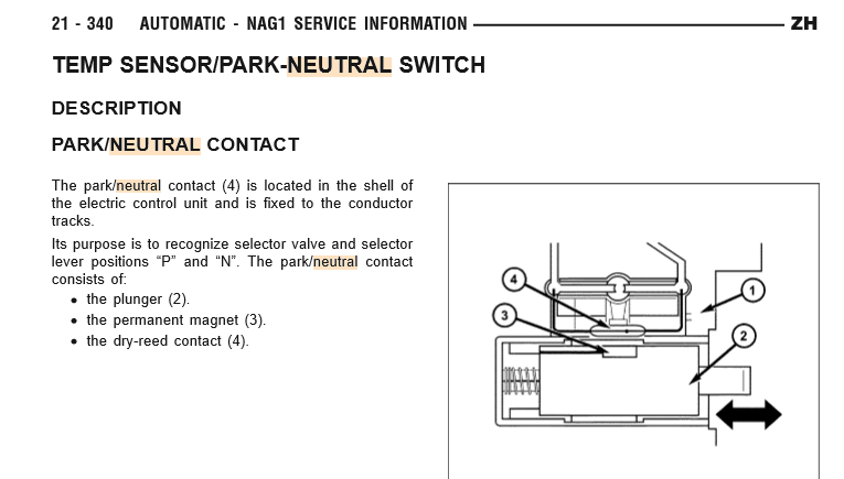

The Neutral/Park switch is part of the solenoid plate in the transmission and to my knowledge does not have a part number in and of itself, but is replaced as part of the entire solenoid plate.

You may be correct, however replacing the solenoid plate in the transmission is not an fun thing. I think you are limited in the info the scan tool is giving you. The tool seems to be a generic OBD II and thus it will not show transmission codes, SRS or A/C codes. To be more certain where/what the problem is I recommend you get the car scanned with a scan tool that can reach into the Mercedes transmission codes. Your best way to do that is either buy a tool yourself (you can get them for under $200), or take the car to an independent repair shop that specializes in European/Mercedes cars. DO NOT GO TO A DEALERSHIP! The scan tool should come up with something like a 2221 or 2333 code either set or in storage. If you take it to a shop be certain to get the exact code number, not just an explanation as to what the mechanic interprets it to be. GET THE NUMBER and his/her opinion. Good Luck

If I remember correctly the neutral safety switch is a part of the gear change mechanism and is not repairable. A new/used gear change mechanism is required.

i believe there are two solenoid switches in the SLA Shift Lever Assembly; The BTSI and the Park Reverse Interlock. The BTSI prevents the shift lever from moving out of Park unless the brake peddle is depressed and the Park Reverse switch/solenoid prevents shifting the lever into park or reverse when the car is moving above 5~6 mph. The park neutral switch is located on the solenoid plate in the transmission. The OP has not mentioned being unable to move the shift lever out of Park.
I think until he gets a better scan (assuming it isn't the RCM, see post post #8) it is just a guess as to what the problem might be. The SLA could certainly be the cause of the problem.
