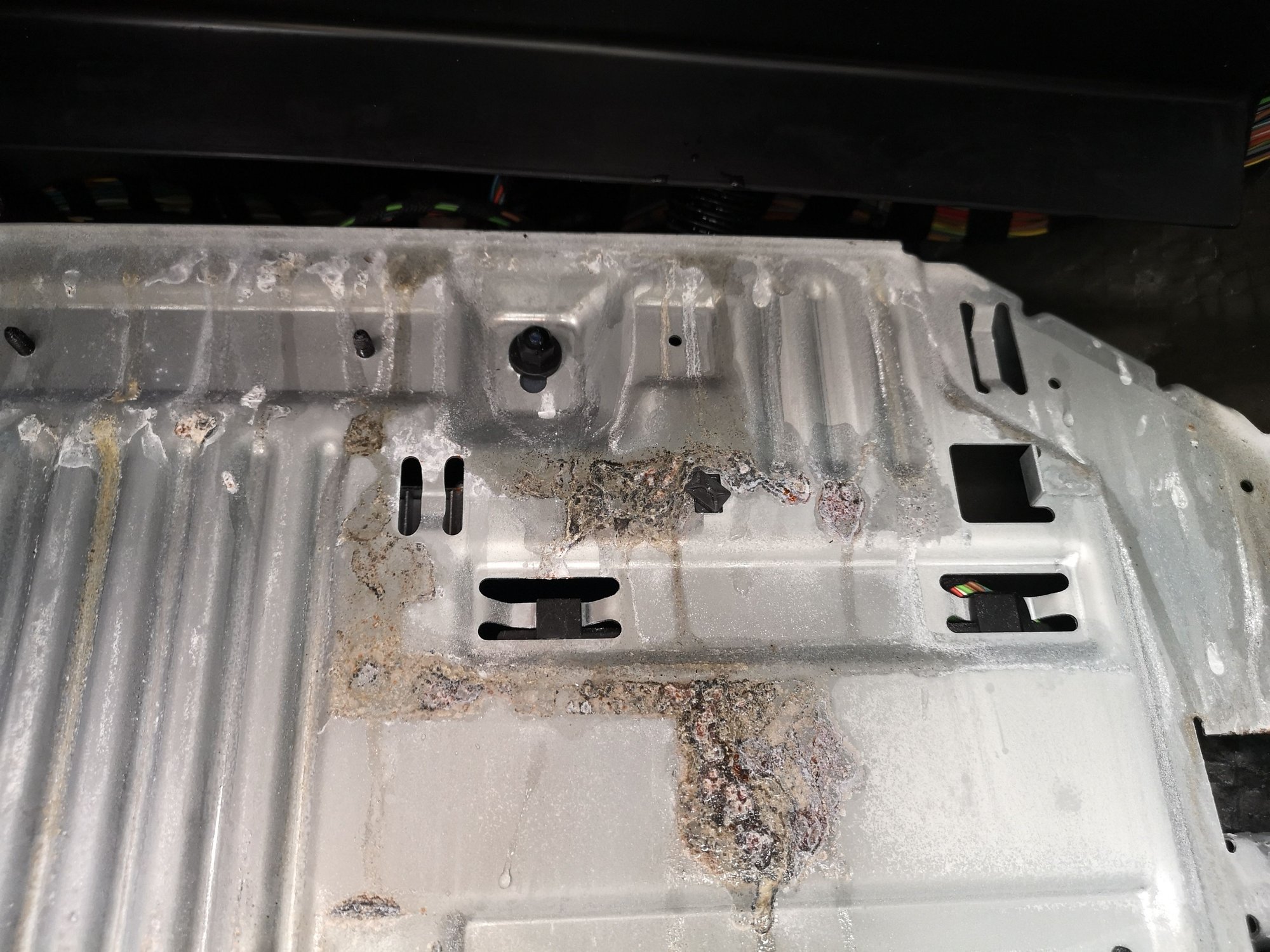

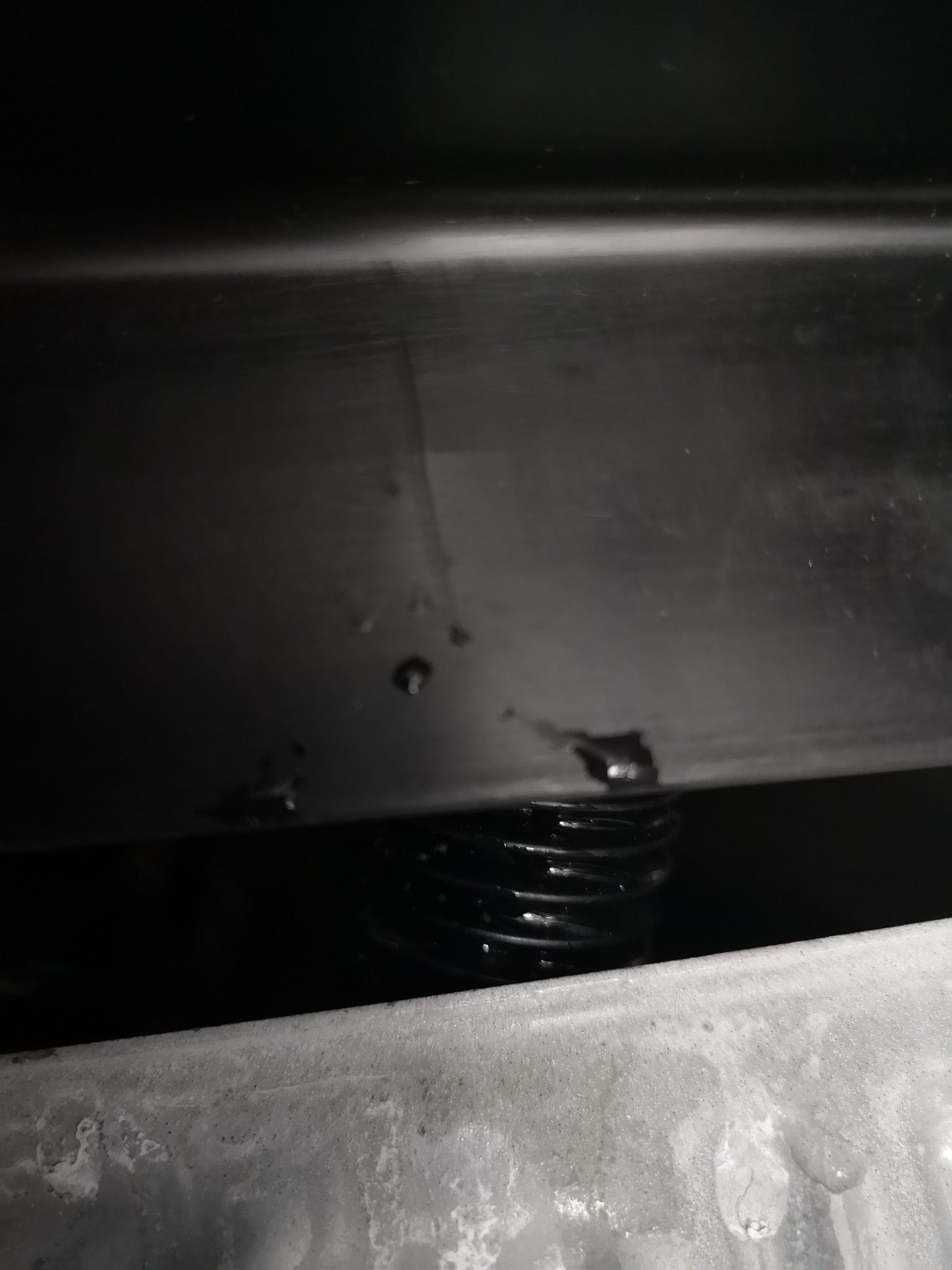

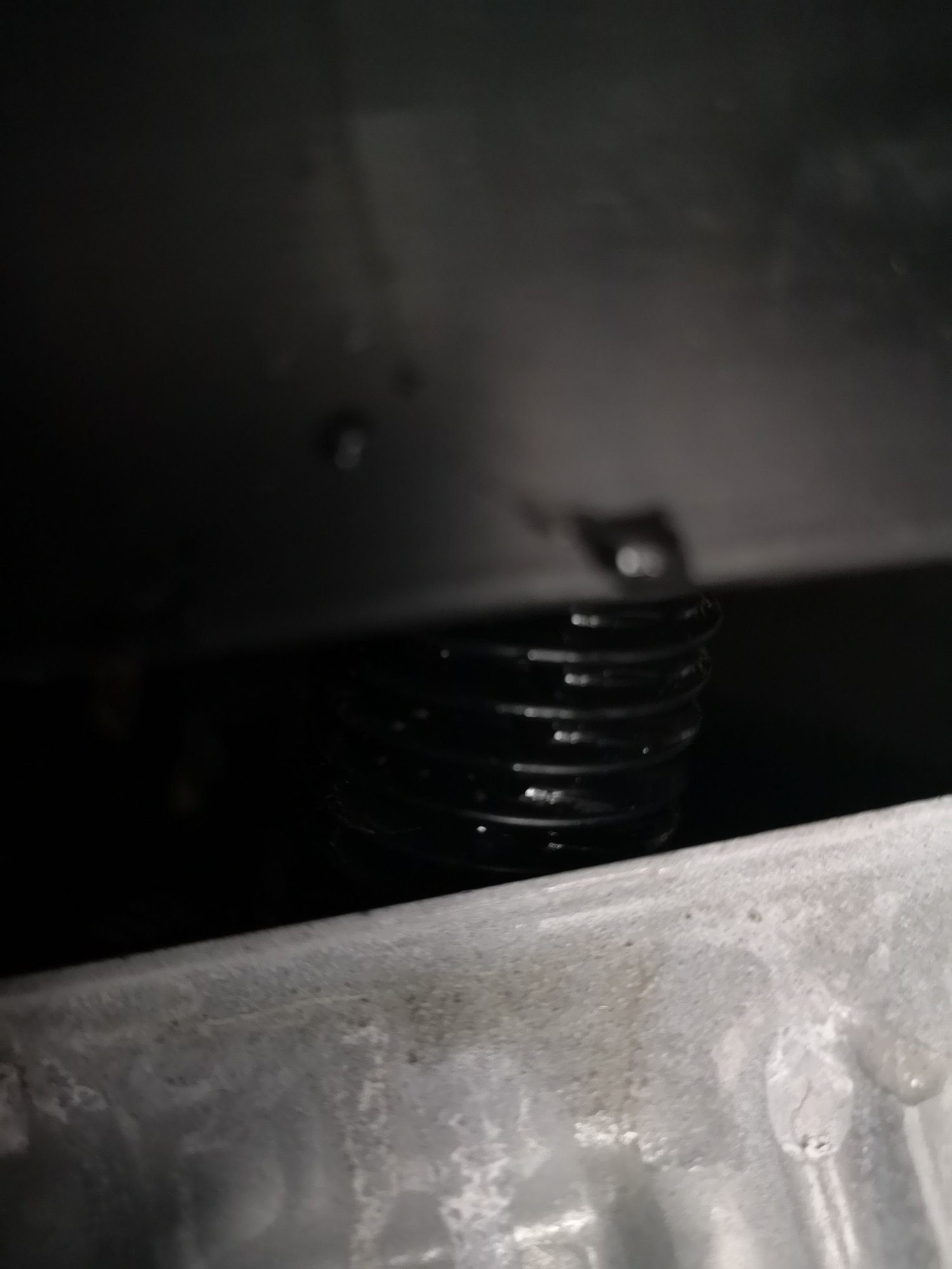

Update: Just pulled carpet out and found this. There seems water running down this black duct pipe. But looking at the cover plate. There seems to have been quite a bit flowing down over it.
See pictures
Old Mar 1, 2020 | 10:11 AM
Likes: 648
Default Re: Water coming in passenger side crossfire coupe
See pictures
The commonest cause for this is a blocked drain under the cowl, and this means water overflows into the air inlet for the heater and AC.
Remove the wiper arms, unplug the wires to the WW nozzles and lift the cowl to inspect all of the drains (4).
Do it before major damage occurs, as it is coming down the hose you may have another problem but the drain inspection should be done anyway.

look at these 3 posts from another thread
Disregard the pics of the alarm module but you can see where to look for debris clogging the drains under this cowel
That is likely what your problem is as well
there are other threads here that describe this ans it is very common
https://www.crossfireforum.org/forum...2-post164.html
https://www.crossfireforum.org/forum...4-post165.html
https://www.crossfireforum.org/forum...6-post166.html
