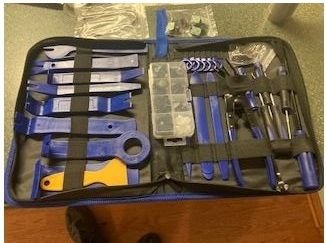

It is easier with a kit like this off Amazon, it has the tools that make taking those "rivet things" out much easier!
To remove the trim, plan on 15-20 minutes to 1/2 hour.
To re-install the trim, plan on 1/2 hour up to maybe an hour.
Take out either side first, then the middle, then the other side.
To put things back, I found it best to put the middle in, then do each side, one at a time.
You will want to have a kit of spare "rivets" of all sizes in hand before you start - you will find that some are useless after being pulled out, they deform and won't hold well (the four in the top of the middle section are probably the ones you will replace, I had to, on the two cars I worked on).

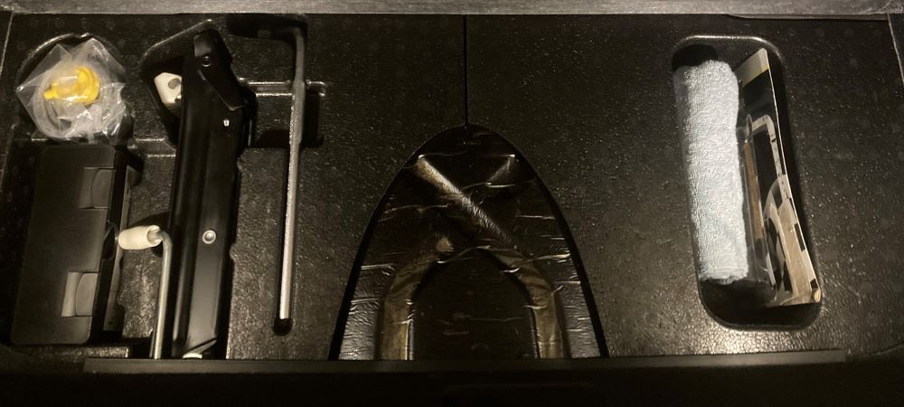

Here is the trunk layout for jack, compressor , tire tool , tire seal and storage area for tools or whatever
This is for a roadster, Coupe maybe the same
