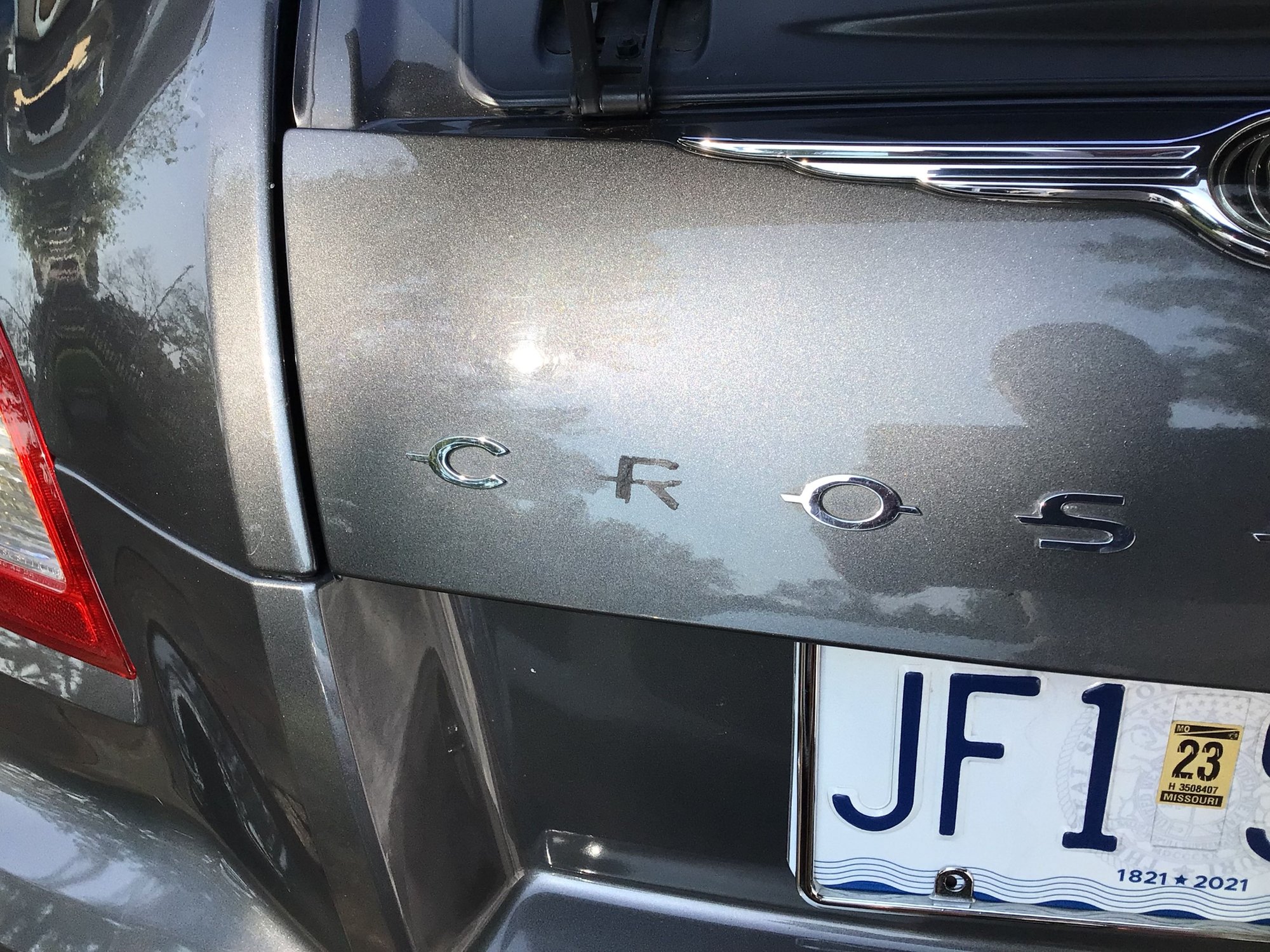

My “R” was like a loose tooth ready to fall out so I removed it before loosing it. My question is what is recommended for putting it back on to OEM standards?
Old Sep 11, 2021 | 11:12 PM
Default Re: Removing CROSSFIRE emblem??? Chime in!
3M tape
