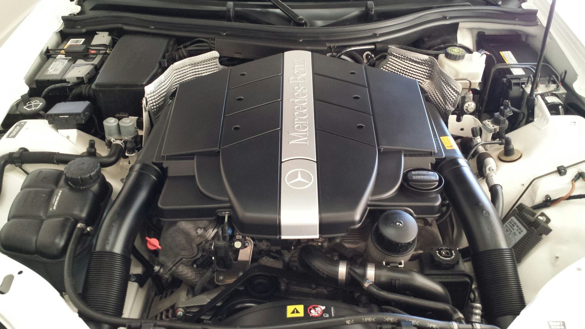

Kamilspider, If you are using the MB PN 1120900501 air cleaner on a stock NA XF. The OEM inlet tubes fit the air cleaner. The only time there would be a problem is if you do the throttle body mod then you would not be using this air cleaner. This air cleaner is a perfect fit.
Please explain why this would be not suitable.
Edit
OK, I got the numbers mixed up, the 112 090 05 01 is the one for the SLK320 and will fit with the OEM inlet tubes. It is a one piece air box.
Kamilspider was talking about 112 090 11 01, it is a two piece air box I believe,
I do not think it will fit because it is too thick and it rubs on the hood liner. The tubes might fit inside the inlets on the air box.
I think I took two of these boxes complete with the nose pieces to the town dump because vendors kept sending the wrong part, they thought as they looked alike they were the correct part, the parts they sent were too thick and the wrong part number. I had all these parts lying around as they said to keep the wrong part and they would send the correct part, but again I got the wrong part. I kept at it until they sent the correct part. Different vendors were supplying the nose and main body.
The 112 090 10 01 will fit and needs larger inlet tubes but the OEM Crossfire ones will fit inside rather than outside the air box inlets. It too is a two piece air box.
Even the OEM air box rubs on the hood liner slightly, so thicker really rubs hard.

At the moment I not have plans for make throttle body mod. I have only 1 month this car and power for me is still enough
Hood cover without pipes A 112 090 11 01 are ordered. I let you know.

Tuning done
Now I have Mercedes cover and Crossfire pipes.
onehundred80 larger new pipes from Mercedes normaly fit to Crossfire bumper?
Merc cover have larger air filters and pipes. I think about K&N or Simota. What is better?

If you have Crossfire pipes why are they inside the cover?
This is my 1120900501 MB cover with the original Crossfire pipes fitted over the cover just
like on the Crossfire cover. Your photo of the original cover has the pipes fitted over the
cover openings. Has someone modified the intake pipes?

I have A112 090 11 01.
Look at photo, my cover is little bigger, air filters are bigger and pipes also must be bigger I change this pipes for custom tomorrow.
Your car have only 7 450 miles, wow, I'm envy My car have 90 000 miles on car counter.
OK. understand now. Two different MB covers.
I was under the impression that we had the same one.
If I remember correctly there are threads on here that talk about the larger pipes.
You may have to modify the new pipes a little to get them through the radiator firewall.
Best of luck with your project. Enjoy the car!

Kamilspider, tried to tell you to buy the A 112 090 05 01 that is a perfect fit for the NA XF. You now have an air cleaner that doesn't fit your throttle body.
Old Aug 25, 2016 | 02:56 AM
kamilspider's Avatar
Joined: Aug 2016
Posts: 141
From: PL
Default Re: Under da hood
Red Runner my cover fit very good to throtle body.
Everything works ok and mod is finish
Maybe now we have extra 1-3 KM more
That is not true, the cover fits the MAF housing and it fits the OEM one or the 74mm one no problem. The part number you give is the SLK320 housing and if you are going to change the TB and MAF housing some time the cover he has is the correct one.

Everybody who have engine cover mod from Mercedes (bigger cover, especially A112 090 11 01) should check fuel line becouse new cover touch fuel line and after long time can damge it (this is big risk of fire).
