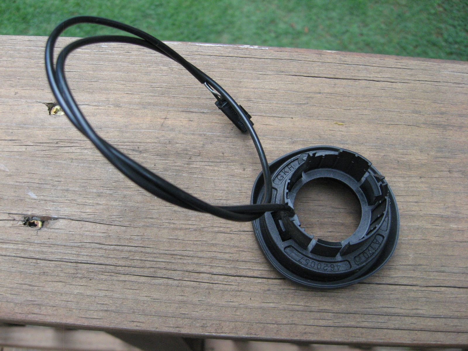

Old Aug 3, 2016 | 02:29 PM
maznonno's Avatar
Joined: May 2009
Posts: 141
Default Re: 2005 inter 2005 limited roadster
is this what your looking for??
is it not what I posted pizzaguy?????
Old Aug 4, 2016 | 10:19 AM
Posts: 13,974
Likes: 1,297
It is, I think it IS what you posted. I thought you were just posting a photo to try to help, if you are willing to sell that item, then his search is over.

Old Aug 4, 2016 | 12:14 PM
Likes: 650
I've never heard of someone needing one, WHICH MEANS that every crossfire in every junk yard has it's still intact.
Should be easy to find on "pick-a-part".
I'm impressed that someone found a part number....
The part number is available in the Crossfire parts catalog on this forum.
If you look at the picture of the back of the halo ring posted here you can read the Mercedes part number A170 462 00 57, this is the plastic cap number.
From the parts list for the SLK32/320 on this site the transponder coil part number is A168 462 02 53, that is the part with the wire and plug on it.
Remember most parts have the Mercedes part number on them and not the Chrysler part number for which you will pay a premium. Always remember that fact.
