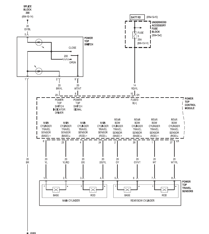

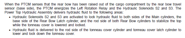

Old Apr 27, 2018 | 04:08 PM
Default Re: Yes, another convertible top question.
The manual says :
then :
Its says nothing about the bow only traveling half way, I'm thinking it's a problem with the proportioning valve in the pump assembly, or the rear bow travel sensor
Old Apr 27, 2018 | 04:36 PM
Z51's Avatar
Z51
Joined: Nov 2017
Posts: 25
From: RI
Can the sensor be jumped for test purposes? If so, is it a direct jump or does it need to see a certain amount of resistance? On my truck the remote start stopped working because the hood latch sensor failed. Can't just jump it. Had to put in a 1000 ohm-1/4 watt resistor to trick computer...
Old Apr 27, 2018 | 04:41 PM
I'm pretty sure they are Hall-effect sensors, not sure you can jump them :
