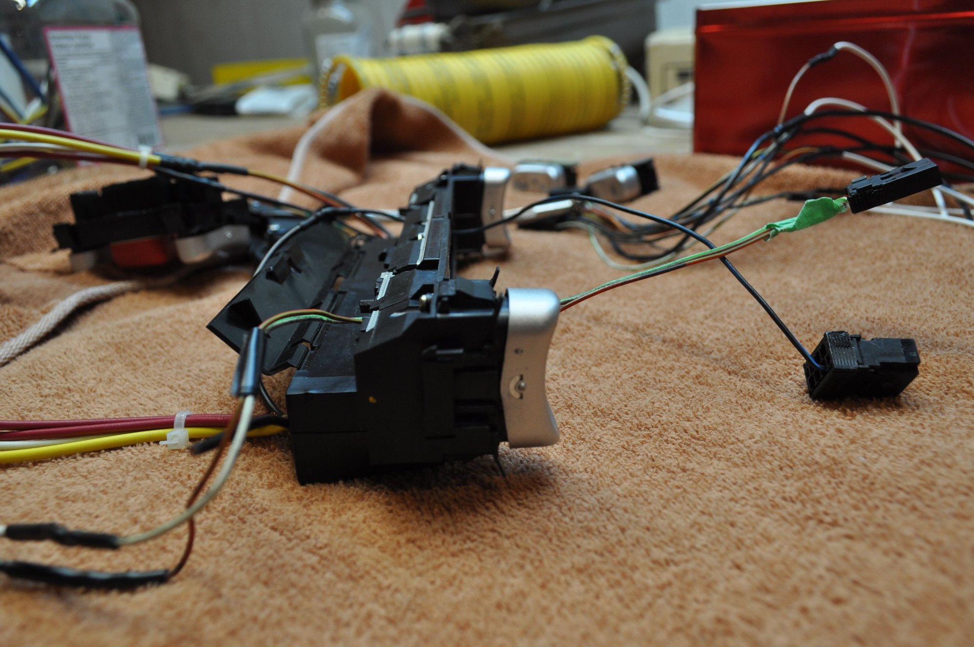

I am in the process of moving all my switches from one bezel to another, this is the third time I have removed these switches, do not forget the plugs as they have to be removed to get just the bezel in your hand. These parts were designed to be put together easily not to be taken apart easily.
The seat heater module is held in with 4 latches two at each end, my photo shows two of these latches just under the silver rocker switch, they have to be pushed in while clearing the undercuts at that end.
The emergency red button and two other switches are in a module that comes out the same way, the remaining two buttons are similarly held in. The photo shows the four latches on the emergency module.

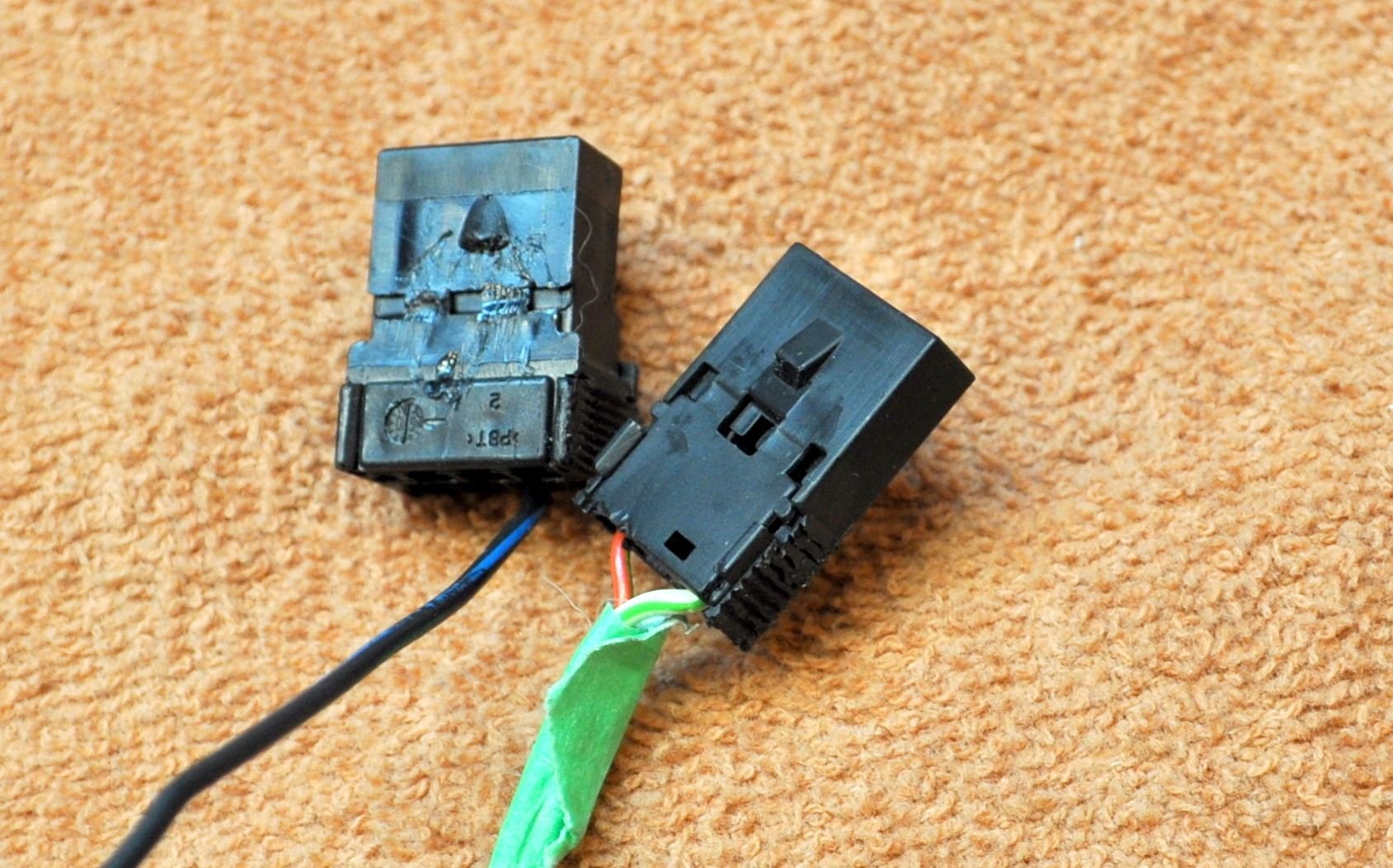

Take out the large wire connector, this is held in by two small bumps on its side which snap into holes in the side of the socket, spring the side of the socket and pull on the plug and not the wires.
A photo shows two smaller plugs and the bumps on them, these plugs are removed the same way.
