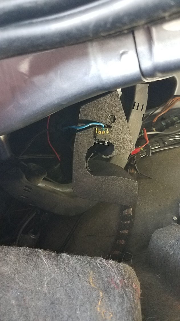

This is the picture of a broken bracket.

Originally Posted by Reliableron
May be interested in a couple if the price is right!
What plastic is the OEM part made from? I suspect it is a fibre reinforced engineering plastic. Why can it not be repaired?
The repair may not look good but it may be stronger than a printed part which has defined weaknesses between each layer. The original part is a strong homogenous plastic part and still breaks.
I would not want to make a part, sell it and then find it is weaker than a properly repaired part.
Just my 2 cents.
Just my 2 cents.
Agreed
I repaired one initially with JB Weld but that had a short shelf life
the second repair was with carbon fibre and resin.
all good for over a year
a lot less than $100

Originally Posted by UrbanE
Agreed
That just shows it can be done, I have not seen one up close but it should be repairable quite simply.

Originally Posted by amx1397
Has anyone tried a repair with Q bond I repaired a door handle on my c320 and it is still holding after pulling on it for almost a year.. also used it on the overhead light inside the car two years ago ( the clips that hold the light up)
and used it on a cofee cup handle of my wife's favorite coffee cup still holding on.
That is what I used for the first repair
it held for a while. In order to get it to hold, you have to fill every bracket cavity with Q bond
the bracket is held in place by 2 nuts and the divider going into and back out of the bracket are too much for the Q Bond
that was my experience.
my bracket was cracked in Half
