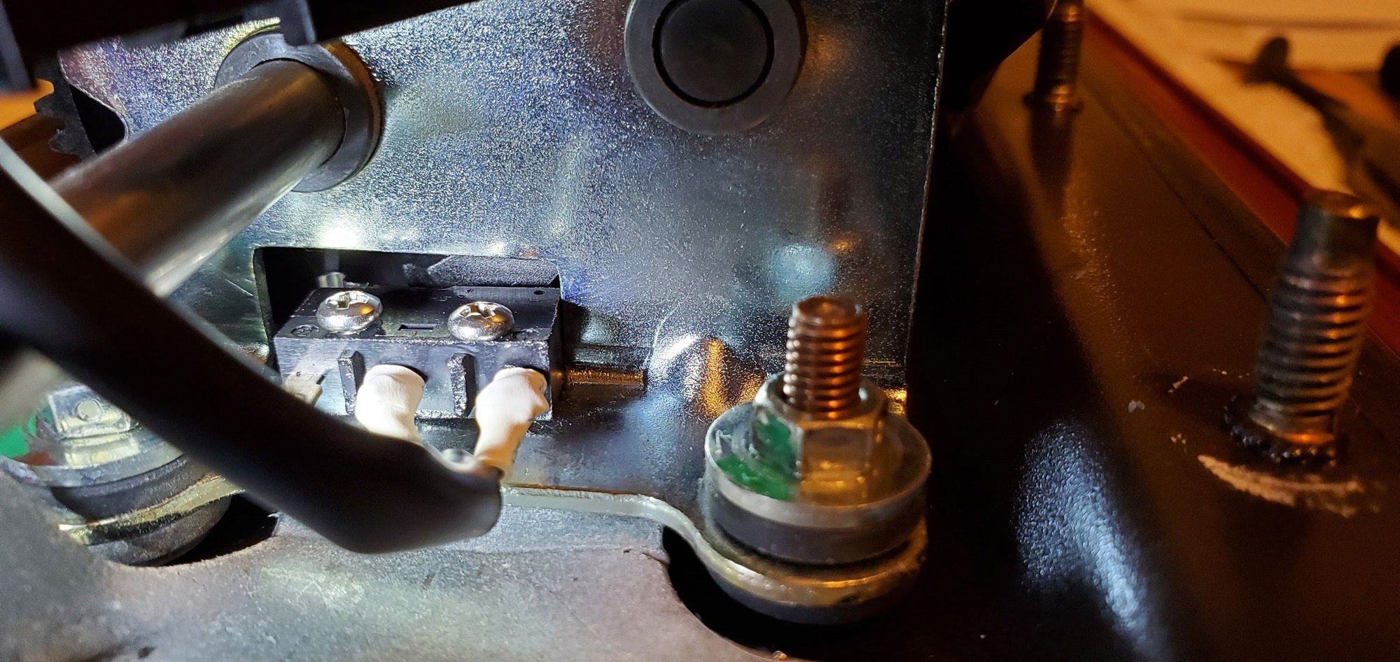

Using the forum troubleshooting information, a lot of it from pizzaguy (thank you), i was able to determine my problem was likely the spoiler closed limit switch. What an easy fix I thought until I realized the OEM switch was no longer available. So I went shopping for a similar switch that might work. I found an Omron Snap switch D2S-01L13-AQ that is close and after installing it is working fine. The holes in the Omron switch are at the same CL as the pins on the factory switch and using two 3-48 - 1/2 in screws as guide pins I was able secure the switch with a little glue to the bracket.(you could put washer & nuts on screws but would need to remove the bracket). It did take a little sanding of the one end of the switch to fit in the bracket.

The spoiler lowering switch is located on the underside of the trunk lid being pointed at with the screwdriver in the image below.
To determine if this switch is your problem remove the brown wire connector and use a jumper wire, as shown in photo to simulate a closed circuit across the connector. See photo with jumper wire below. With jumper wire in place the BCM now sees a closed switch signal and believes the spoiler is in the lowered position and it is ok to lower the top. Turn on your car and unlatch the roof D ring. As you do this you should see the windows go down and top should work. If the window do not move you have some other problem. This sub minature switch is subject to a lot of contact wear because it is closed all the time you are driving and the spoiler is down. I purchased the switch from JAMECO but as others have pointed out there are additional sources.

Switch is located under trunk lid (black cover removed). Screwdriver in image below pointing to location
You can use a jumper wire as shown below to make the BCM think the spoiler closed/down switch is closed (spoiler is in lowered position). With this jumper in place turn on your car and use the D ring on the top to open it. If this switch is your issue the windows will automatically lower when you twist the d-ring and pop up the top. The BCM logic will not let the top lower if it is not seeing a switch closed signal from spoiler down limit switch and the trunk closed limit switch.
