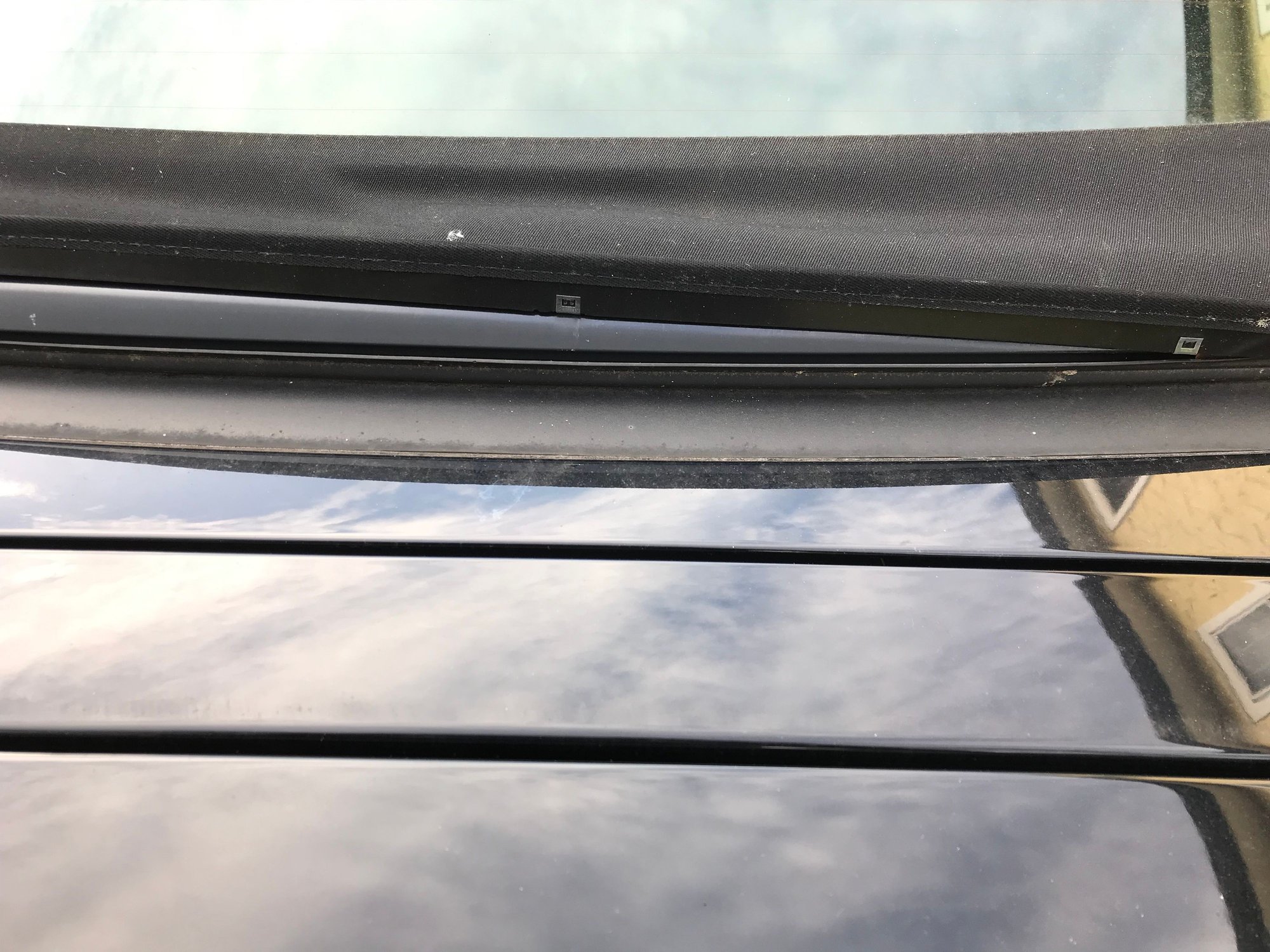

3. Most importantly, the rear of the convertible top seems to be separating from the body. Is there a repair for this or does the top need to be replaced entirely? See this picture:

3. Looks to me like someone replaced the top already and did not do a very good job, I suspect they neglected to use or seat the clips in back properly.

I find it odd that the top did that on it's own. I've been here since 2009, owned three roadsters, am a member of MANY Facebook Crossfire pages, I go to many driving/social events held by our community -and yet, I have NEVER heard of the top doing that all on it's own. After someone replaces one, yea, if you dont get the clips in properly, it can do that (as the side seals can pop out unless you REALLY set them in right).
Are you SURE no one had tried to work on or 'fix' an issue with the top? This is a new one for sure.

Yes, I'm certain that no one has touched the top---there was never a need to. I'm the only person who drives the car and I put the top up and down frequently (down when I'm driving, up after I park). I will say that this summer, occasionally the top wouldn't go down. I did the usual resetting of the trunk shelf and that always solved the problem. The only other thing I'll mention is that the car used to be garaged but two years ago, I had to leave it outside. I don't know if any of this is relevant but I figured that more information is better?

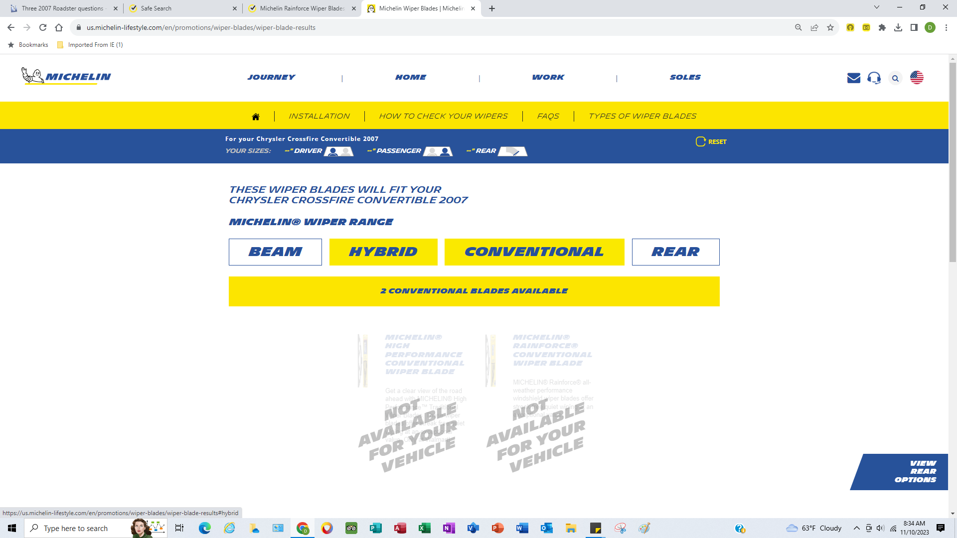

The only thing I can think of is are the 2 wiper blades you bought at Costco the same design? There are multiple mounting designs available due to differences with manufacturers. Here's the link of the 20" Michelin wiper blade I get from Amazon:
CLICK"><span style=CLICK" /> CLICK">CLICK
Kinda interesting - when I went to the Michelin Automotive website & searched for Crossfire Wiper Blades, their website doesn't list any! And I know the above blade will work on the Crossfire!

Do a search online for replacing the Crossfire convertible top and there are instructions that show you the clips and how to get to them.
