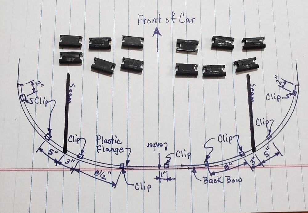

Does anyone have the link for the diagram that shows spacing and placement of clips that connect top to rear bow weatherstrip? I was going through posts and saw it but didnt bookmark the link, I have not been able to find it again. It was a nice drawing/diagram with the specs for placement.
I'm trying to get enough info to do the install myself.
The body shops are ridiculous with what they want to charge for this job.
Thank you for your good help.

I didn't find a diagram, but if you got 10:54 in the video, it shows the spacing of the 9 clips.

Here ya go. This should be it

JSK
That is it.
Great info.
Thank you!!!!

You’re welcome. I can’t take any credit at all for it, I just downloaded when it was first posted.
