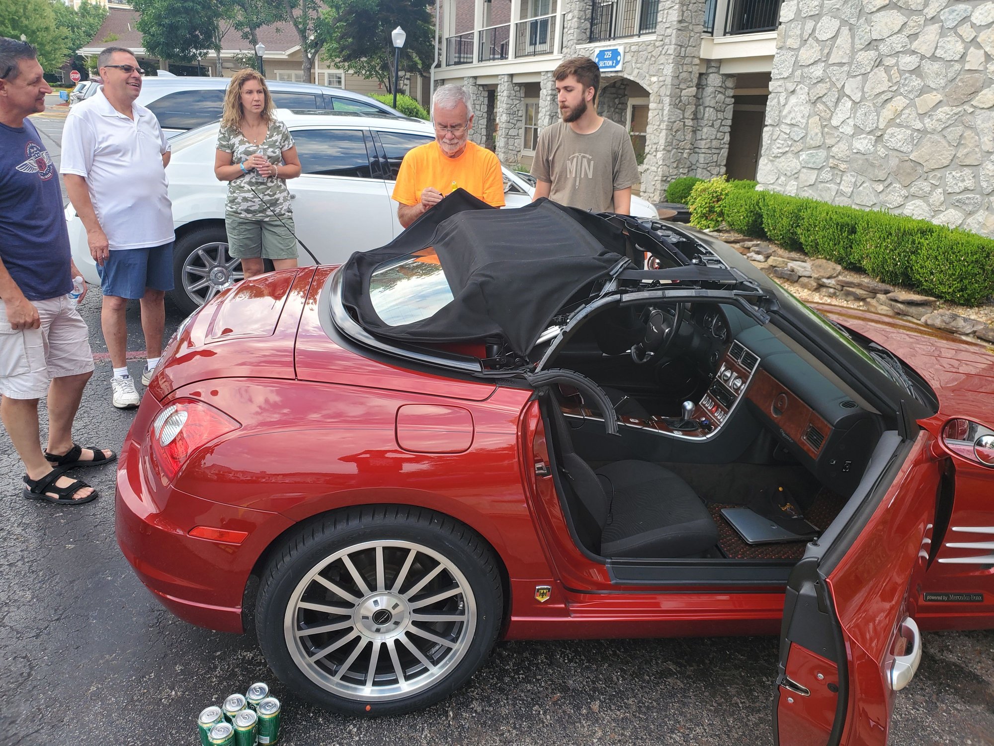

Mine was replaced in a parking lot one morning before breakfast by attendees at our Eureka Springs meet.

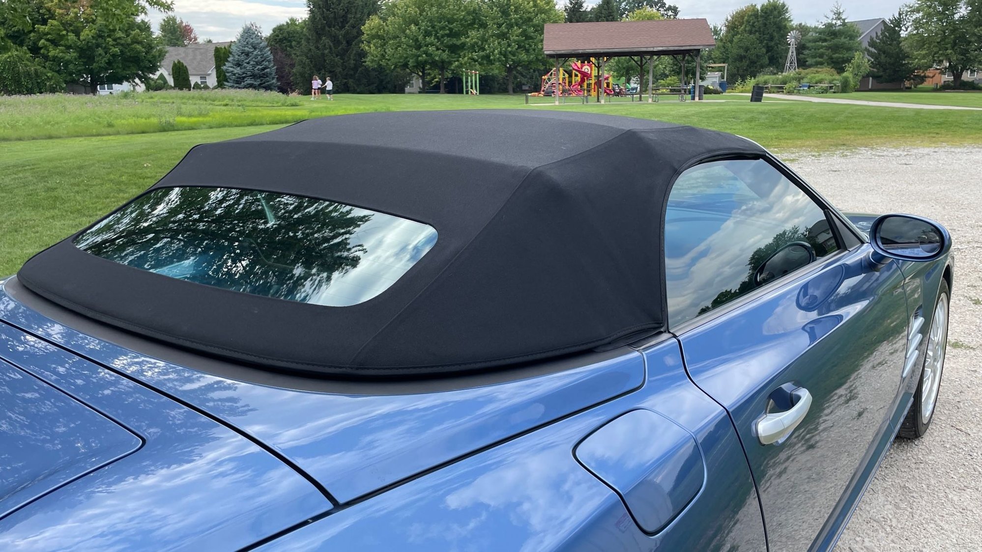

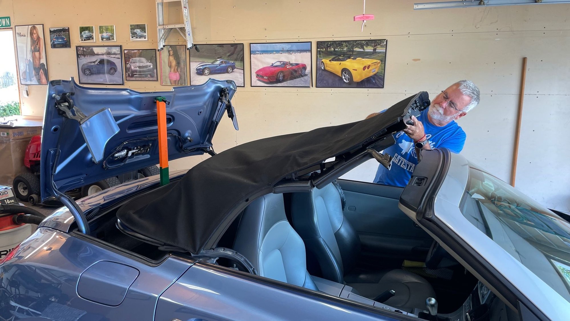

Just replace it....I did a year ago with a new BAS top
https://www.car-hood.co.uk/crossfire
Send an email to:
Becca@bas-international.com
BAS tops have glass glued in with the defroster inside the glass exactly like the OEM top
Very good quality and I doubt you will find anything even close in price anywhere else
I have a BAS top and many others here I know do as well
I highly recommend them and they have been a major provider for the Crossfire owners here for 8 years or more
