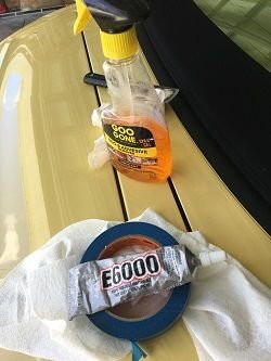

I think that if you want to go to the trouble of removing the top to repair it, a heat-sealed adhesive would be a good way to go. I think that I will be able to do a reasonable job without removing the top. With the top latched in place there is enough tension to hold the two pieces of fabric together. Now I am trying to figure out how to clamp them tight while the adhesive dries.
Does anyone know the difference between the various "Amazing Goop" and E6000 products?

There are several E6000 products. I had to go to the kitchen to look. I keep a tube in there for t-shoe repair , works great on that. I don't know what "I" would trust on my top ((coupe owner) , especially if its going to be outside in any kind of winter weather. Seems like the 3M product has faired pretty well , for several owners. Good luck with your decision.

If I had those magnets handy, I would have used them. I think that need to buy some, just to have them for future projects. As it turned out, I didn't need them. I applied the adhesive with the top up and latched, and there is plenty of tension holding the two pieces of cloth together. It's curing now, and I don't plan to touch it for 72 hours.

E6000 craft adhesive and Goo Gone
3M Edge Lock masking tape
Progress:
