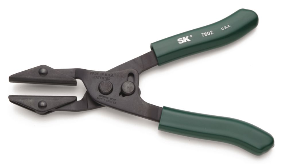

Can you post a picture of the "light-pressure plastic clamps" that you used to stop the coolant flow?
Old Mar 1, 2007 | 07:17 PM
  #60 (permalink)
Rydiak's Avatar
Posts: 192
From: Prospect Heights
Default Re: Sometimes Sluggish acceleration
I can do better than that. Here is what we used: http://www.sears.com/sr/javasr/produ...seBVCookie=Yes
